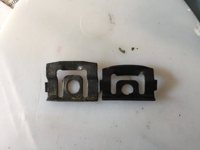

    Also, change out your molding clips. Buy replacements from Roseville. Other vendors sell clips that are shorter then stock, so be aware. (Originals on left)

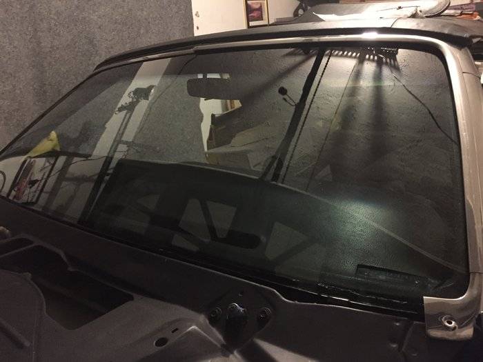

    Old school, but it works
