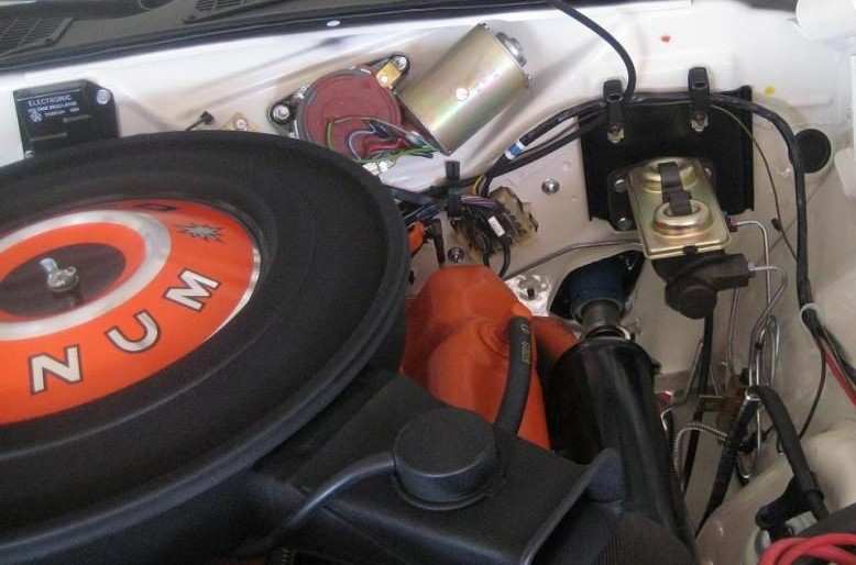

Hi, I'm replacing the starter on my 1970 Challenger 318. While I'm at it I'll replace the incorrect cable that isn't in the best of shape, with a reproduction positive battery cable. The cable came with a black plastic strap 4 5/8" long. It looks like it is designed to loop around the 2 cables (battery and solenoid) with a tab the snaps into the inner fender well. Where does this strap actually snap into?

You can just see it in this picture in the lower right.

Thanks EV2RTSE, I can see it, looks liken it is just left of the upper shock nut or is it right on the upper shock stud?

Yup it pushes on the upper shock stud.
