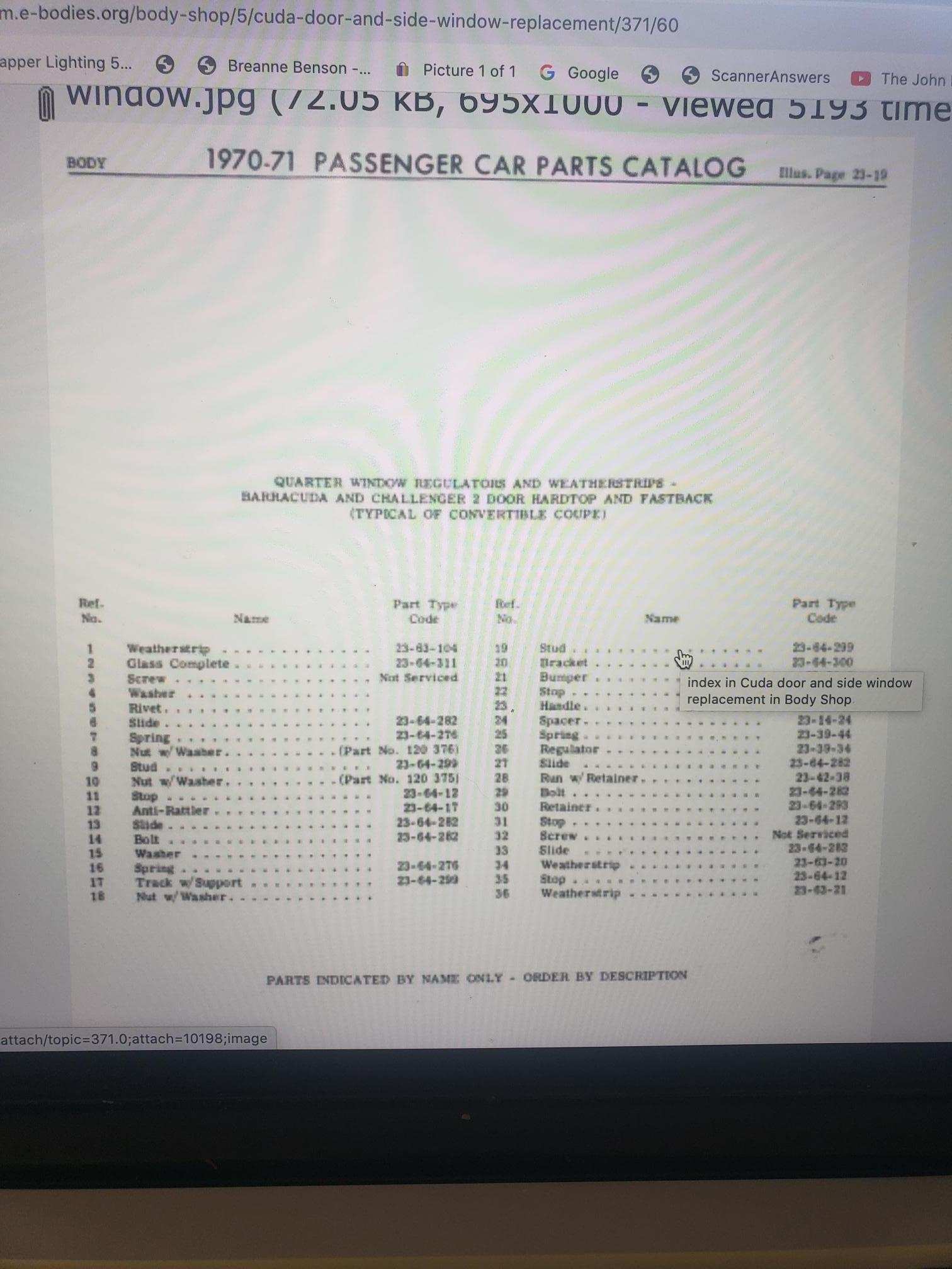

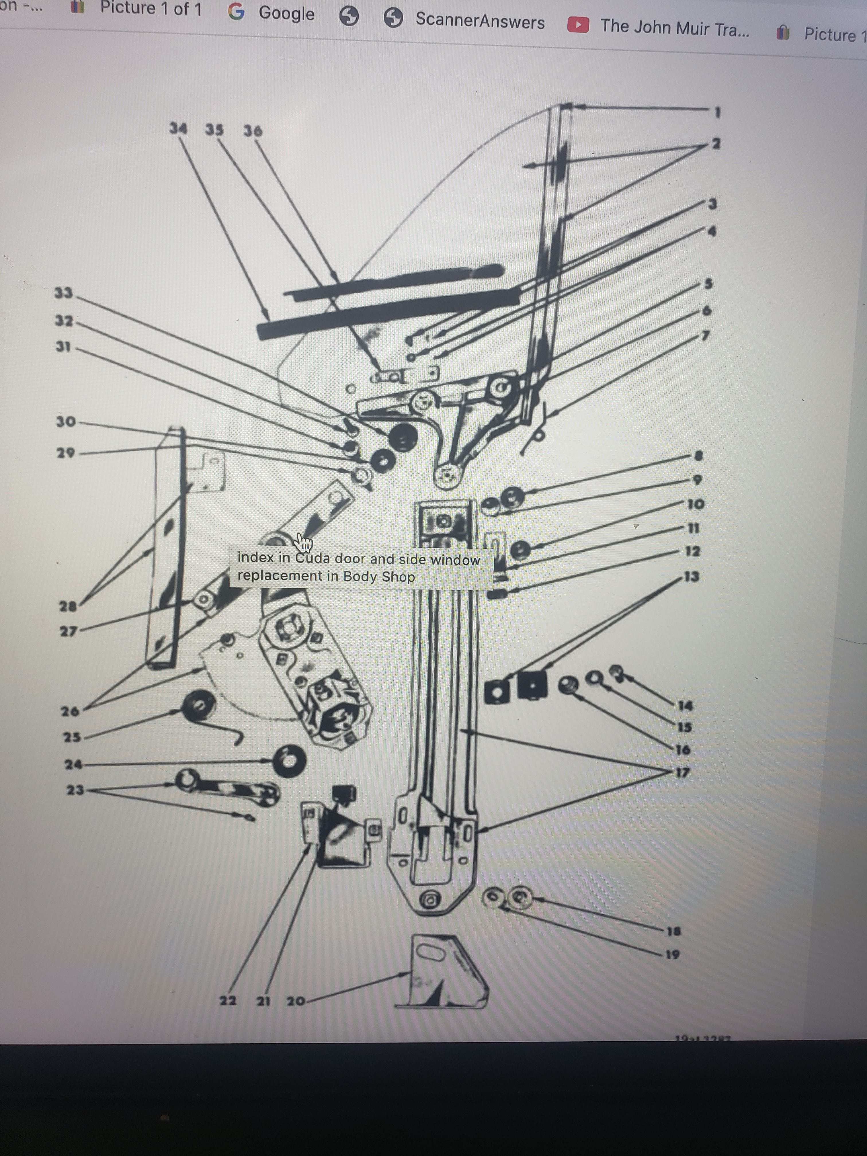

I am looking for the window stop part shown as #35 on the diagram and the screws that attach it to the car I believe although it could be attached to the window but I am not sure as I dont have a picture of it installed. Thanks!

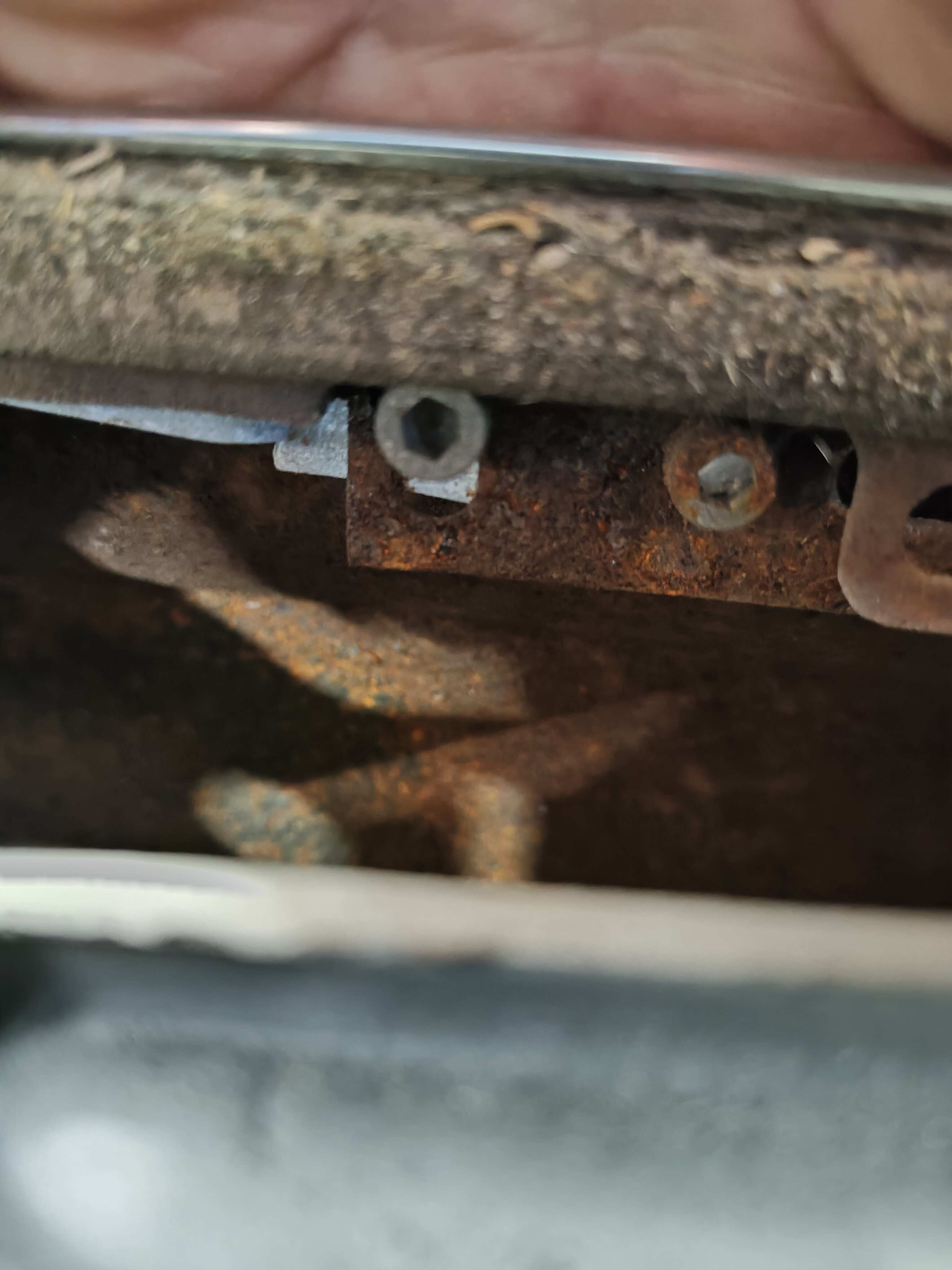

3/16 Allen Drive, 1/4-20 Socket Head Cap screws probably 3/8 long. Here's a photo of the head side.
