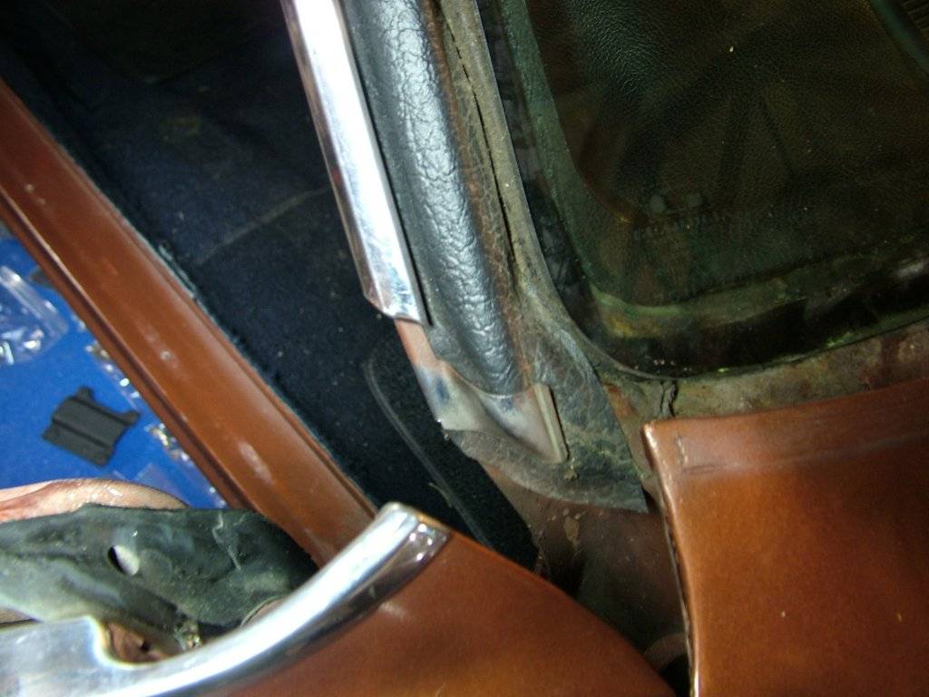

New here -- Looking for some help with my vinyl top on a 1970 Cuda. I bought an "in process" restoration with all body work and paint completed. The previous owner was going to install a vinyl top, so the holes are already there in the rear panel. I do have the trim for this area, however, is there any trim on the "A" pillars where the top stops? Can anyone send me a photo of the "A" pillar area? Thanks.

My Challenger was a vinyl top car, there were some small stainless clips on the inside of the A pillar/ weather strip area.. I think to hold the vinyl down. I will look for them and post a pic if I can find them..

Here is the clip Adam was talking about. Welcome to FEBO and post up some pics of your project.
