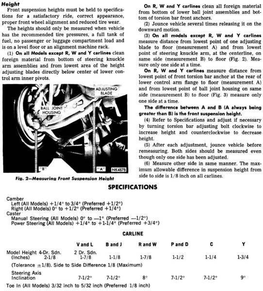

Yes, I believe it can. At least, I've read it can. The height, as you may know, is set by adjusting a downward facing bolt at the front end of the torsion bar. Be sure to lift the car before adjusting.

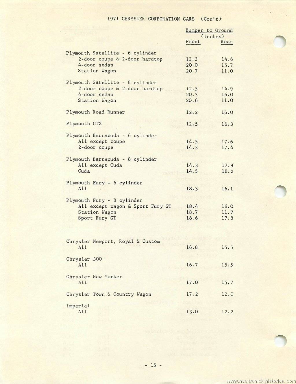

Here is a tidbit of info

Yes it will slightly alter the alignment , I too like the nose sitting lower but this will affect toe & Camber a little .
