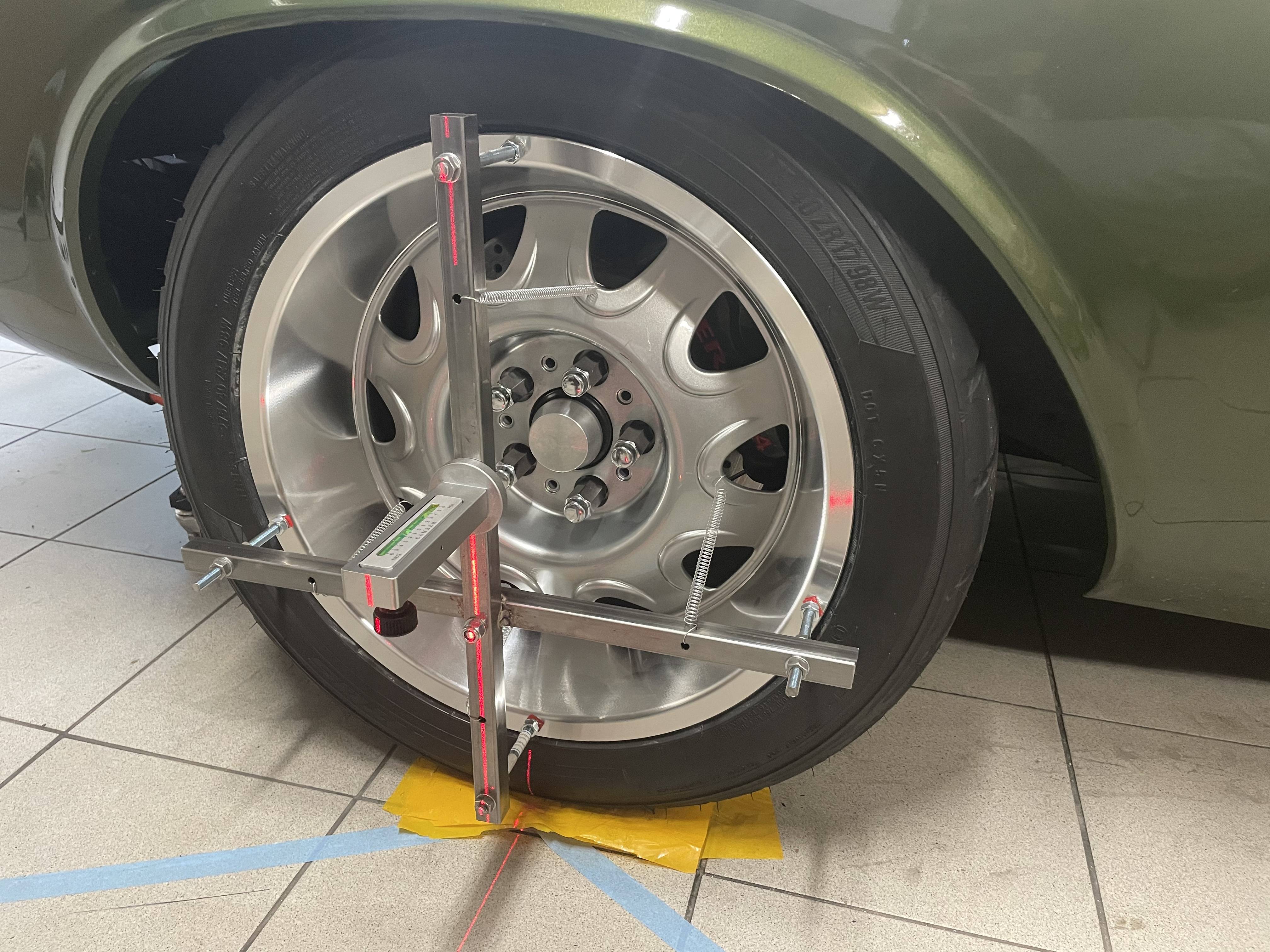

I got around to doing a proper alignment at the weekend but I seem to end up with too much caster (aiming for 5 deg positive caster, 0.5 deg negative camber). I have installed PST non-adjustable tubular upper control arms (checked they are installed the right way round with ball joint level with floor) and adjustable strut rods (adjusted as per instructions with 3/4" thread of eye bolt threaded into rod). I have no binding over full suspension travel.
When measuring caster (on left side) I get +3 deg camber at 20 deg steering angle to the left and -2 deg camber 20 deg steering angle turning to the right (pretty much lock to lock). This means I have 7.5 deg caster (taking the difference and multiplying by 1.5) ?
If I move the rear cam bolt outward to decrease the caster I cannot compensate enough moving the front cam bolt inwards to get enough camber as it is already fully in board (aiming for 0.5 deg negative). I could lengthen the strut rod but would have thought I could get the correct adjustment with the UCA ? Pretty much same readings on right hand side.
I have set the front end ride height fairly low (23.75 in floor to wheel arch) to match the rear (hotchkis rear springs)
I have power steering (for now) so no issues with turning. Just checking my methodology is correct before I look at adjusting the strut rod length ?

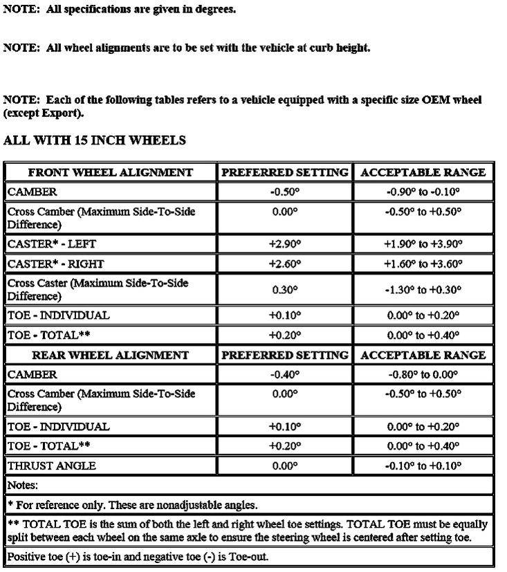

Your ride height affects the alignment settings.The strut rods are not where you make your caster adjustment. You are just moving the lower control arm closer or farther from the rear.
  • MOPAR ALIGNMENT SPECS (1).pdf

Here is my setup.
I have a laser level so first ensured all 4 wheels are level on the ground
Checked ride height is even left / right and where I want it
Front rims are 17x9, 5in offset + 1/4" spacer to clear brakes (spindles are swapped left to right as Baer Track 4 setup has calipers to rear of spindle). Rears are same, also with 1/in spacer to match front
Camber gauge reading verified against phone angle app (I understand I am not going to be to 0.1 deg but should be possible to get within 0.5 deg)
Homemade alignment jig is checked square and reads 0 deg on true vertical, (verified with laser)
Experimenting with strut rod length, I pulled them off the car and measured against the originals. I needed to add around 1/8" length. This made noticeable difference to the caster so I am now around 5 deg caster with 0.5 deg camber (with possibility of additional 0.5 deg camber). As I am planning to use the car on the track I will probably keep it there.
Edit; after looking at my photo the 20 deg tape lines did not look correct so checked these and they are closer to 30 deg, doh! so looks like it could be a simple fix and I need to go back to school !

Sorted now with 5 deg caster and 0.5 deg camber. That was a learning exercise, but should be straightforward next time round! Thanks all for your help and replies 👊
