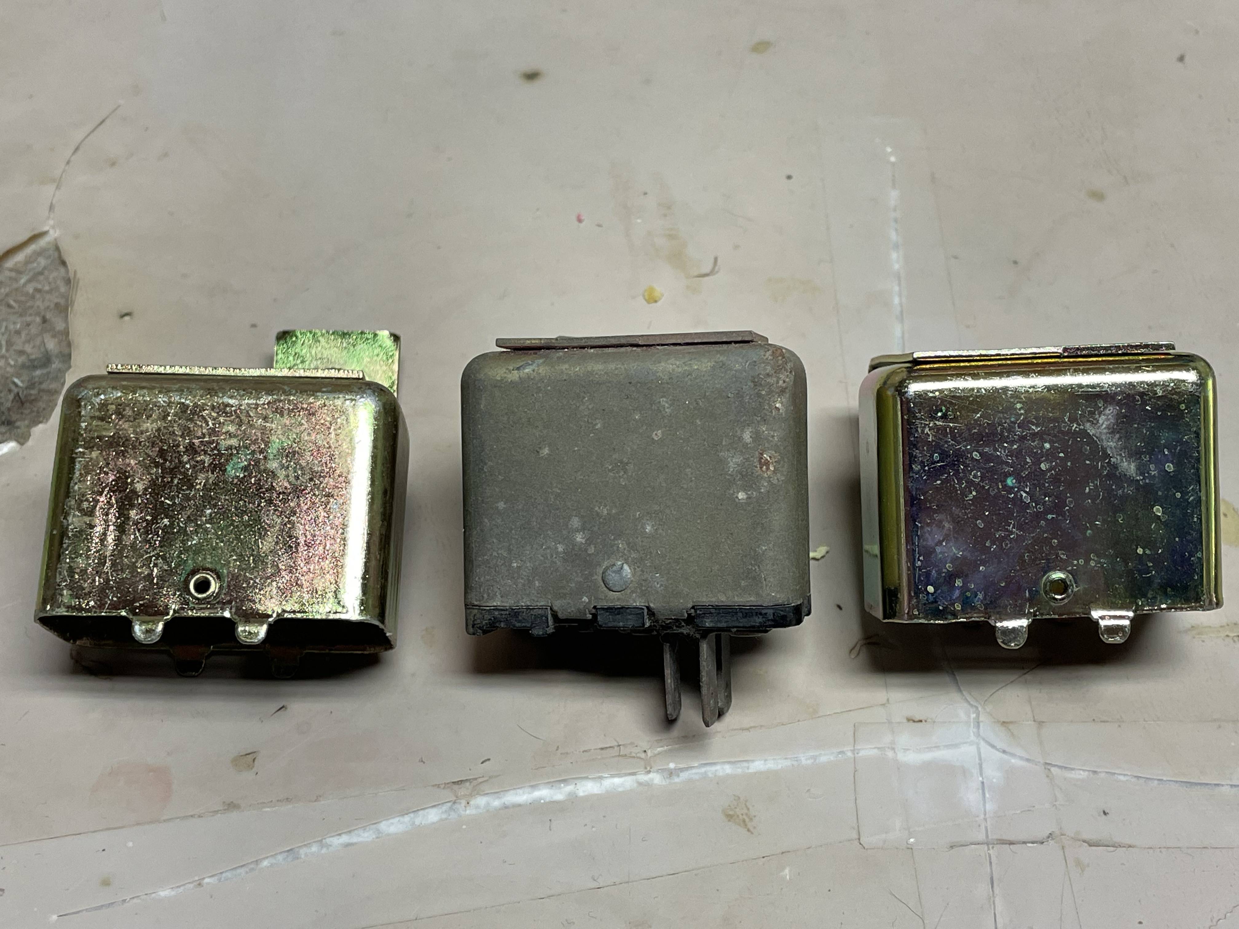

Hi.
I bought this NOS piece a while ago. I thought it was a headlight on buzzer but the one fitted to my car has only two terminals.
The new part has 3 terminals.
Perhaps it is a horn relay?
If anyone has a parts book could you check on this for me.
Thanks Steve

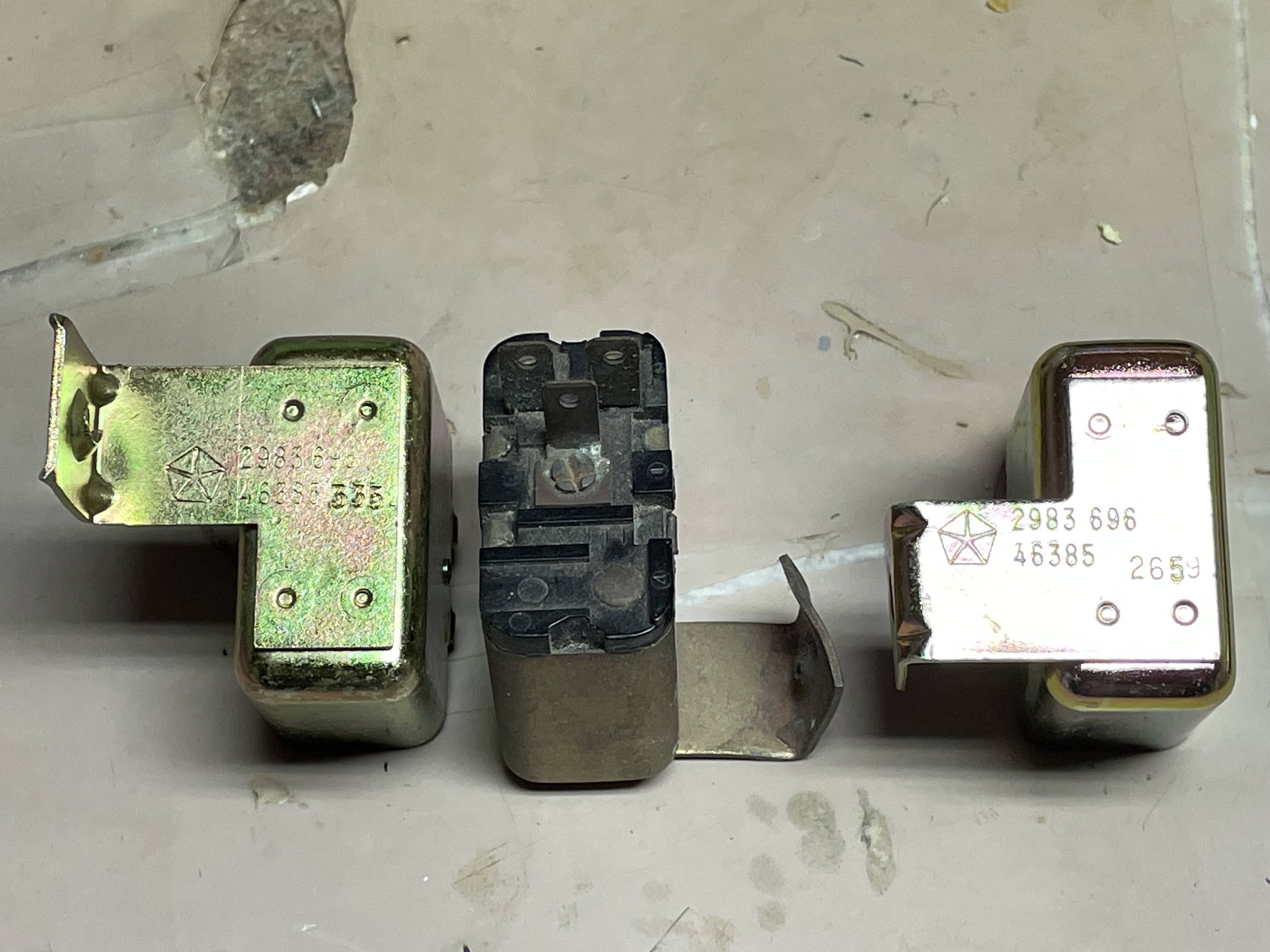

The part you have is a "key in ignition" buzzer relay. When you open the door with the engine off and the key in, the buzzer will turn on.

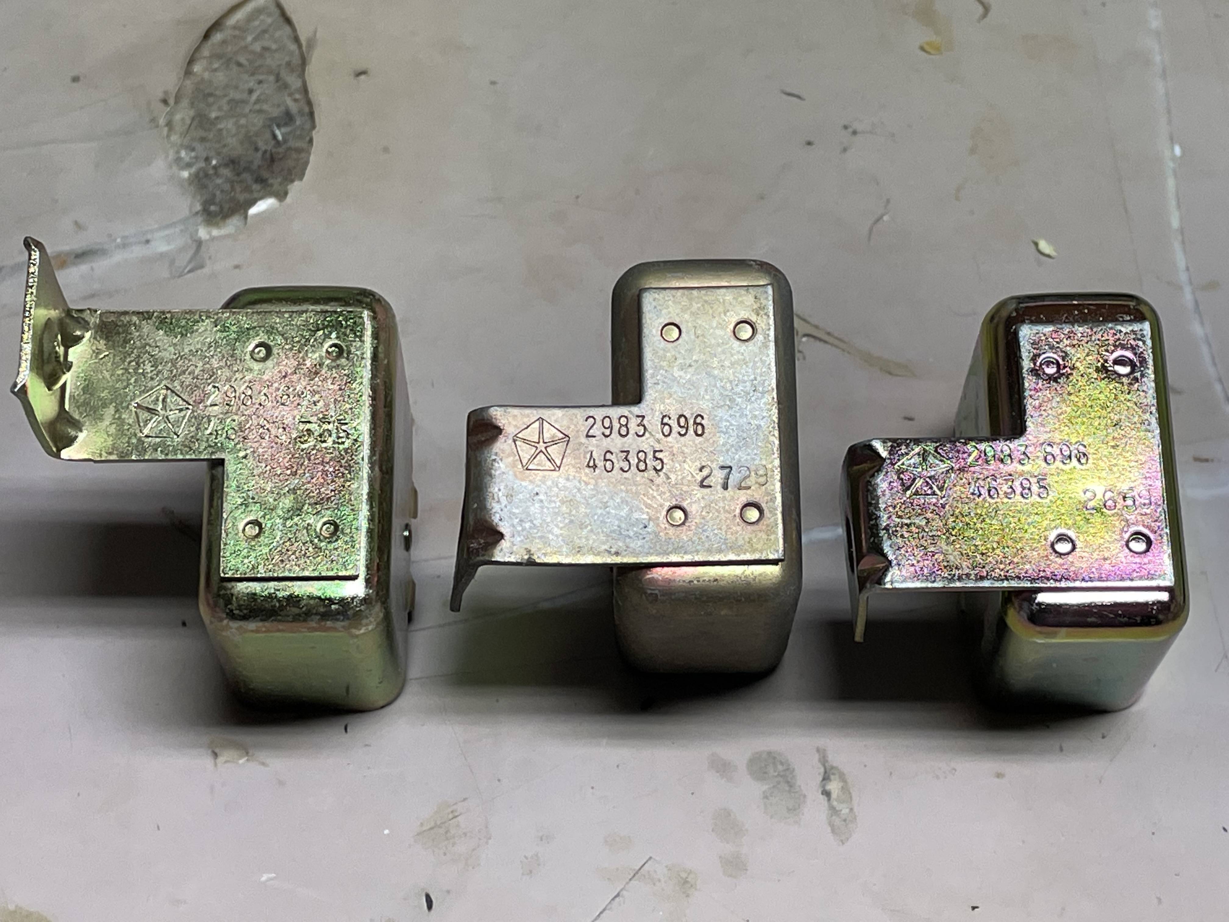

The 2983695 is the B body version and the 2983696 is the E body version. The circuit boards are the same and the only difference is the mounting flange position. The B body is bent up and the E body is bent down. This 695 number stamping is very light and took a close up to see better.
The relay is actually a four conductor device. The two outer shells in the pictures were plated in dichormate zinc. I had a 696 to use showing the circuit board. You can see neat the bottom of the shells that there is a hole. The outer winding on the internal coil is soldered through the hole. Mounting the relay provides ground being the fourth terminal. If plugged in with the three terminal socket, left hanging without mounting it with the screw to the dash frame, the relay will not work properly.
