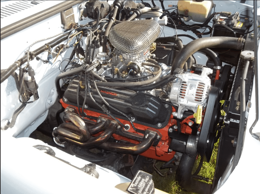

I have a 71 Cuda
I am running a shaker hood on a 340
I am considering putting a 360 magnum. I like the updated accessories and serpentine
Does anybody know if i can run the 360 magnum and its AC compressor and clear the shaker hood air cleaner?
Picture is not mine, just pic off internet for show

That is not the factory serpentine belt set up. Better to run a stock LA timing cover and aftermarket serp belt system to work with modern a/c, fuel pump, water pump etc...
