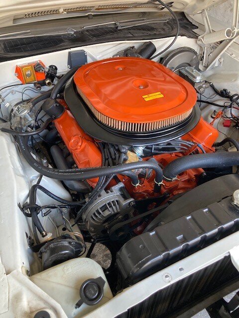

This is a 440 with CH4B intake in my challenger with flat hood. It does clear the hood but the aircleaner would touch one of the braces every now and then under heavy acceleration. A dual snorkel air cleaner would give me more clearance so there is no interference.

Thanks for the info and pics. Beautiful car! I have a tall deck 440 and a taller intake which is causing my clearance issue. The flat hood will close with no air cleaner or air cleaner stud in the carb. I went ahead and ordered the rallye hood to get the extra clearance I needed.

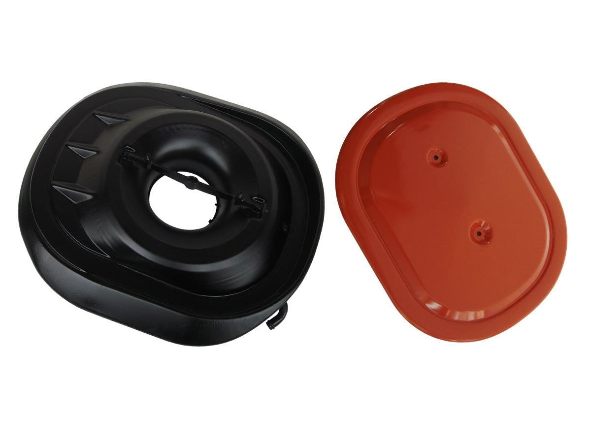

I've been searching for that style air cleaner for a while. I've got a 70 Challenger that I upgraded from a flat hood/ 318 to a Rallye Hood/ 440 a while back. Any idea where they can be had?
Glas86
Mar 30, 2018
27
13
I have a single 4barrel carb so an air grabber air filter worked for me.
You can get them at pg classics.
There is one for 440 and one for 383. The 383 one sits higher. I got mine on a swap meet buts its identical to this one:
