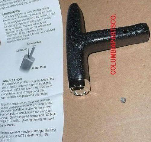

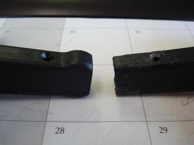

Is there a difference between the slap stik t-handle used in 71 and those used in 71+ E and B body? I ordered the 71-74 t-handle from Year One and it is made differently at the bottom and does not fit correctly. I have found some info around the Internet that suggests to me that 71 is on its own but I have not hard proof yet. Year One says they have never had this issue before. I will supply pics later. Please let me know what you know!
