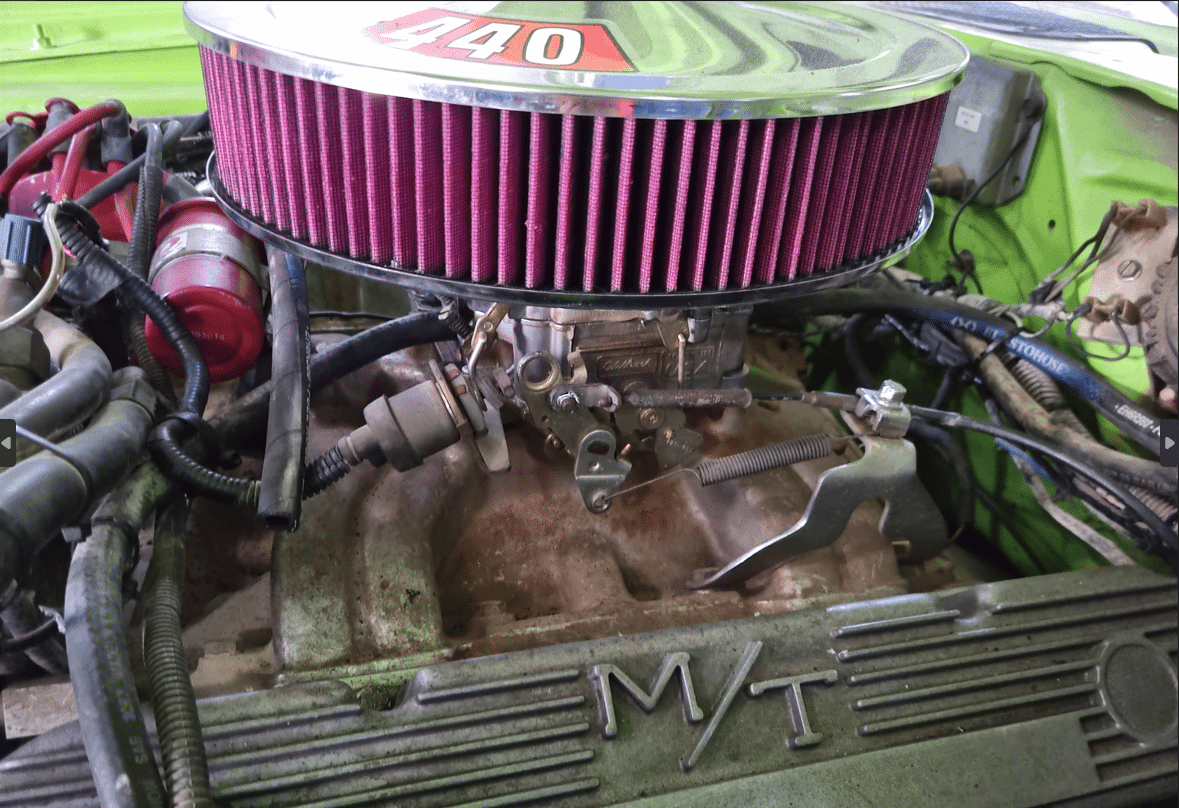

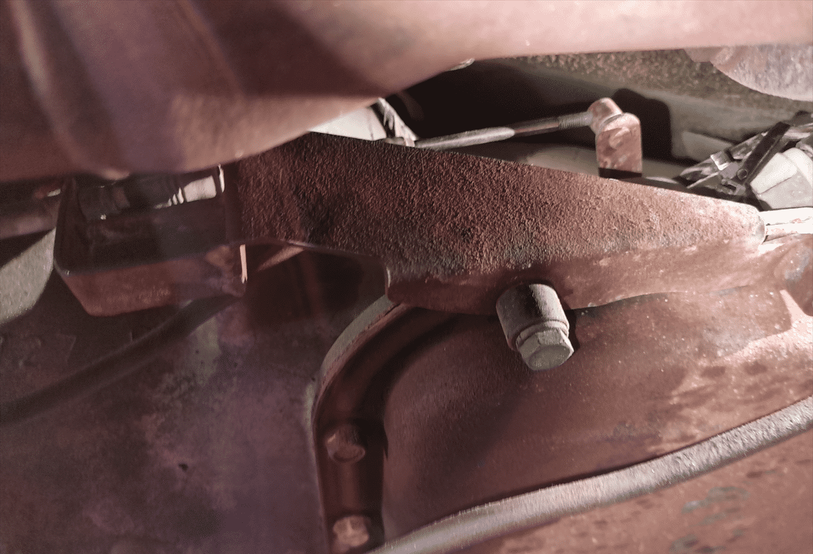

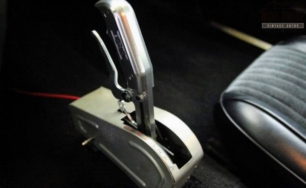

Hey guys , just bought a new car with a 440 mated to a 727 , the car drives but dosent go through the gears , feels like its stuck in second or first, dosent shift manually too , it's got a aftermarket B&M pistol grip cable operated Pro shifter , i can shift the lever manually by hand to all gears , the cable is far too long , its routed to go around the transmission oil pan one whole round before it comes to the linkage , could that be causing it? im not sure its a manual valve body or not? it has no kickdown ?maybe a auto/manual valve body?

Ok the long cable is normal , they just don't have short ones & you have to tie it up well to prevent it getting burnt on the exhaust .
If it has no kickdown either the trans is being damaged driving it or it has a manual valve body .
Your message is confusing , you say it doesn't go through the gears & feels like it is stuck in a gear , but you also say you can manually shift into all gears . If you get different rpm as you move the shifter into all 3 forward gears then the trans is working but has to be manually shifted , if it won't shift & is stuck in 1 gear no matter where the shifter is moved to then there is a problem inside the trans assuming you are going fast enough to feel the rpm difference as you change gears .

OK so could be a problem in the adjustment of the cable or possibly the valve body inside .

It can be difficult , the 727 has a longer throw between Reverse & Park with the other gates being equal , the only shifter I am aware of that fixes this correctly is the Cheetah

I agree with you on the Turbo Action Cheetah Chryco! My Auto-Manual early series Cheetah shifts great. 3.55 gear and a little throttle you better have it pointed in a straight line when it catches 2nd. No delay in shift points.

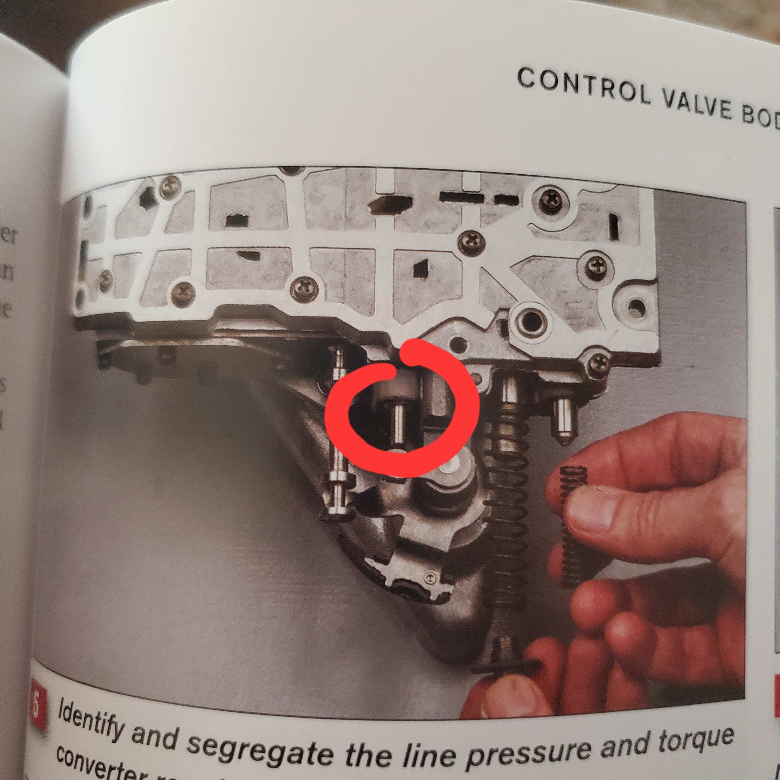

Without kickdown linkage, you'll find out soon enough if it's not a fully manual valve body. Especially with a 440. X3 on the Cheetah shift cable. It's the next best to stock shift linkage.
Personally I'd drain the fluid, drop the pan and checkout the valve body. If it doesn't have the circled detent valve, it's manual. I hate "unknowns".
