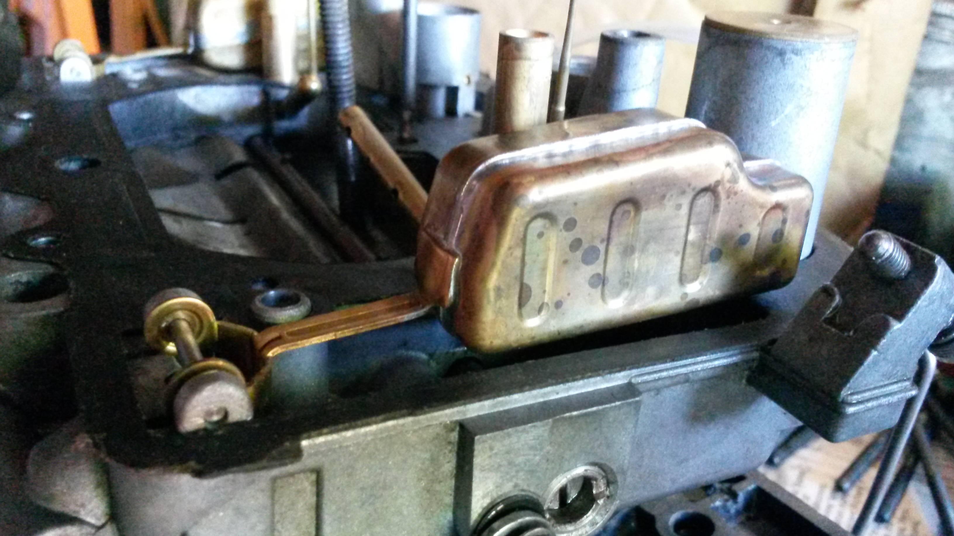

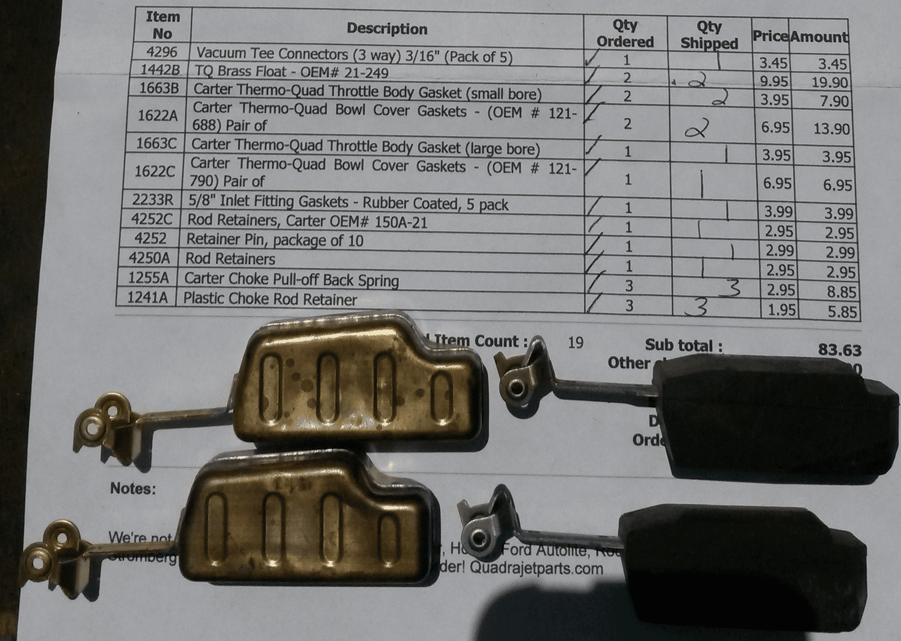

Carter Thermo Quad part.Can you see the difference? If you can't see the difference you need to find out before you touch a Thermo Quad. That's why it's misunderstood. Not knowing how it is put together. Even the manufactures of parts and re builder.
First picture is of a new set of brass floats. Well there made wrong.black ones are correct and original.second picture is original float installed. Third picture is the new float installed. Forth is the the new float on top and an original on the bottom. I contacted the vendor and had to show them other pictures and from Chrysler pictures that they were made wrong.I don't fault the vendor. It was put in the jig wrong when made.
