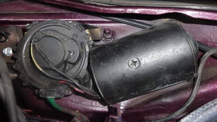

Trying to work thru the issues to get my Massachusetts inspection sticker. Wipers must work. On low speed the wipers work fine. On high speed they barely move and only for a short distance & then they stop moving. From low speed when I shut them off the wipers just stop where ever they happen to be. They do not park.
I saw the post about bad grounding & jumped in a separate ground wire but nothing changed. My switch seems to me to be a two speed (Off, Low, High) it is part # 3488 773.
My wiper motor is part # 2926 919 and one site I went to said it is a 3 speed motor.
I saw another post that said a miss match makes the parts unhappy.
Can someone tell me if I do have miss matched parts? And if so, any idea if my car should have a 2 speed setup or a 3 speed setup? And the correct part numbers that I should have.
