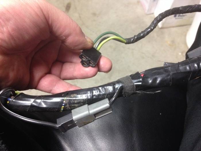

I do have a 73 service manual and I just dont see the 2 tan plug. Was thinking maybe for defrost or fog lights. Im putting in a new dash harness and dont remember that wire being hook in the dash harness.

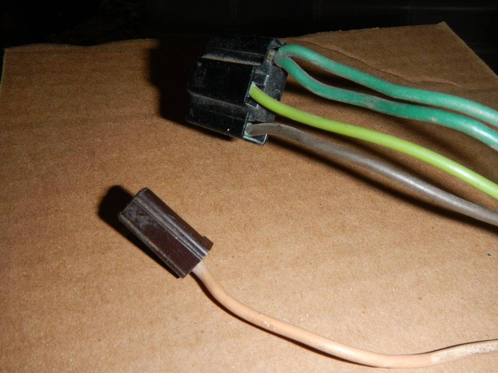

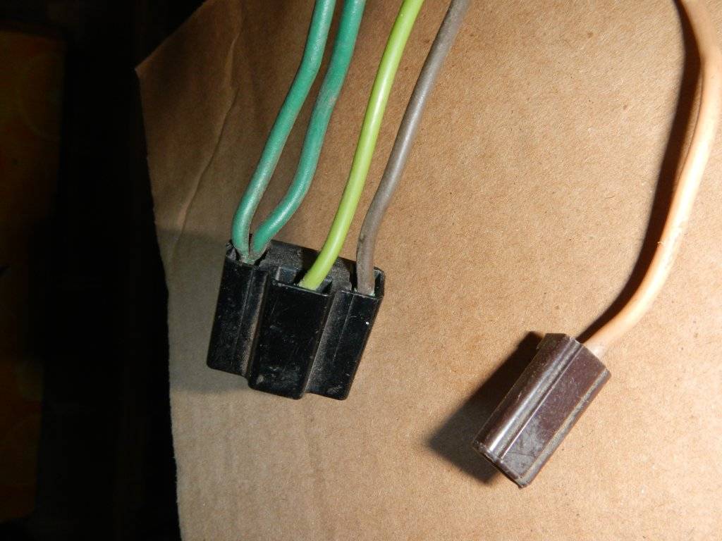

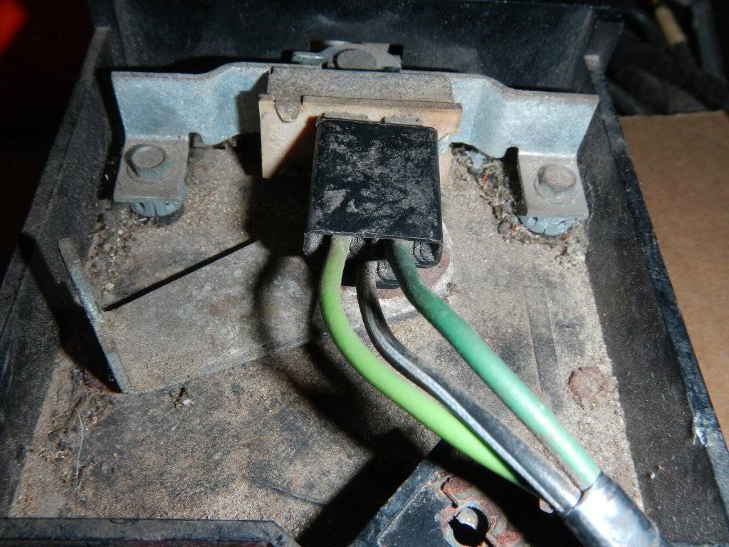

Here's some pictures of my original harness connected to the AC/heater switch and the terminals that go to the AC/Heater blower motor resistor. I'll try to look further next chance I get.

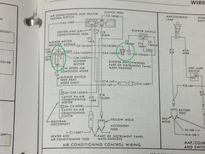

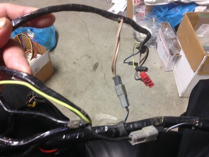

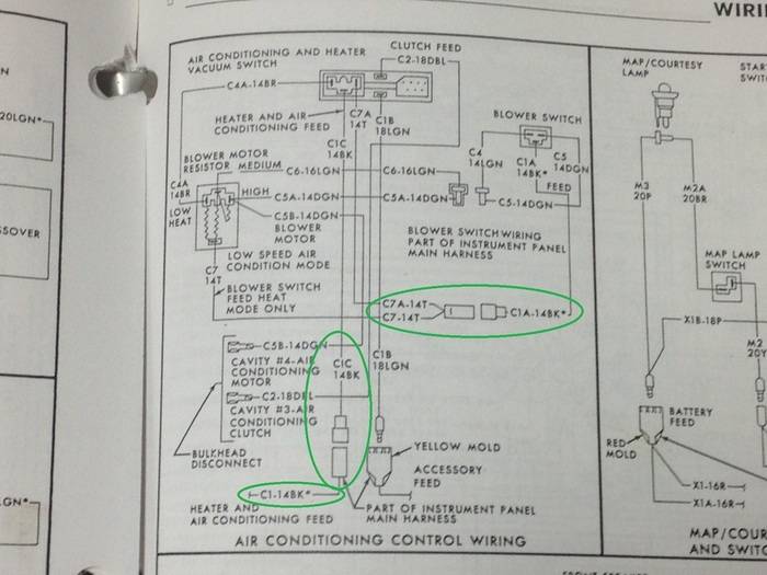

Hey Dave,
I see what is the issue. This first picture is a normal non a/c wiring setup. The dash harness has an insertion wiring connection between C1-14BK* and C1A-14BK*.
For the A/C wiring, disconnect C1-14BK* and C1A-14BK*. The A/C sub harness dual tan connector C7-14T and C7A-14T plugs into C1A-14BK*.
Further away from the A/C controls, there is the CIC-14BK* on the A/C sub harness that plugs into C1-14BK*
I edited the schematics to show where these connections are.
Hope that helps.
Jim

Thanks Jim dont know how I didnt see that. Guess the eyes are not what they use to be. Looked in my book and BOOM its there. I had the 2 blacks hooked up in your pic,not the the black and 2 wire tan.Hope all is well with your family Jim God Bless

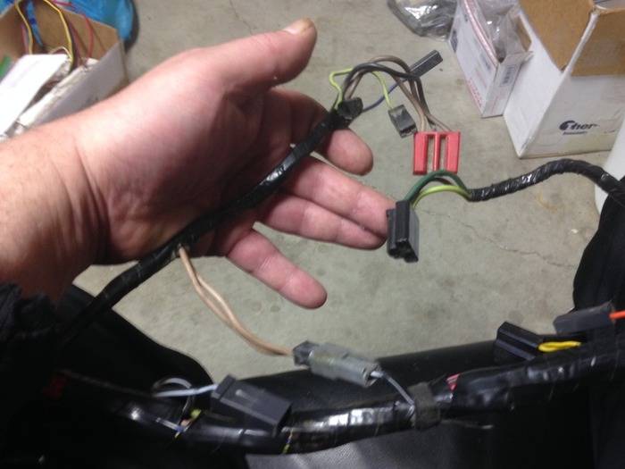

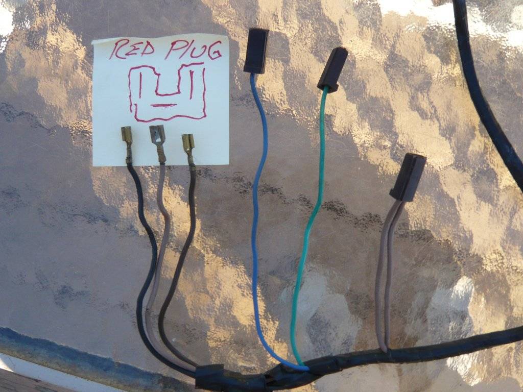

hooked 2 wire tan in dash harness and no power to fan. Hooked the 2 black wire on main harness and fan works. Any clue why Jim?Signal tan is hooked to controls..
Slotts
Feb 12, 2011
72
83

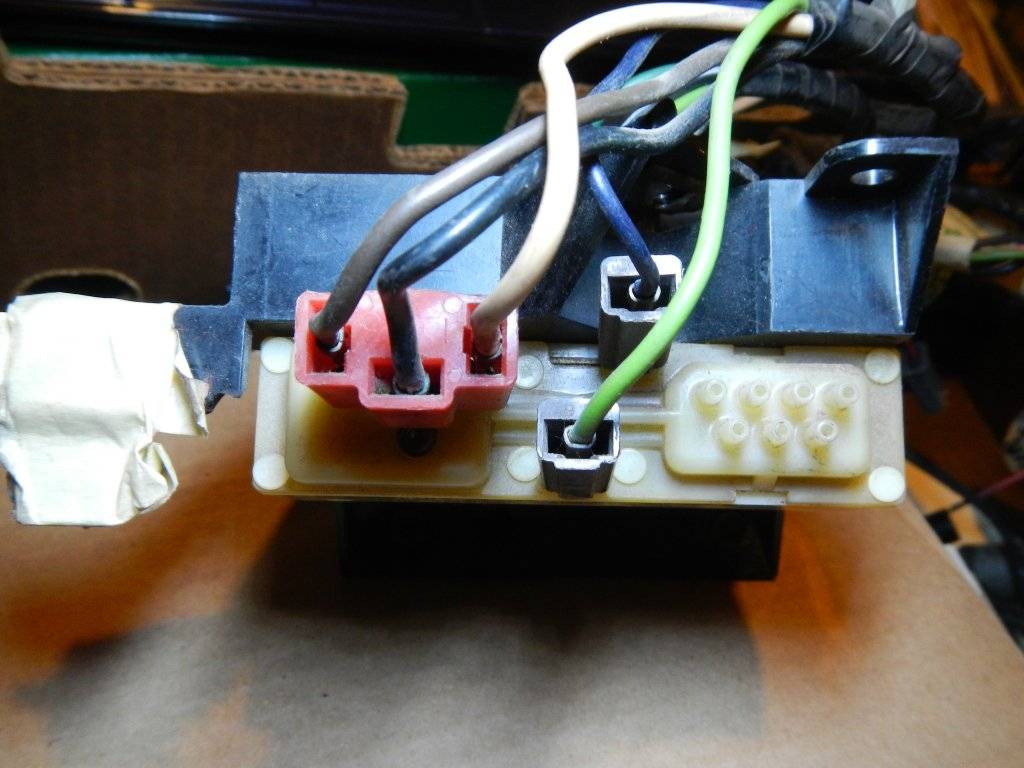

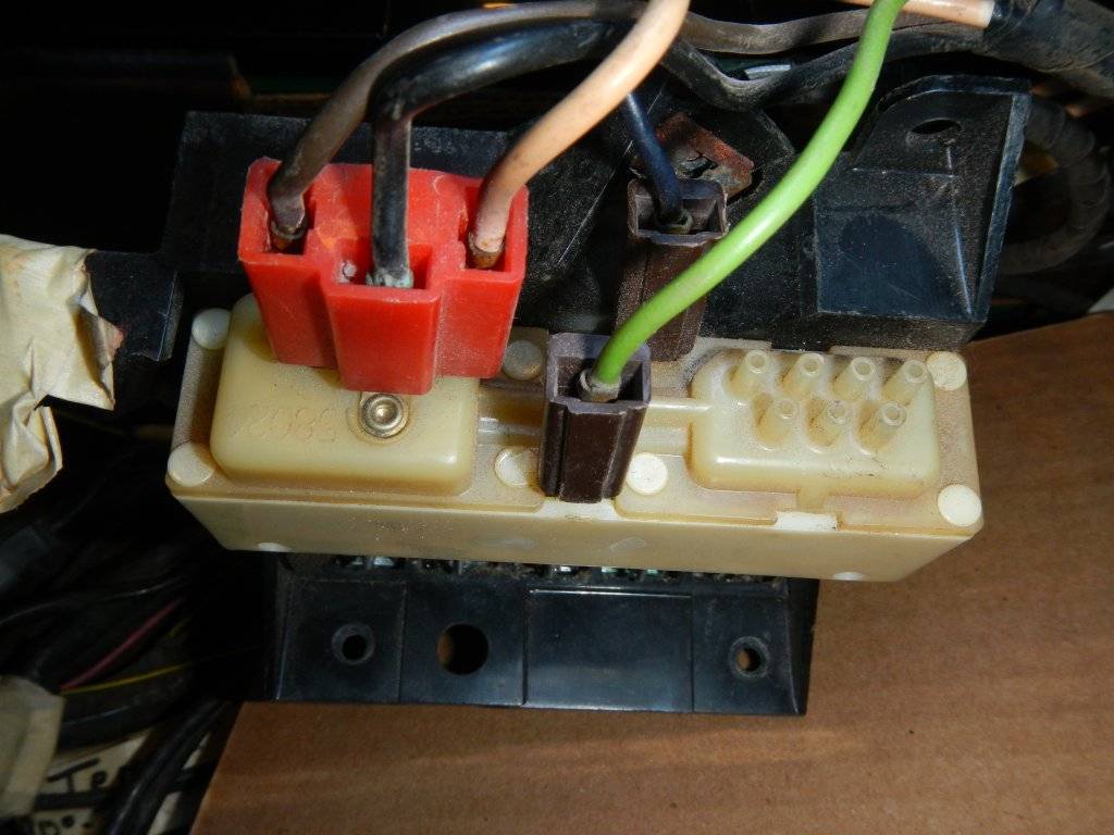

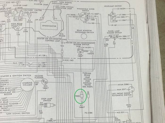

Hey Dave,
I just saw this and something came to mind to check. The very first picture that you posted for the red three position connector that plugs into the vacuum switch show the wiring in the wrong location compared to the hand written note of the connector outline. Member 71RT383 does show in picture DSCN2834.JPG the loading of the wiring into that connector correctly.

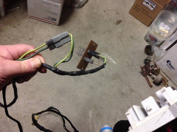

The picture posted below show the A/C heater box circuit board and connection that needs made from the sub A/C harness connection into the main dash harness.
Keep me posted.
Jim
