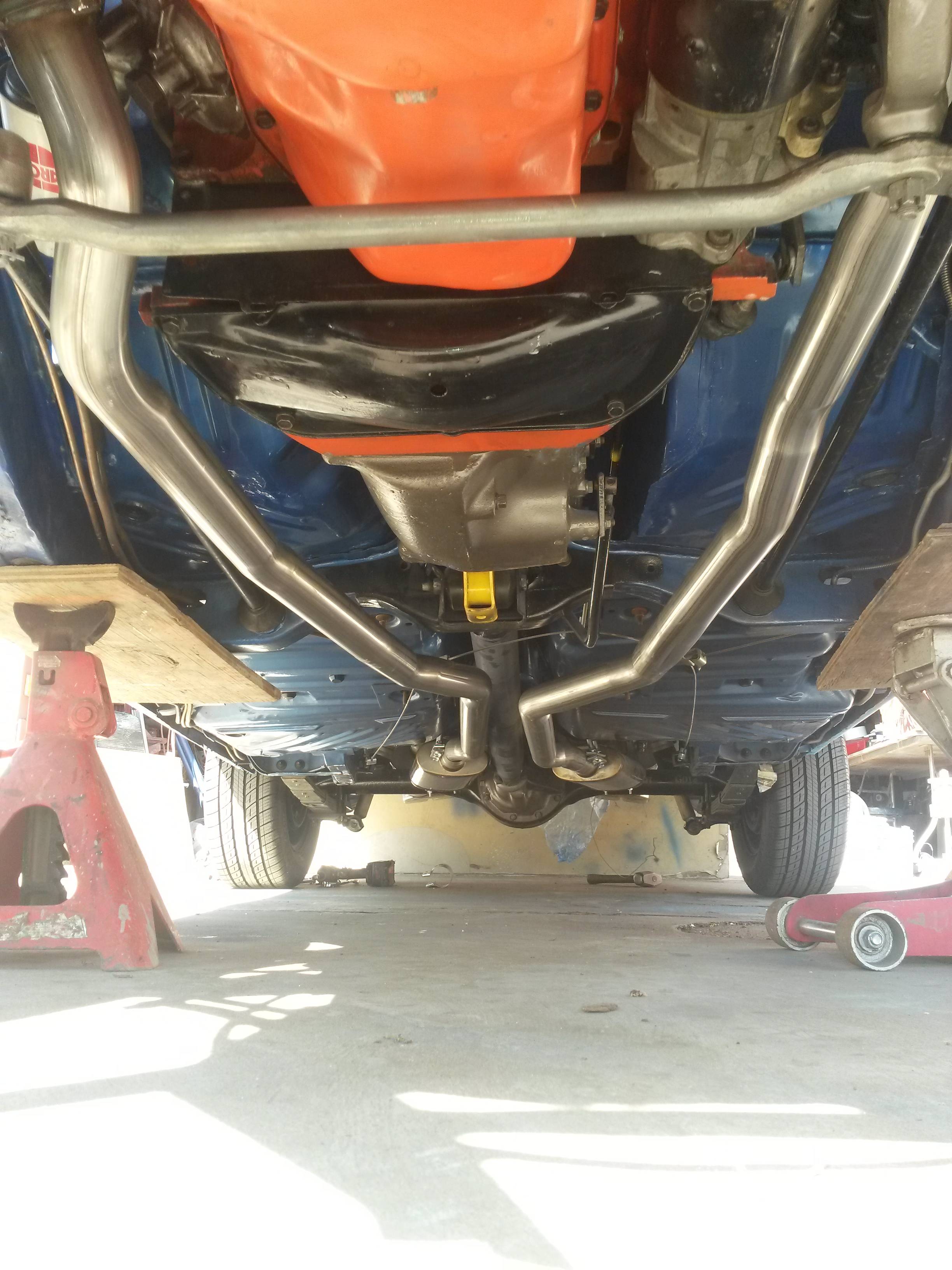

Just a thought,is it on backwards? maybe something simple.

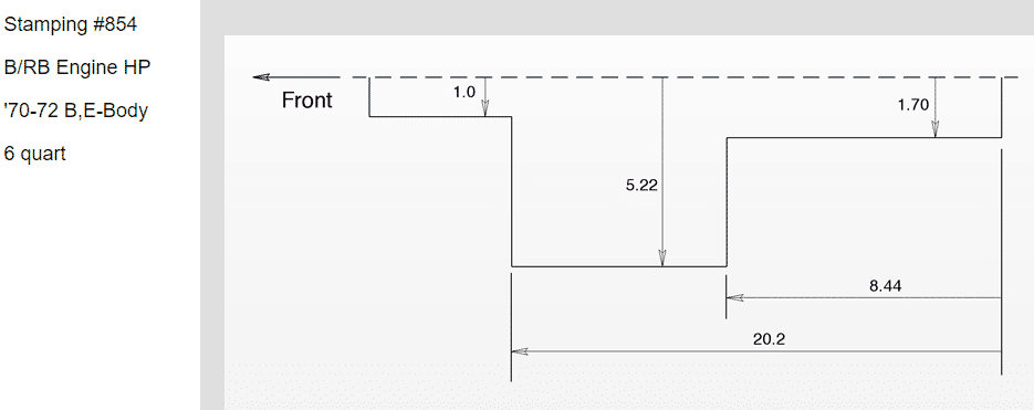

Maybe these dimensions can help if the trans is not the issue............

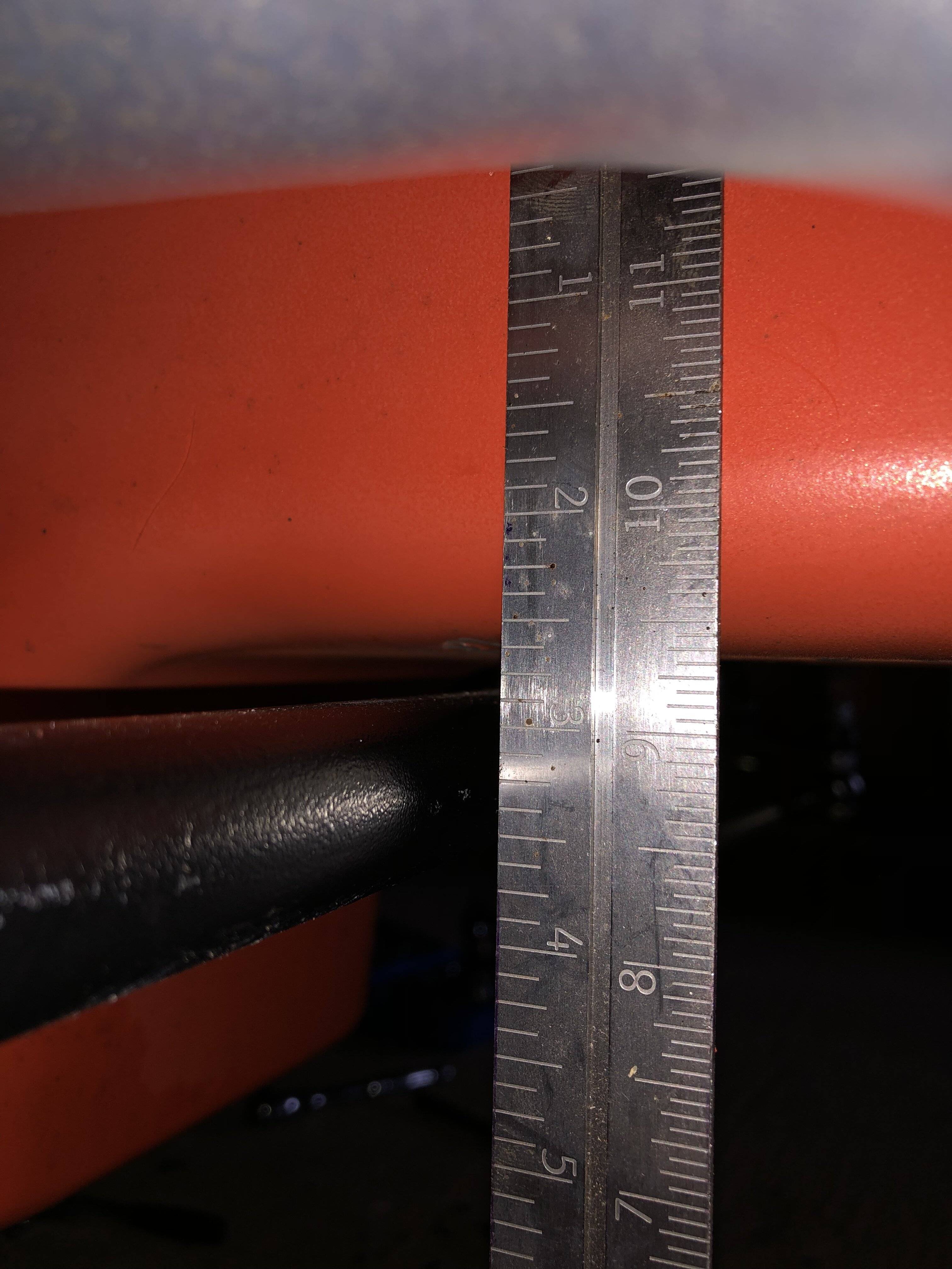

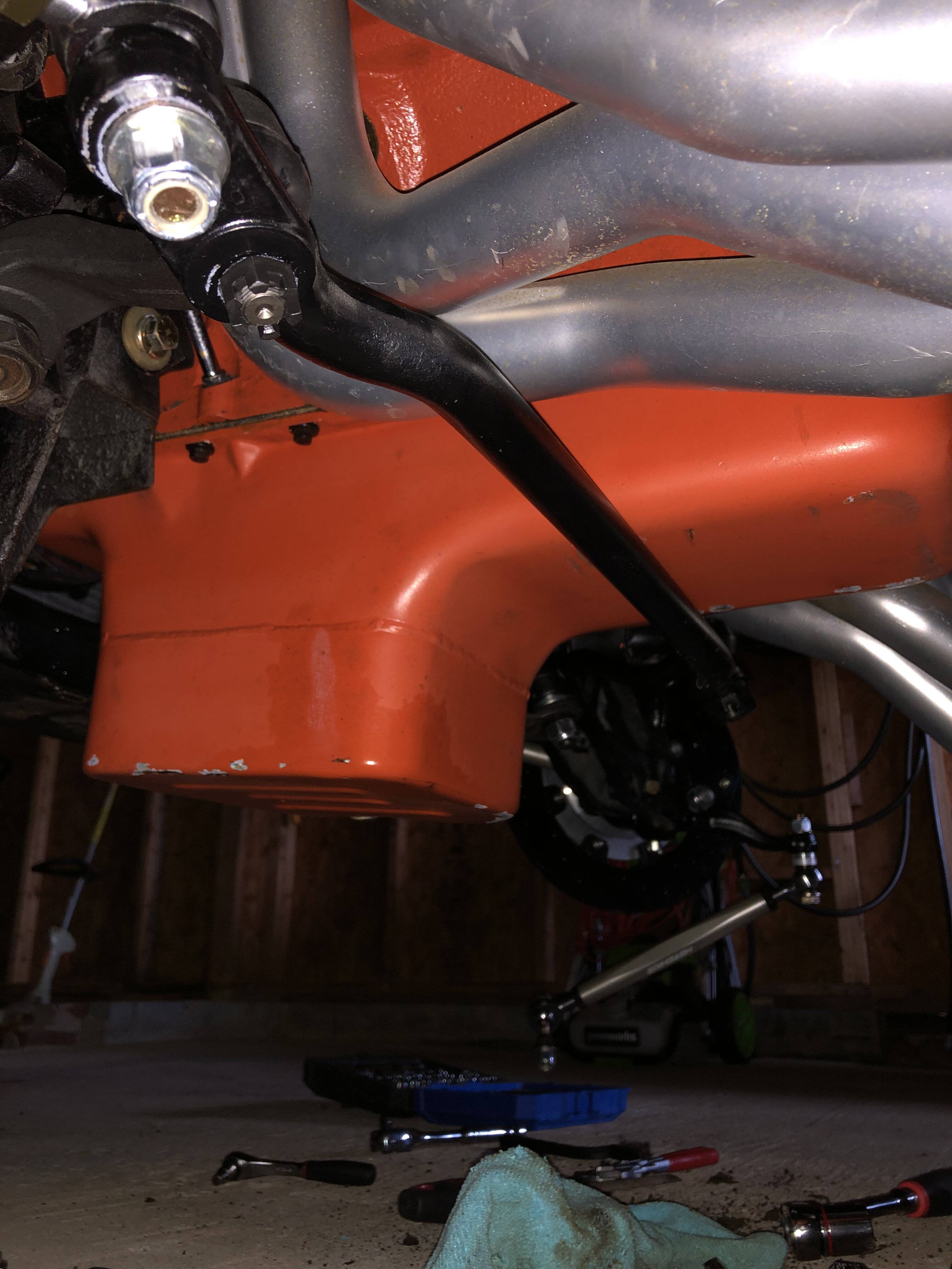

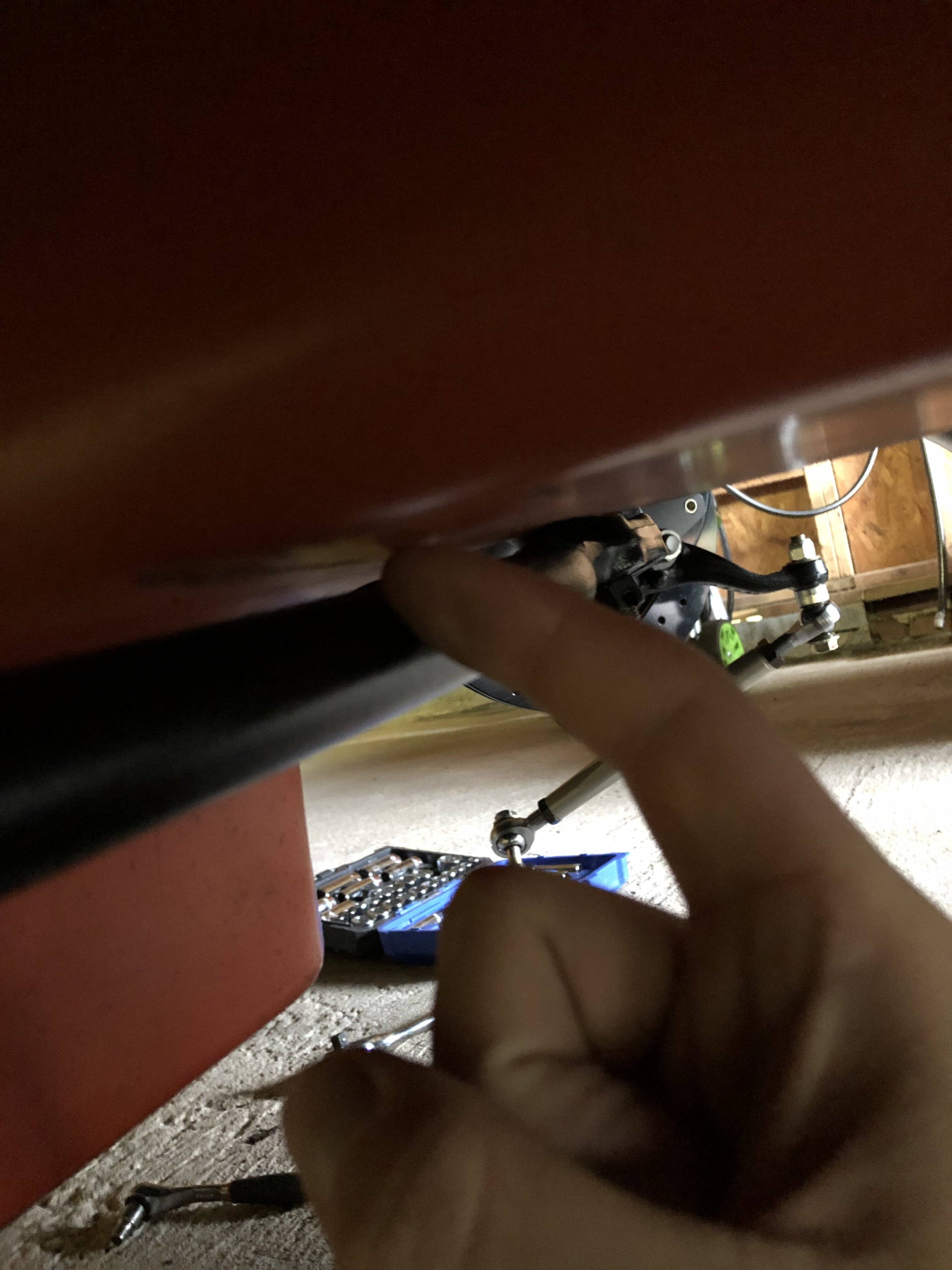

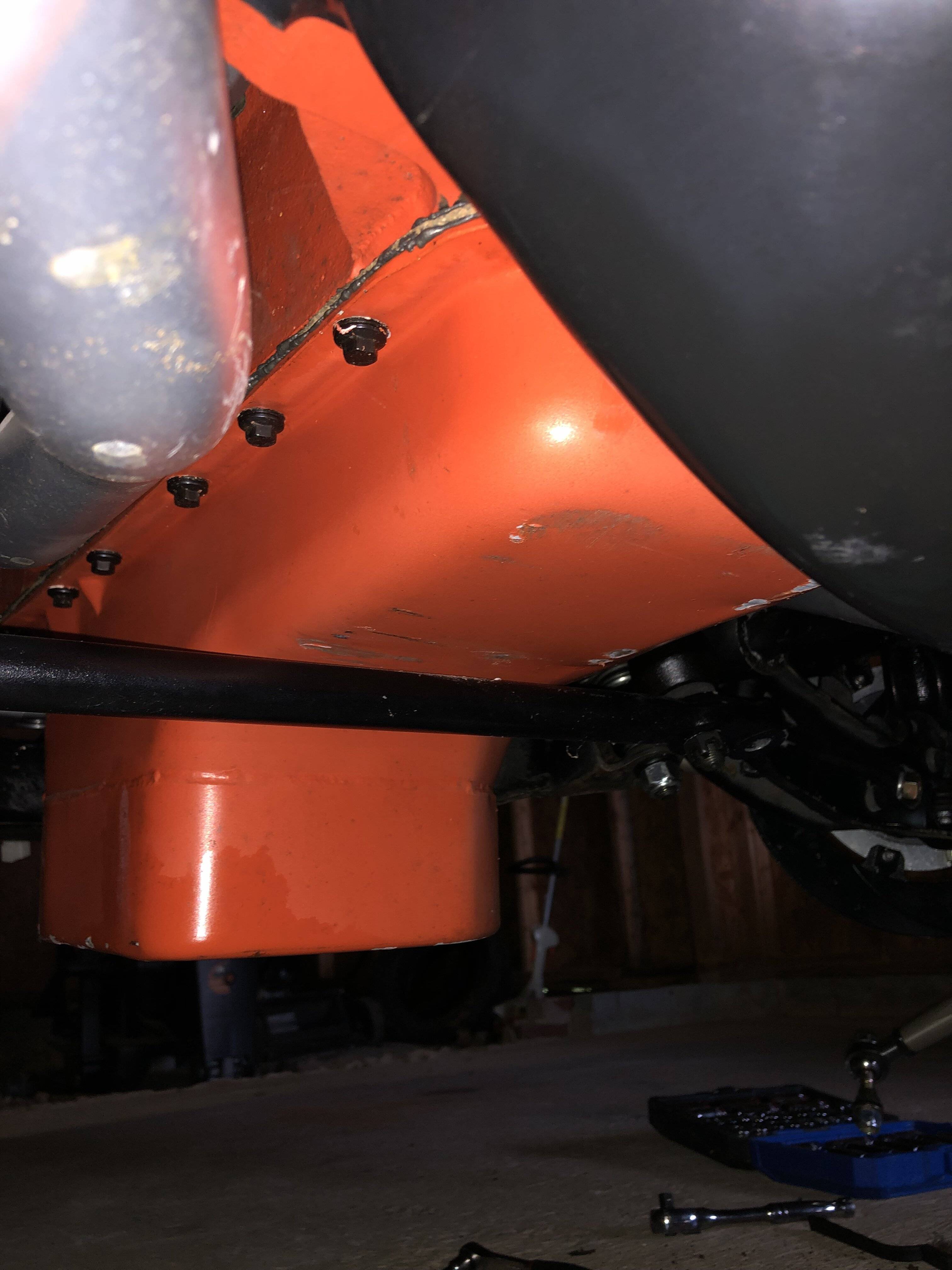

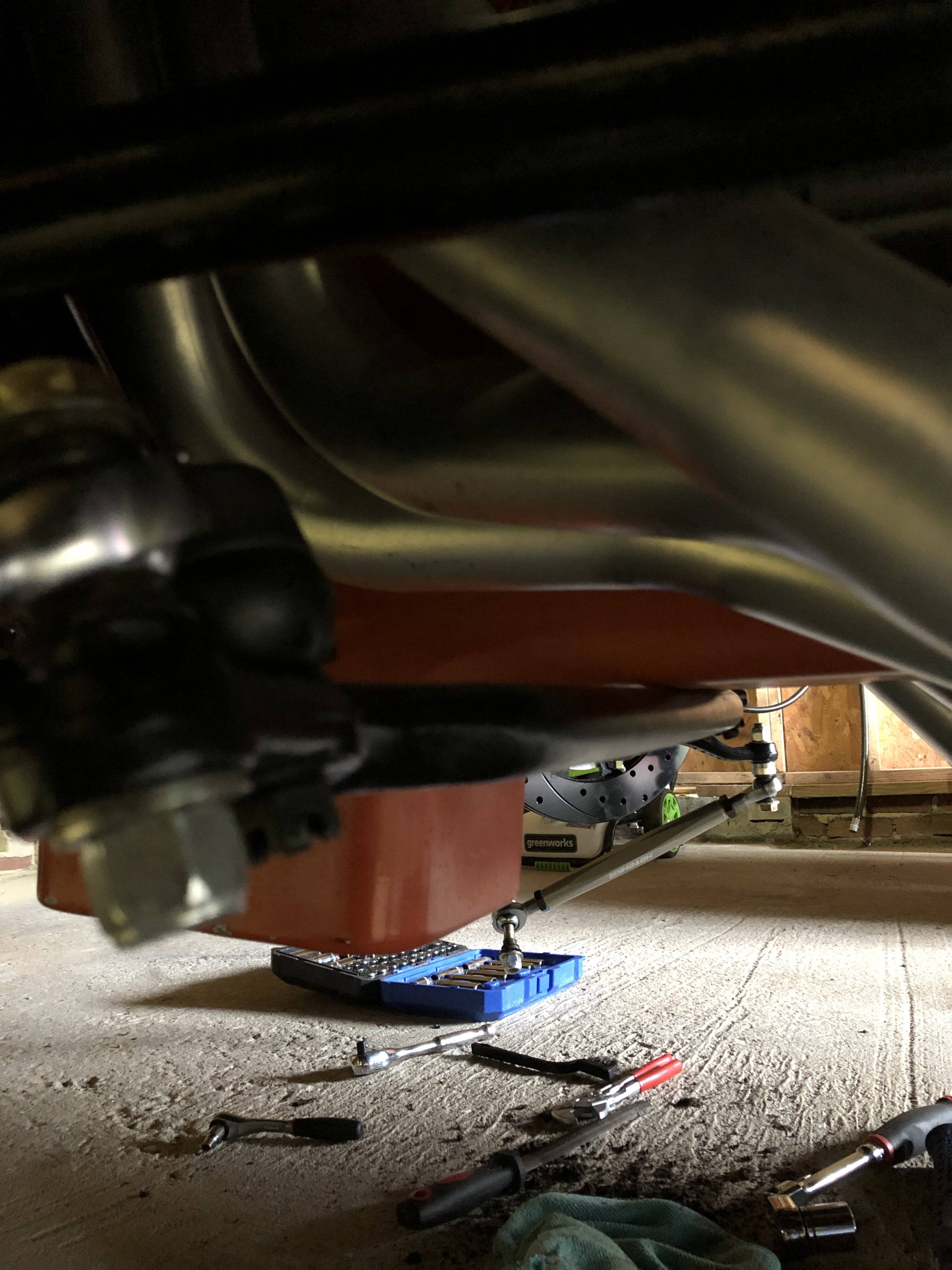

Afternoon gents,
I went back and got some pics for you to analyze. In the first few shots you can see how close it is and where it’s rubbing. This is with the steering turned full lock to the right, and then almost back straight. Then, the last photo shows you the depth of the pan above the link itself. This was a Mopar 7 qt. pan that came with the engine when I bought it (not the 6 qt pictured above from Daves69).

1 Peen the oil pan. 2 as 70 call440 said.shim the motor mounts and slide the trans mount 3 change oil pan.4 Myself I would like to know whats wrong.bad motor mounts or holes? 5 Take advantive of problem.If there is enough taper to the oil pan? upgrade to a longer pit man arm and idler arm.

I did try raising the trans and I can only go about 3/8”, which only gives me another 1/8” at the pan. So isn’t enough to clear.

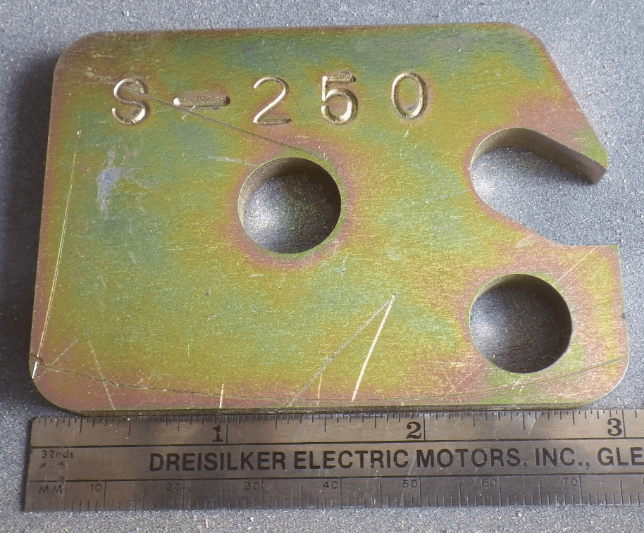

Can ya' add a 1/4" of shim on the engine mounts? Again, consider clearances.
This is what Schumacher sold in various thickness' when in business.......

How much clearance do you think you need? It is not really a moving part(oil pan) so it doesn't need much unless your mounts have too much play.
Too much play means other problems. Not to worry too much . An inch is as good as a mile unless you are off roading ( Not likely).

It is the tightest against the pan when the wheels are straight (castle nuts aren’t even tight on the link yet), but I would think 1/4” would be enough at that point. If I used a couple of these shims, I would probably need them to be .375”.

Why don't you just ditch that deep pan and get yourself the 6 qt Hemi pan, 7 qts with filter.
Probably what I am going to do. I believe that is the only real solution. Next question is, can I change the pan and sump without lifting the engine?
