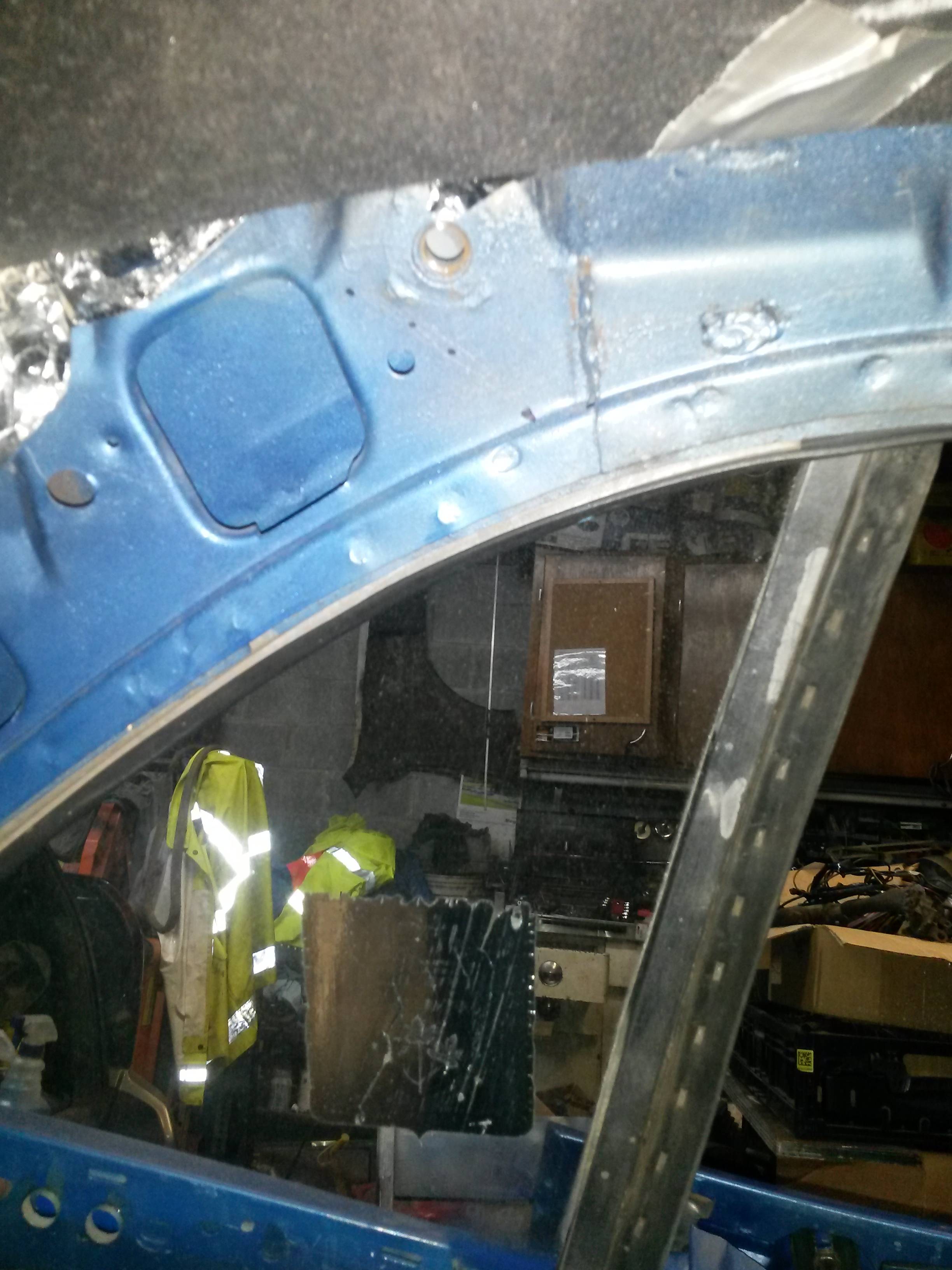

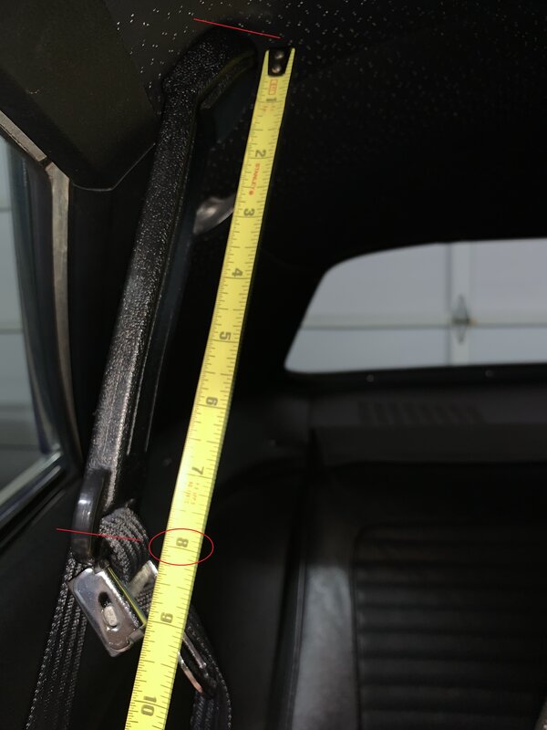

I do believe the threads are the same as the floor. behind it feels like a large square nut 1". make a slice or an x when you find it. picture of drivers side.
Do you happen to have a photo from further away? I've found a couple spots that feel like a hole. I'll do some internet searching also.
Challenger RTA
Oct 28, 2018
2,665
1,334
PA Flood city
Sorry had to finish watching an old episode of Combat,would have done it sooner. Hope this helps. headliner in place ready to glue. the hole is at the top of picture.

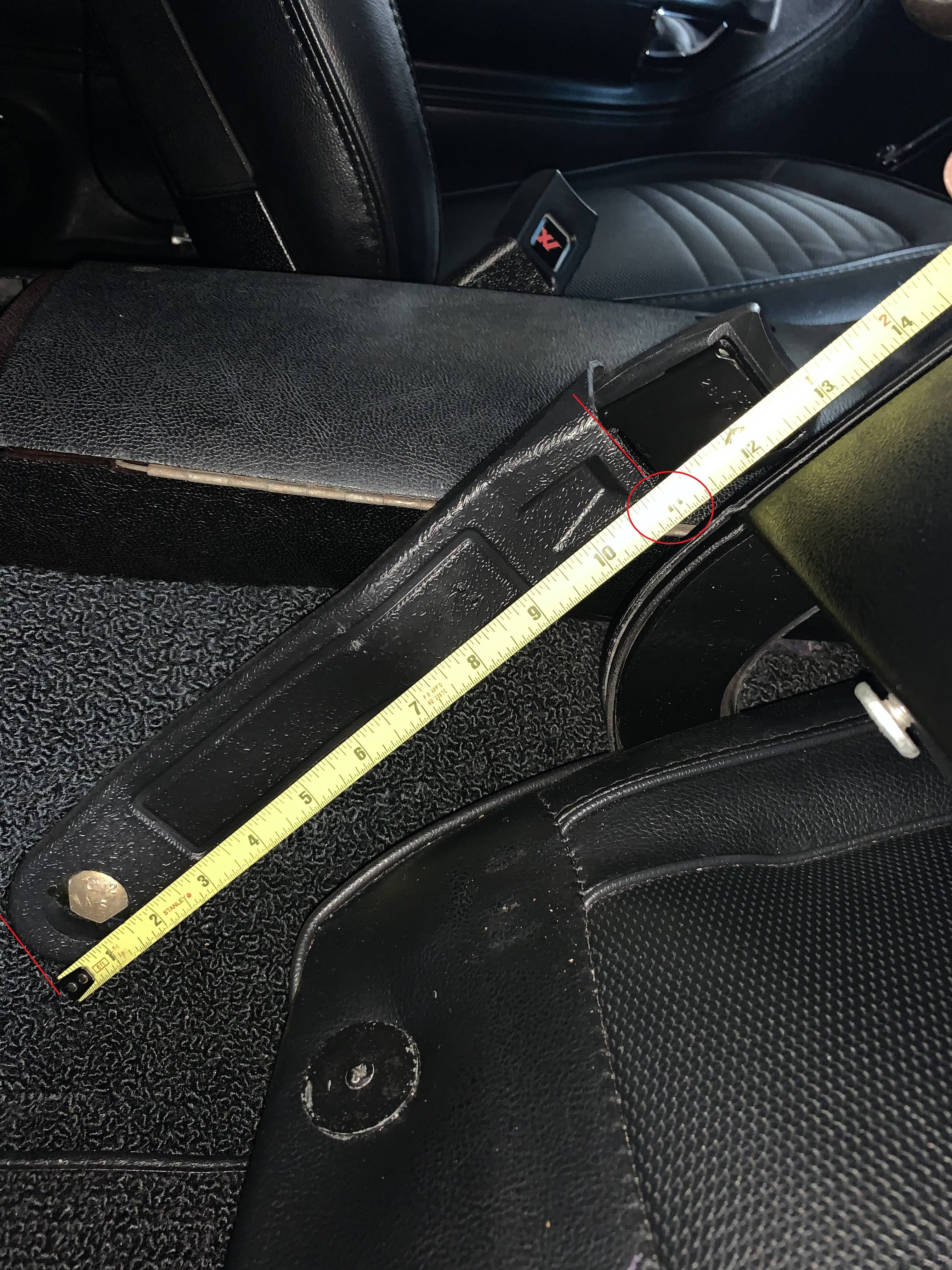

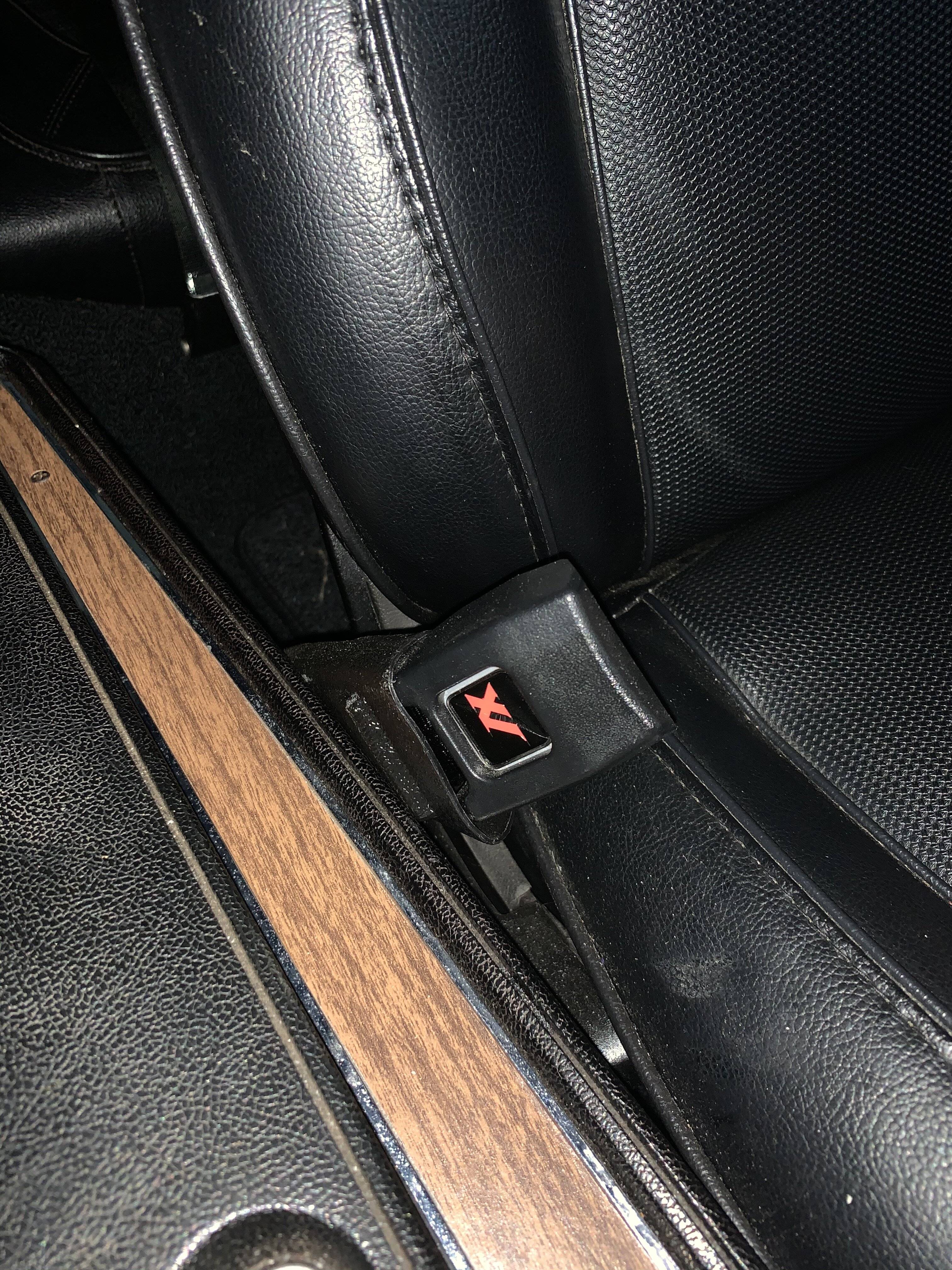

Thanks. I came across Wesco and XV Racing so far. I didn't dig into either site yet.

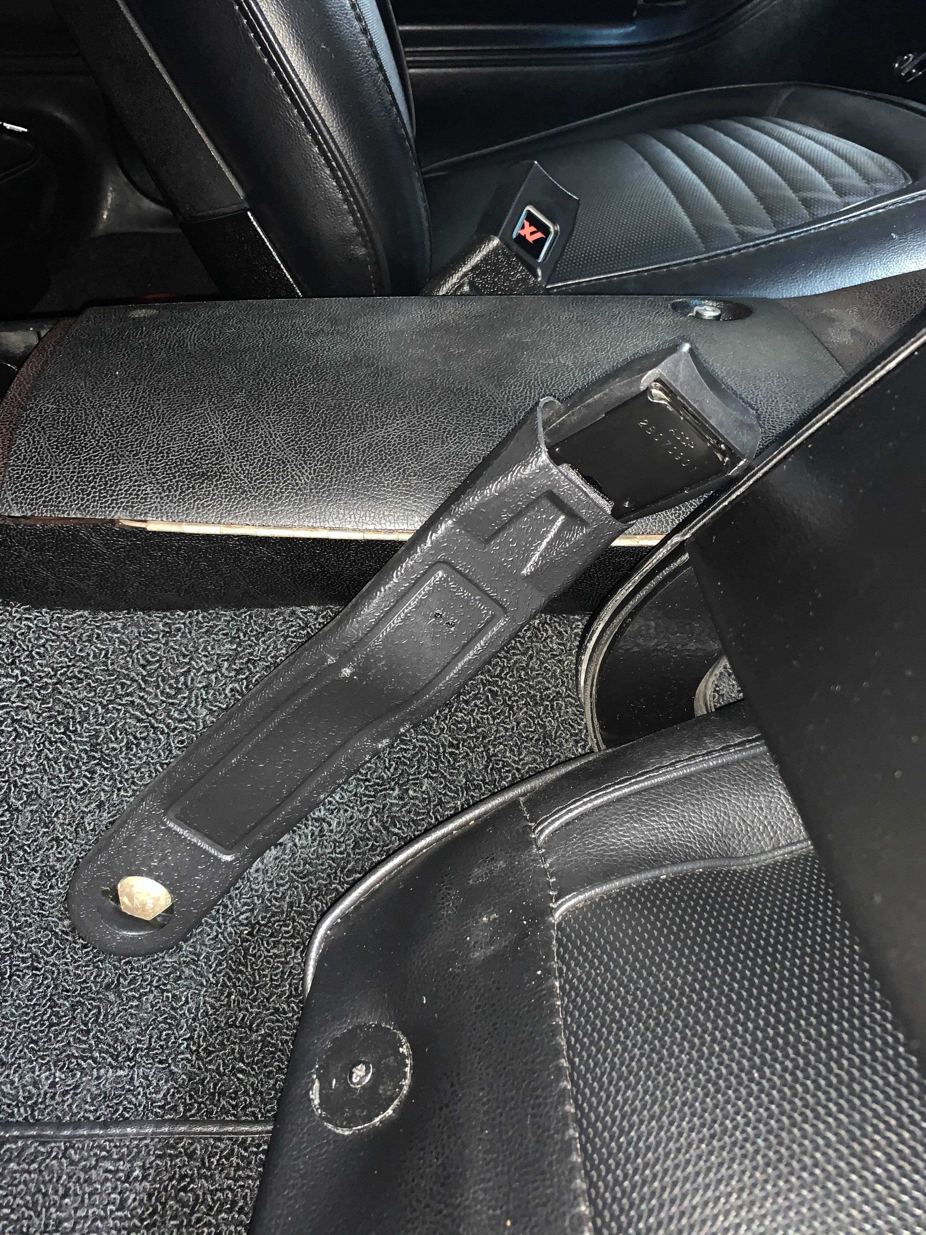

Now I'm a bit confused because the XV belts actually appear to be shown in a few of your images. Are Wesco & XV the same company?
XV Racing Products 3-Point Retractable Belt-Bucket Seats- Black
XV sells the Wesco belts re-branded with their logo. I gave XV a call first in support of a Mopar vendor and they gladly matched the Wesco pricing.
XV confirmed the selections for size, etc. I put together the photos a while back when others wanted to go to 3-point shoulder belts.
I put safety ahead of correctness for seatbelts. I also have a set of Snake-Oyl-restored 1970 E-body seatbelts that are gathering dust. Spent over $500 for them.

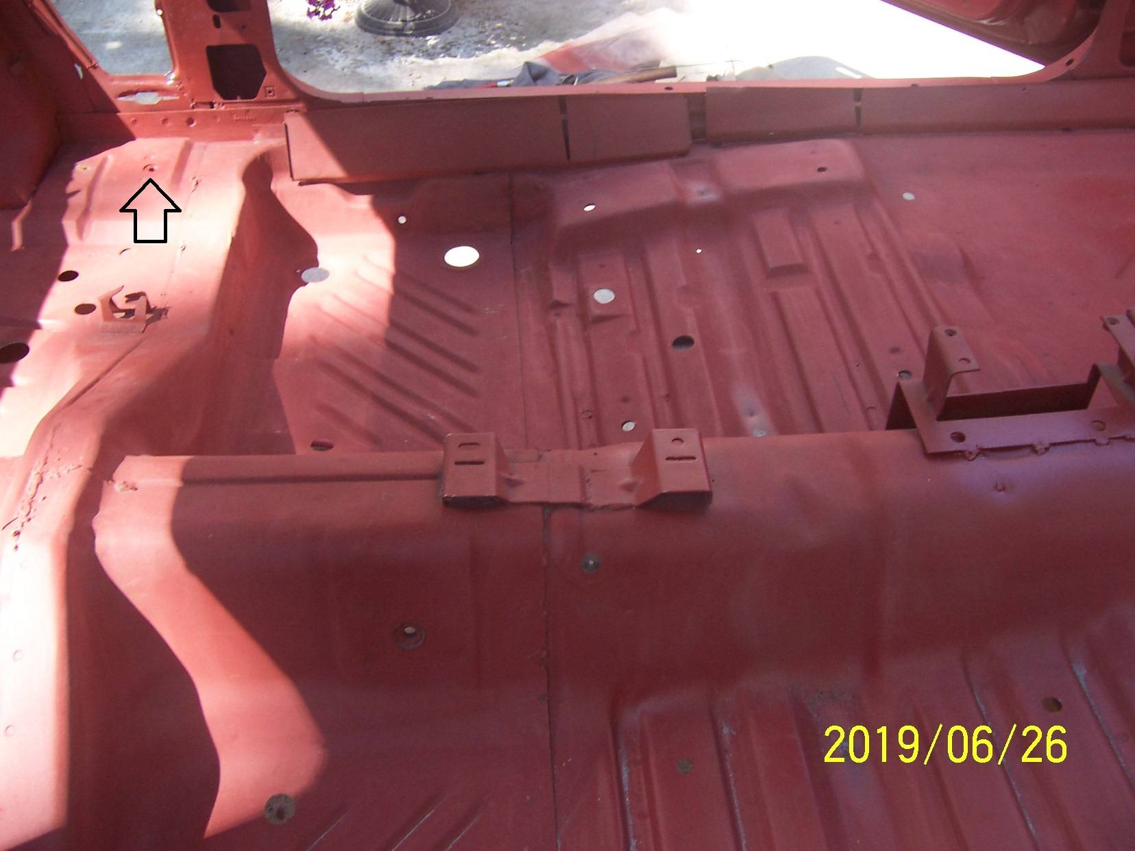

I had been looking at these:
3 Point Retractable Seat Belt, 12" End Release, Wired Option, Select Color
for my 1974 project. From the dimensions they show the retractor will fit under the rear seat inner panel.
They offer the wired buckle to maintain the warning system - mine is a Canadian car so no starter interlock but I would like to keep the warning system.
Down side is the cable buckle and the top release button not ideal but cable is hidden...

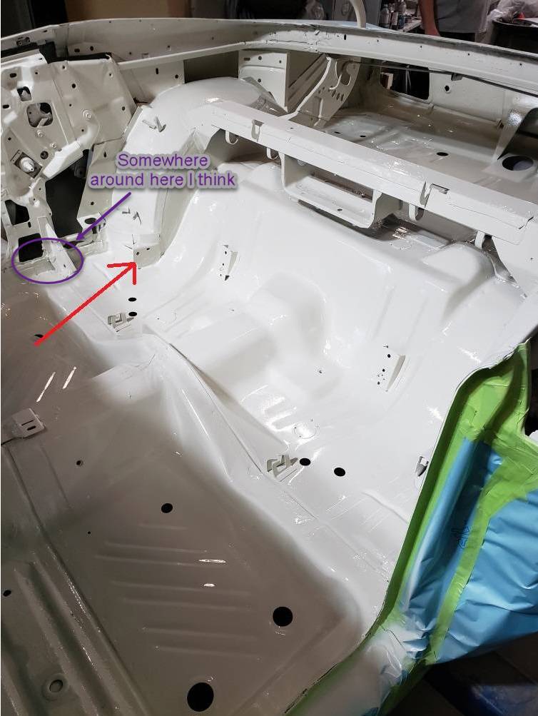

Hey Moparroy,
I know this is an old thread but any chance you have some pictures of the mount points under the rear side panel? I have a 70 and was thinking of adding the 74 style 3 point belt. I know there are easier kits out there, I just like they way these look.

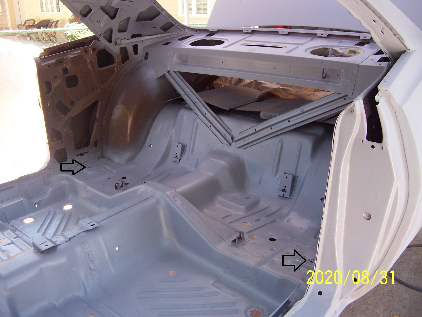

Here's the rear left mounting point behind the plastic interior side panel.

Thanks for the quick reply, but isn't that for the rear seat belts? I was hoping for the location of the rewinder for the 74 3 point front shoulder belts.

moparroy
Dec 25, 2020
125
61
Rockwood, Ontario

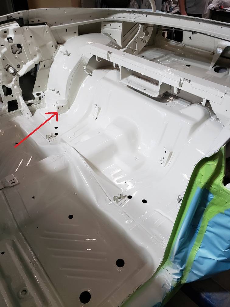

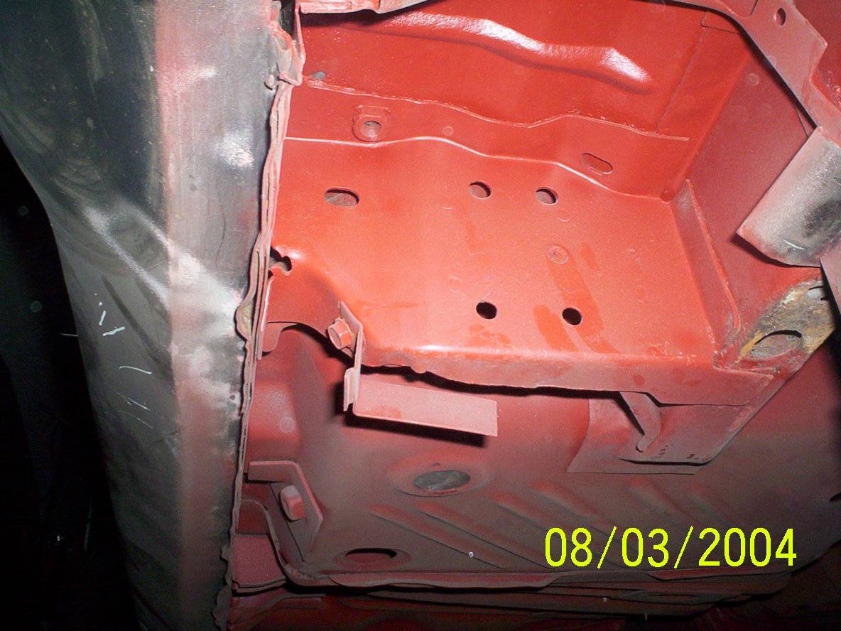

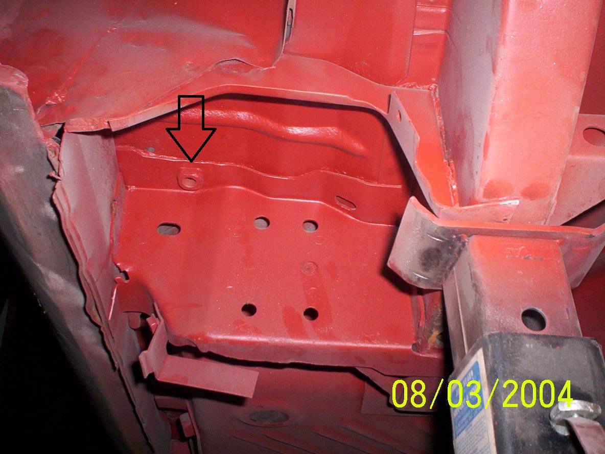

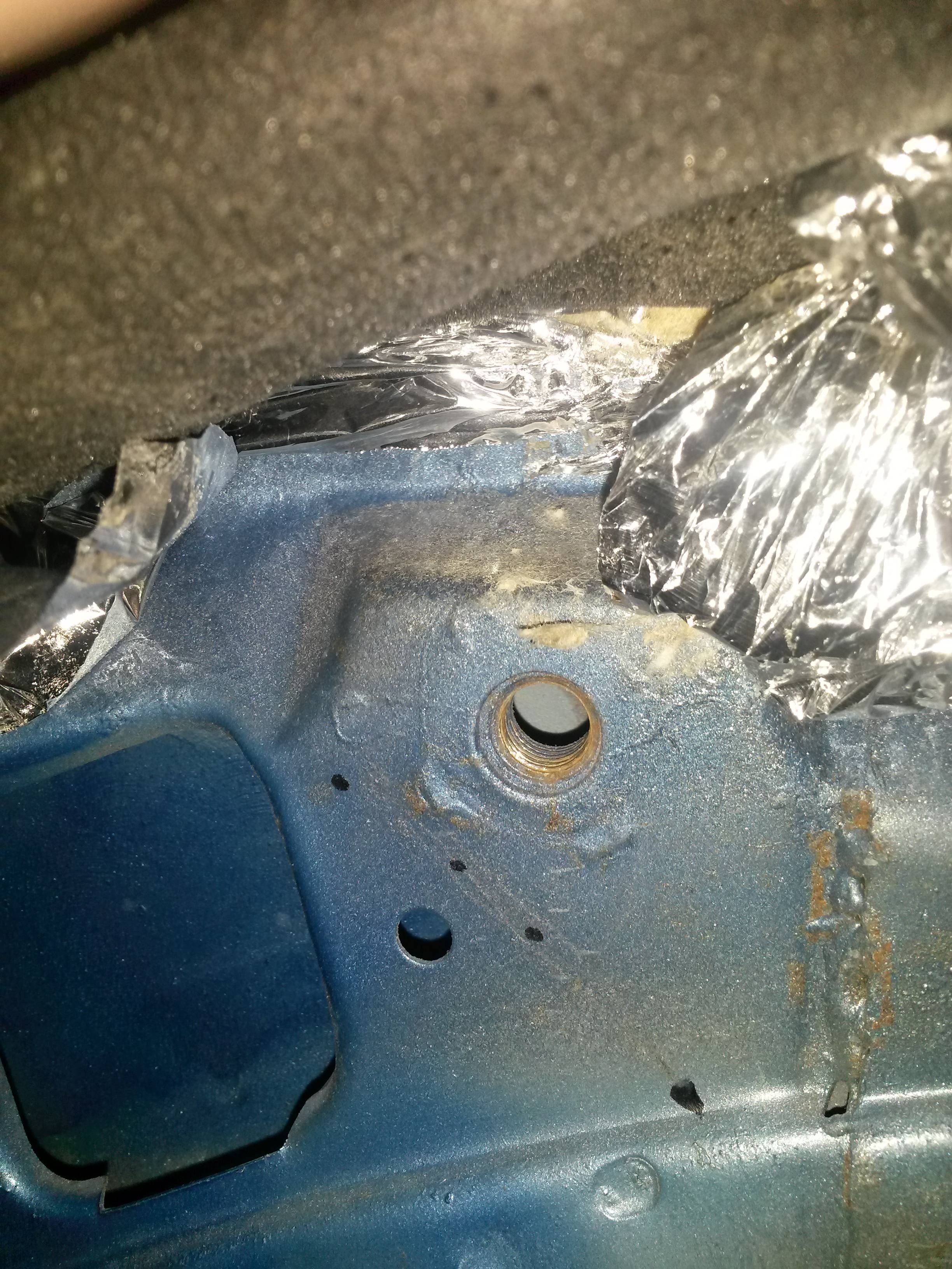

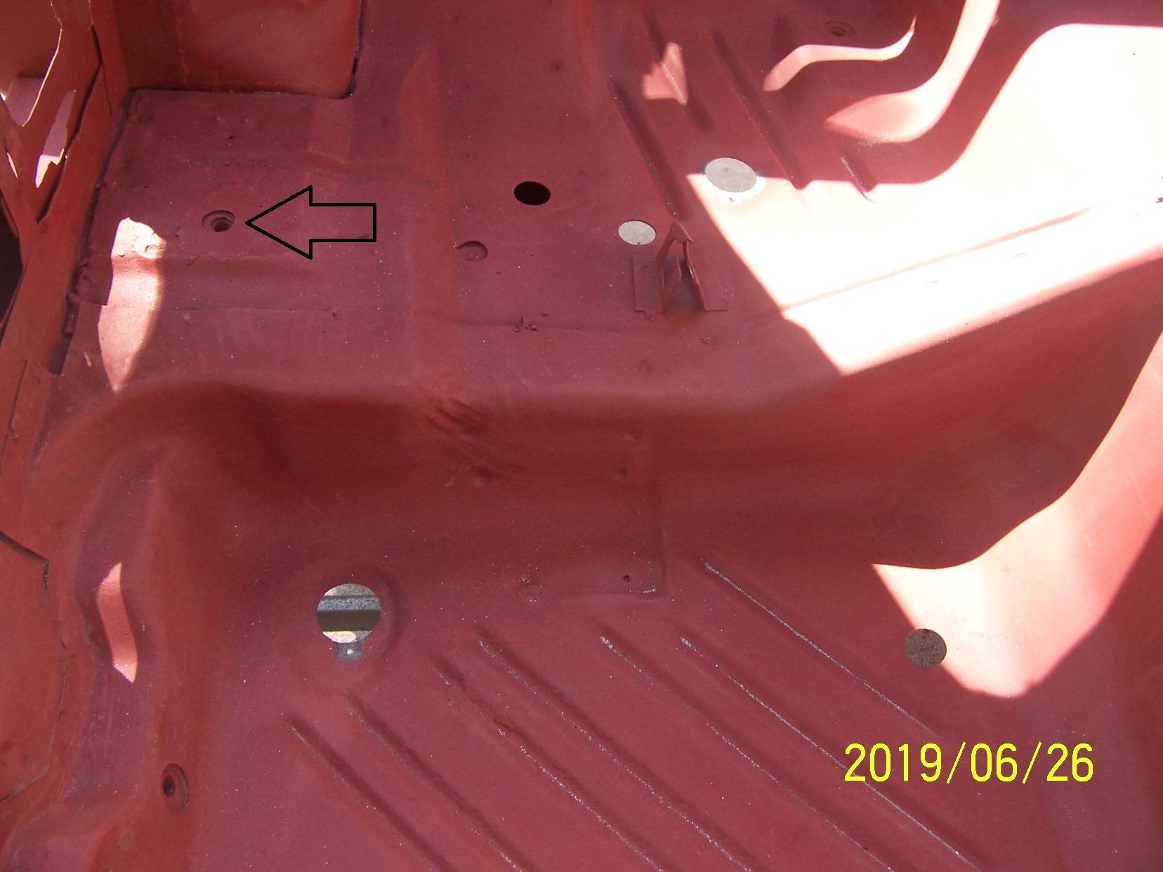

Let me take a look at what I have in the pics I took during various stages of that area. Carpet is now installed - I can still take pics of that area - but I have also installed sound deadener in that area so older pics might show it more clearly. The 3 pt harness behind the front seat attaches through the floor to a weld nut that is welded onto the top of the front leaf spring bracket. I know this well as I had to replace the passenger side front leaf bracket and the bracket I got did not have the nut on it so I had to fashion something to look OE. That under pic might help you too. Going through the floor with a right angle bracket on the retractor is a very different set up than the pics above.
BTW I discovered the wired buckle on the aftermarket product I said I was looking at above was the wrong switch type (NO / NC) for the OE seat belt warning system which I wanted to preserve. I ended up reconditioning a set of belts from 2 sets that I had - turned out the original set was not that bad except the passenger side belt was damaged and replaced with something different in the same event that damaged that leaf spring mount. I don't have them installed yet but they seem to work ok out of the car.
moparroy
Dec 25, 2020
125
61
Rockwood, Ontario

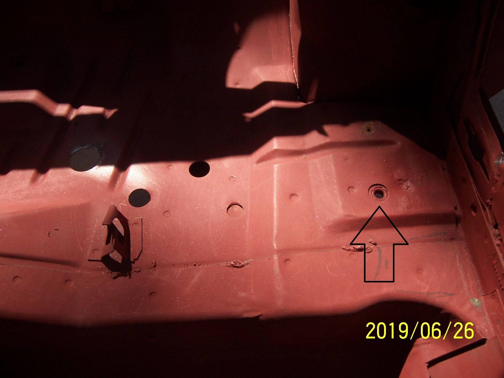

See if these help - couple shots of the bolt holes from the top and a couple shots of the anchor nut underside on drivers side
