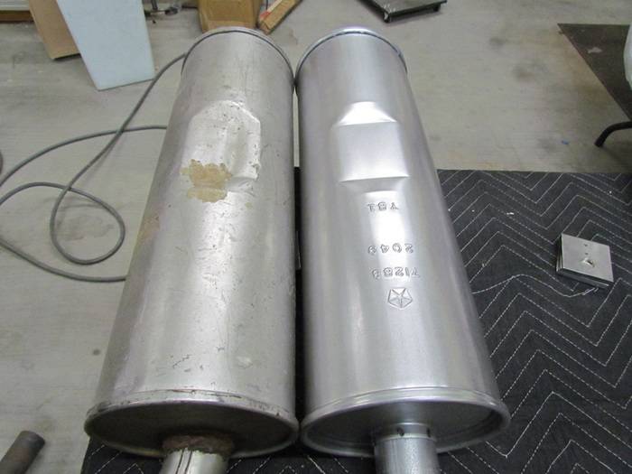

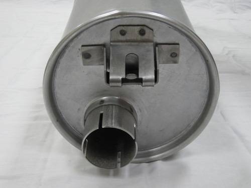

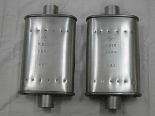

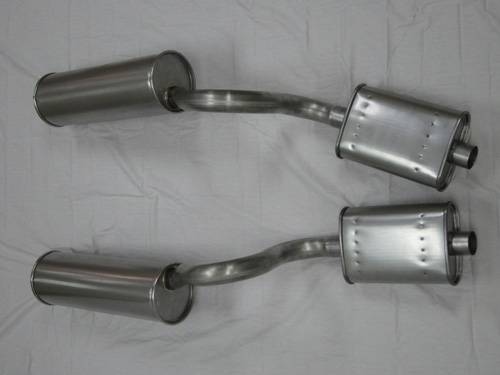

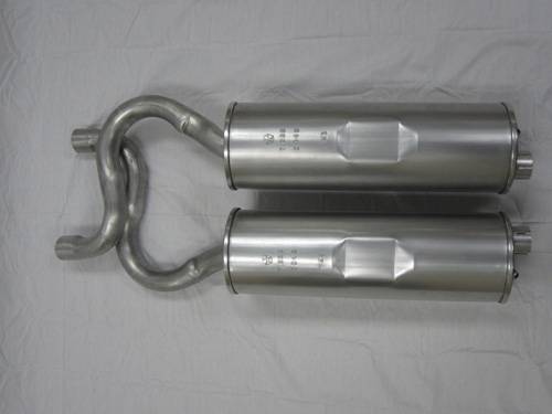

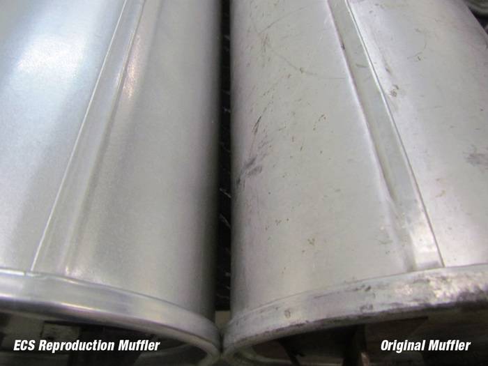

Anyone have any thoughts on what exhaust/mufflers would sound very close to factory exhaust for an E body?.....
moparleo
Oct 17, 2011
6,952
1,749
Mufflers with resonators like those shown, if you want stock sound. Don't forget the tips, they have the final effect on the exhaust sound. think of them as the bell on a trumpet. The bigger the opening the louder and lower the exhaust pitch.
