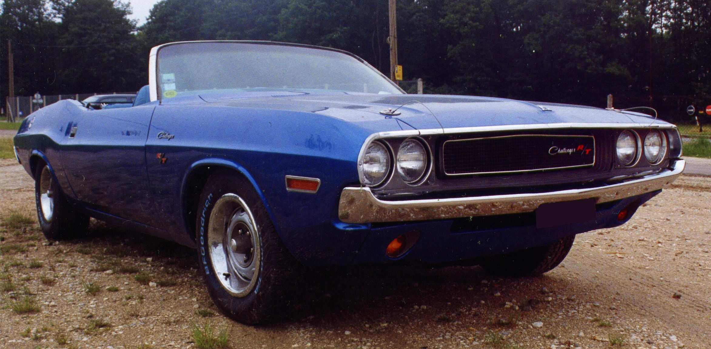

Hello to all Mopar aficionados.
Ater nearly 10 years, I'm back to working on my cars, especially the 1970 Challenger convertible (restoration started 10 years ago).
Engine and trans are done and assembled, rear-end is done, interior and upholstery is mostly done, and I'm meeting a bodywork/paint guy tomorrow.
I'm researching the primer/overspray/blackout info right now.
Thanks for reading.

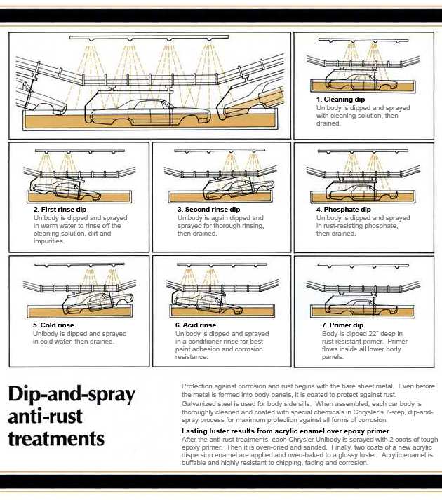

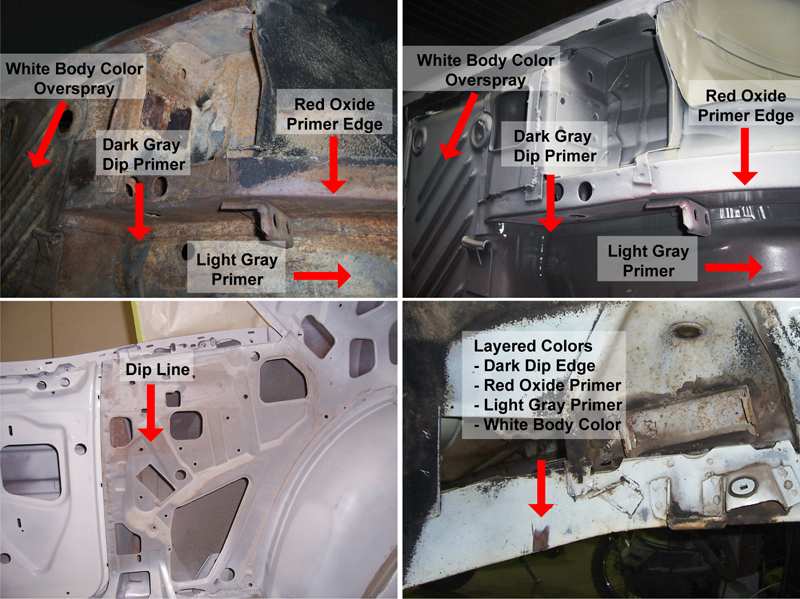

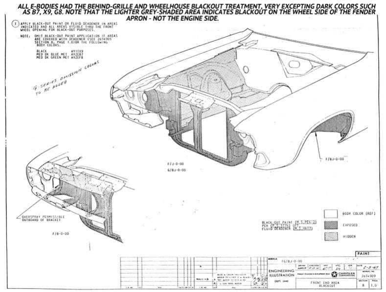

Thanks for all the replies, and the Chrysler paint process pics. I already hads the engineering drawing of the blackout scheme, but the other pics are new to me.
