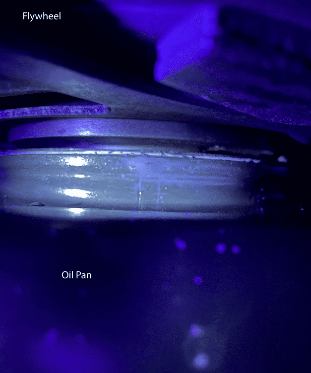

They are known to leak if not assembled correctly. start by checking the rear main seal,can you see oil anywhere?
I think so. It didn't glow back at me with UV light but here is a picture of what I found after wiping it and driving.

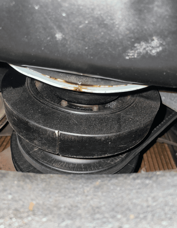

Thanks everyone. I called the mechanic and told him it's still leaking after 7,000 miles. He told me to have a shop closer to me look at it to find the leak and to make sure they take pictures so he can see if he'll have to warranty the assembly. I'd really like to find the leak myself so I don't pay for a shop's diagnosis.
I washed and wiped the engine cases. Then I tossed in a little bottle of UV dye into the engine fill hole of the driver's side valve cover, washed it down with an ounce of clean engine oil, and I took the car for a 22-mile drive. I brought it back and turned all the lights off in the garage. I looked over the whole engine with a UV light and I couldn't get anything to glow back at me. The top and sides of the engine cases were all dry. I went underneath and found a leak on the front of the engine under the crankshaft pulley. I took two pictures of this area spaced 3 minutes apart and attached them below. Notice the increase in drop size. I then saw something else on the rear of the engine by the bell-housing/flywheel which is shown in the last image attached below. Again, nothing glowed back at me under UV light so either these aren't engine leaks or the UV dye didn't fully mix after 22 miles. Where do I say the leak is coming from?

The one at the front appears to be the sump gasket leaking.
The one at the rear could be either the rear main seal or the sump gasket. It is very difficult to work out which one it is.
Could it also be the front main seal?

The front seal is in the timing cover - up above the sump seal if you get my meaning. Your leak appears to be between the rubber lip of the sump gasket and the oil pan.

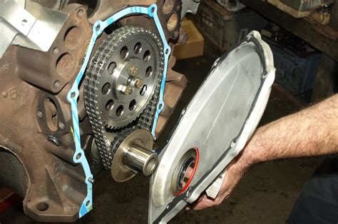

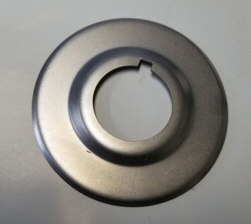

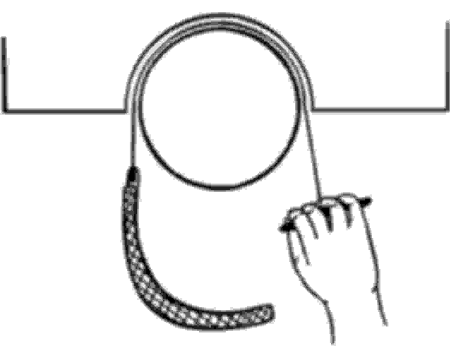

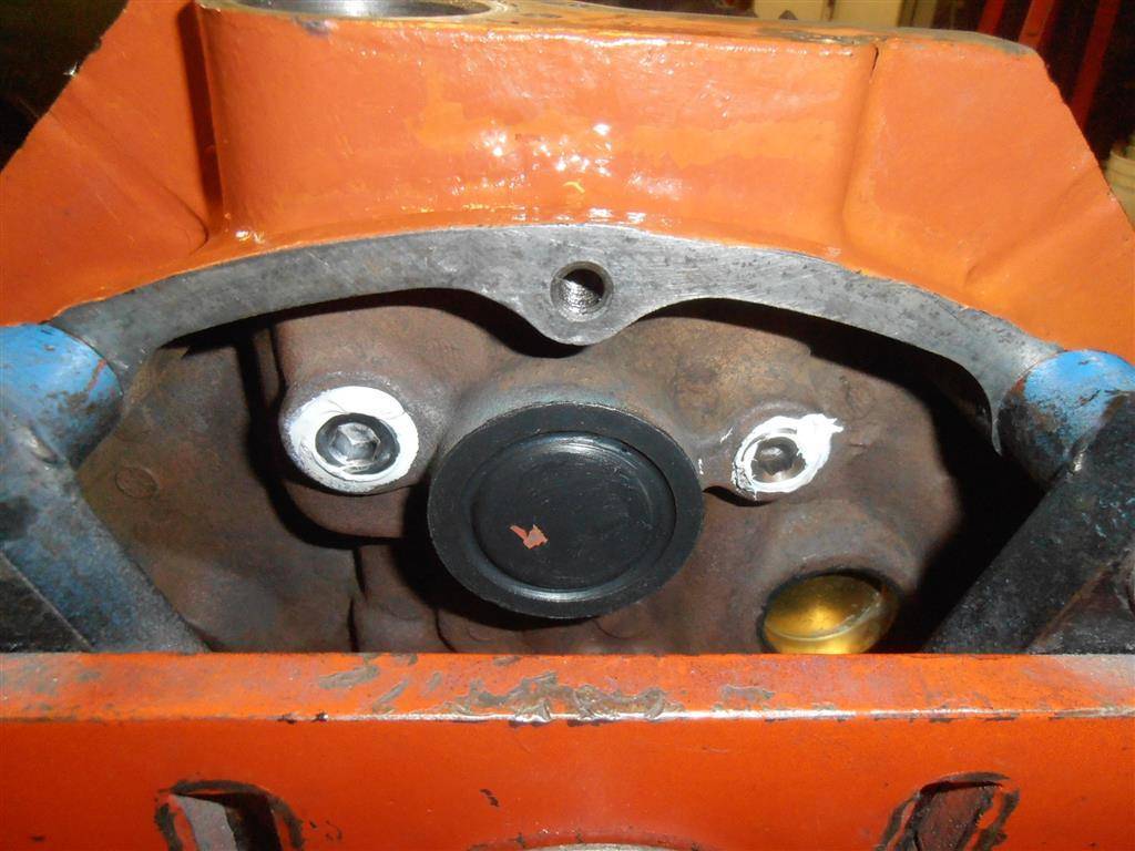

Don't know what you going find. Pictures of net. By chance did you see the assembly of the engine? Missing oil slinger? Rear main bad install? Sneaky Pete for in car install. oil galley plug leaking?Use a usb camera on phone to look.
Not saying it's the problem but not to be over looked
