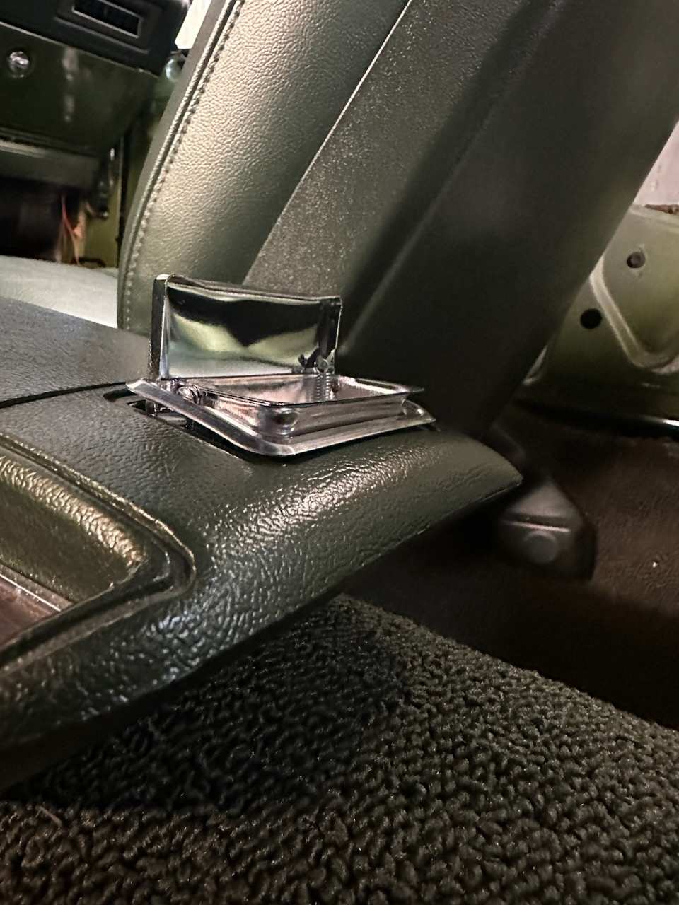

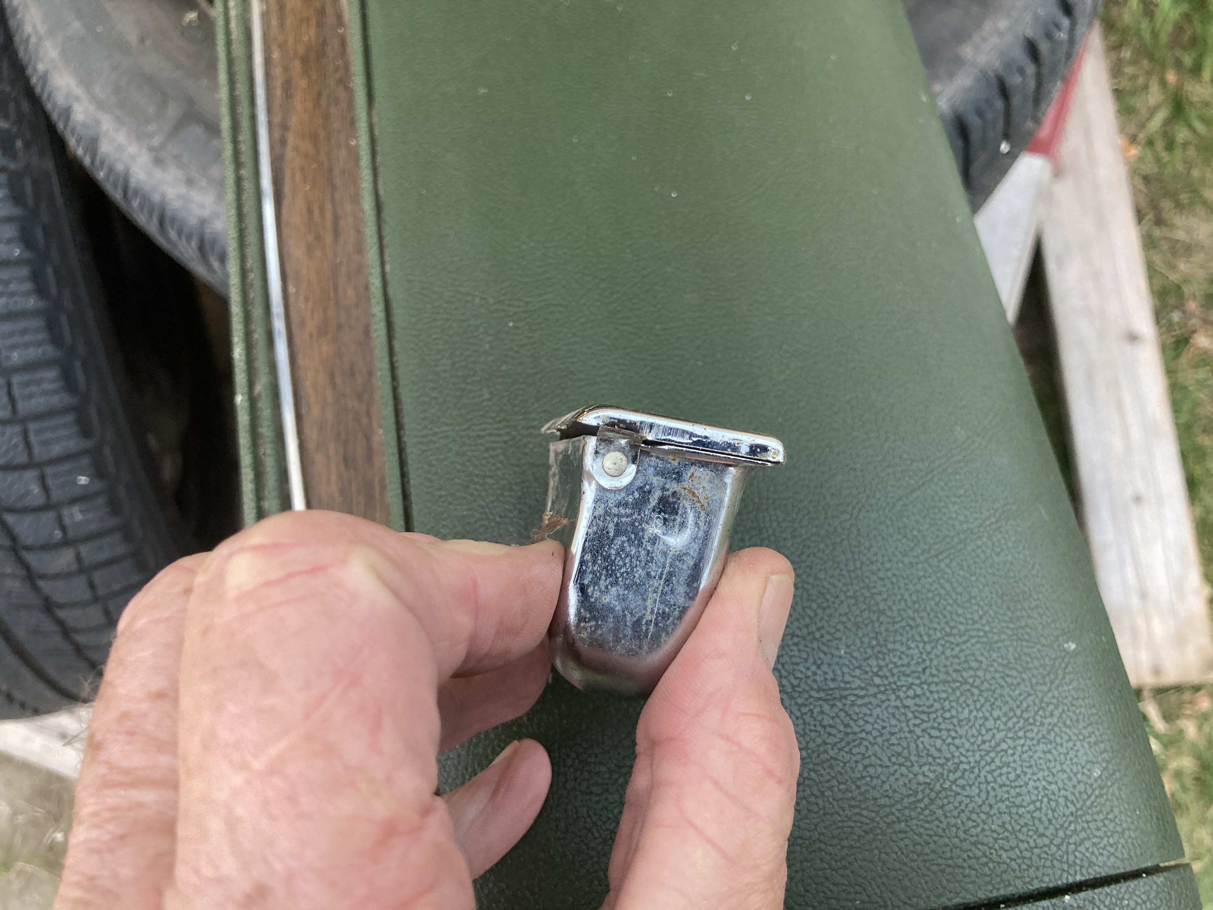

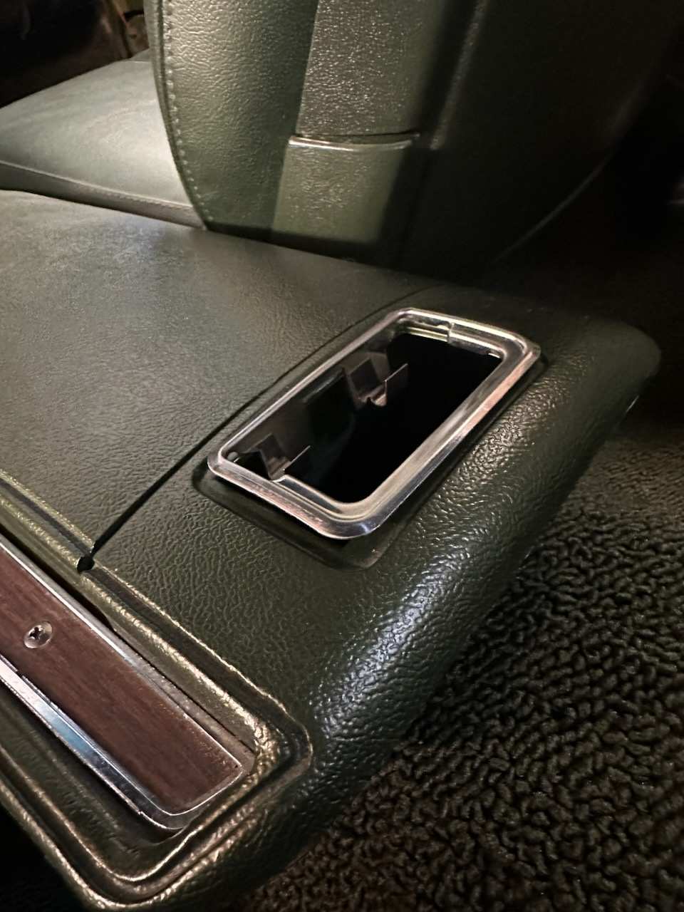

The fitment of the console ashtray is non existent. My console has a curvature, the ashtray and bezel from Classic Industries is flat as Kansas. What is the remedy for this?
Here's the look that I cannot present to my client in the photo's below. IMG_4129.jpgIMG_4130.jpgIMG_4132.jpg

Ask me, this is a curved item. It is not flat like these ashtrays it curves from left to right not from front to rear.

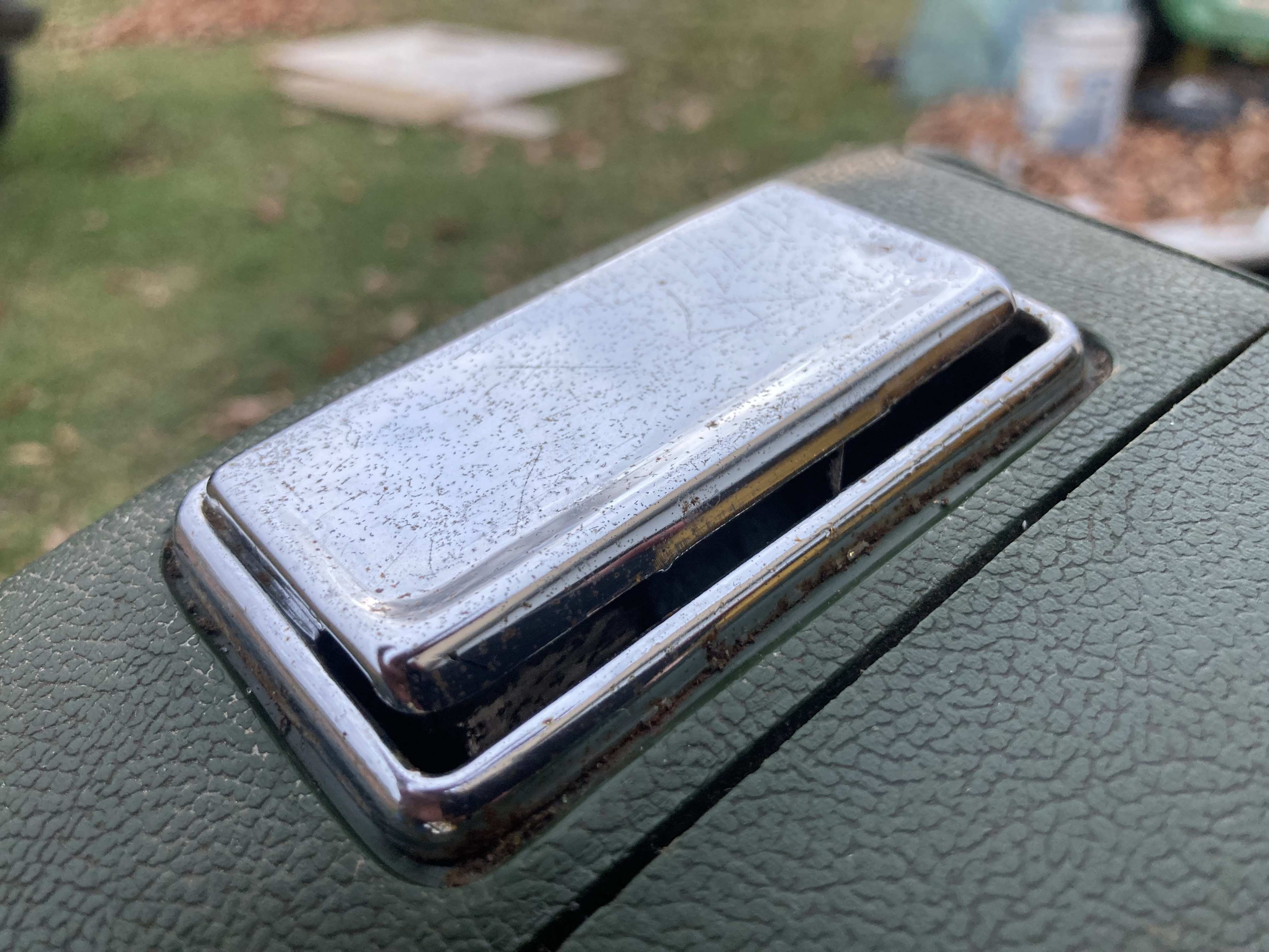

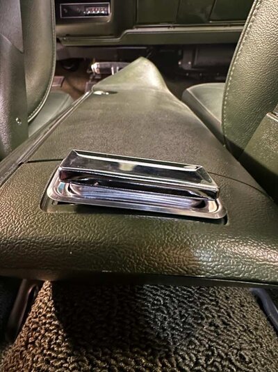

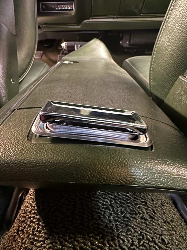

Just checked my ashtray and lighter in the console on my 72 Challenger, original and the console doesn't appear to have quite as much curve as you are showing, the ashtray bezel is mounted in the console and conforms to the very slight curve in the center section of the console but the ashtray insert is as flat as a die. I can post a couple of pictures later if it will help. It might help to install the bezel in the console and see how it conforms to the console or vice versa.

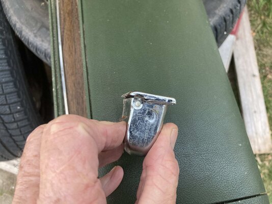

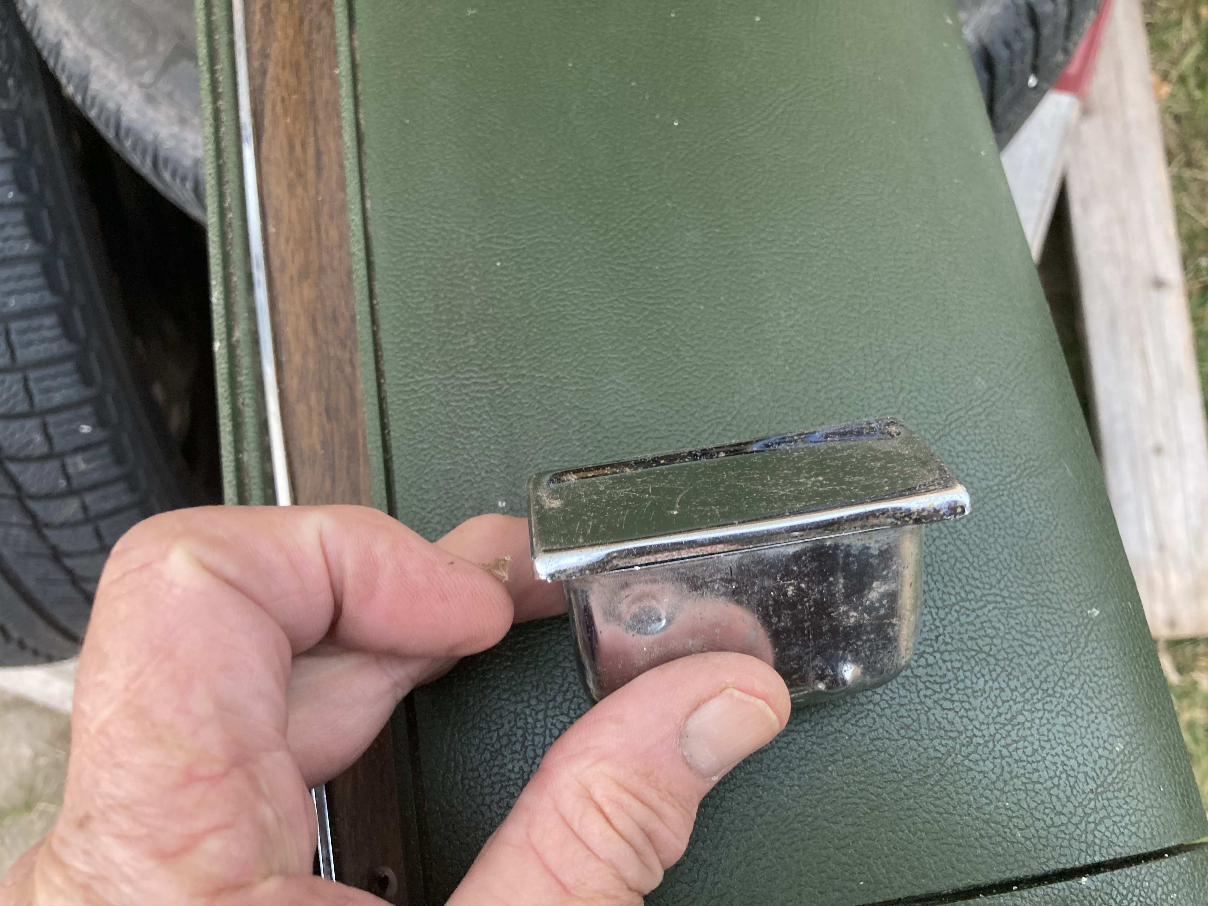

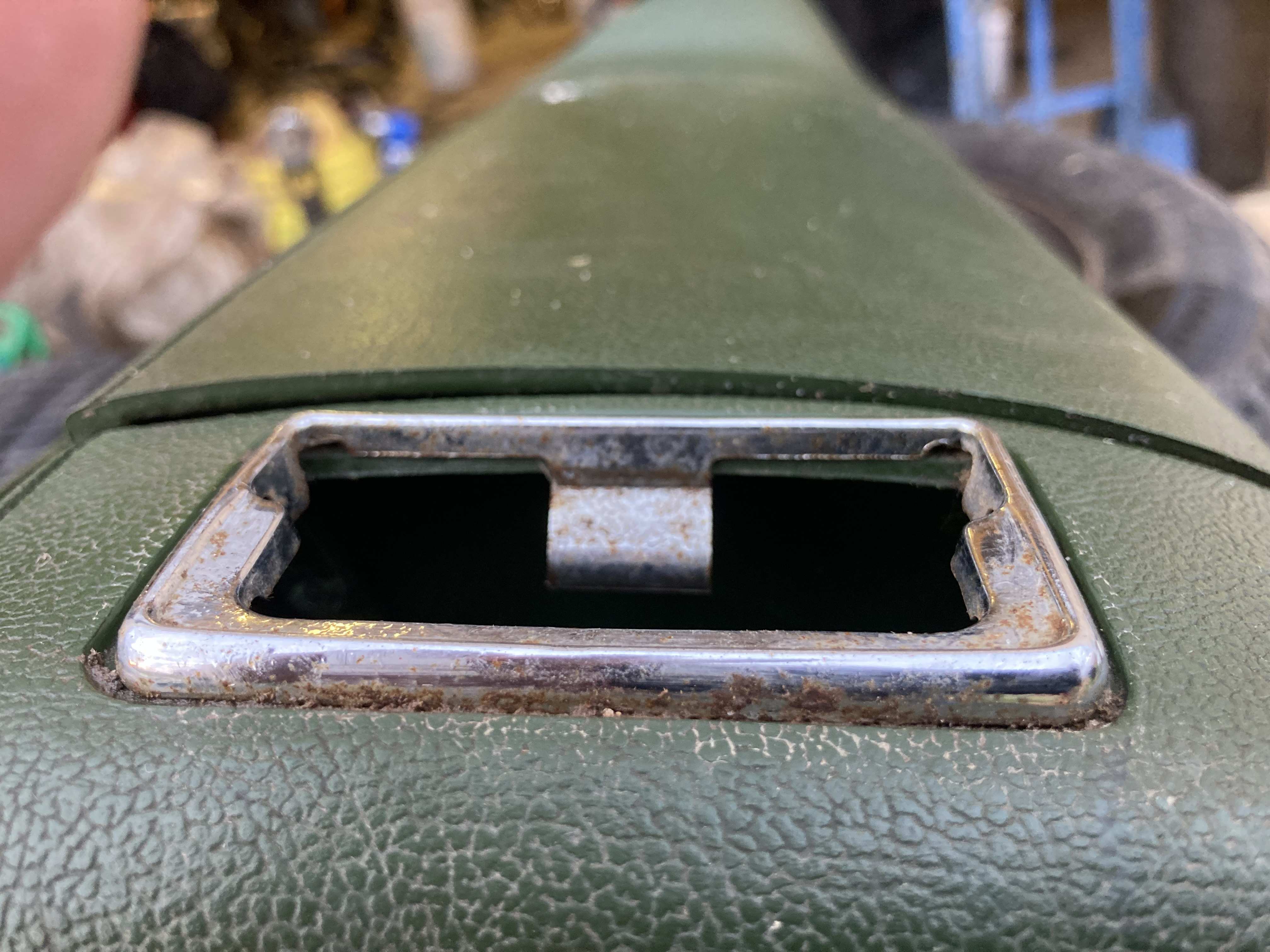

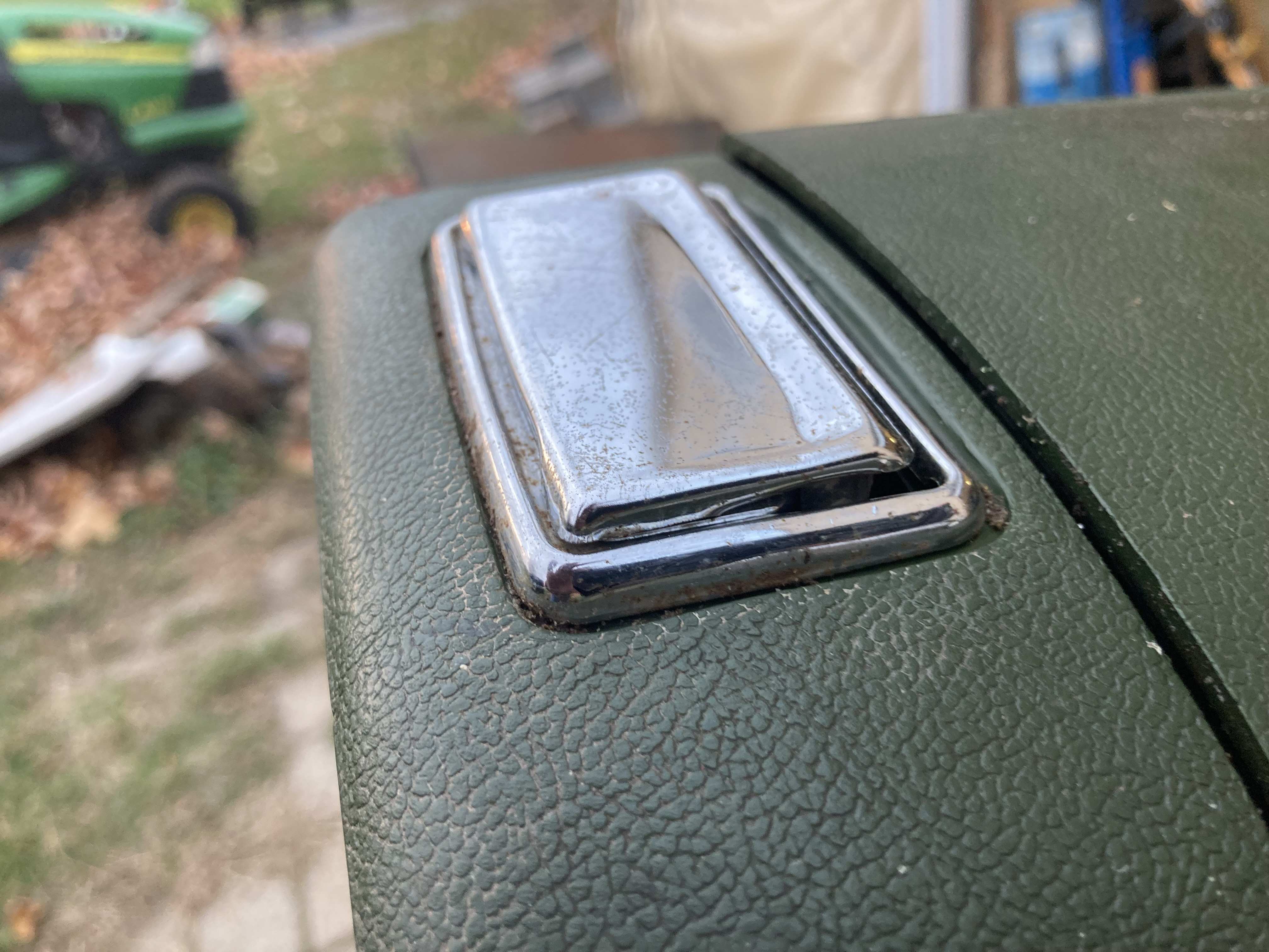

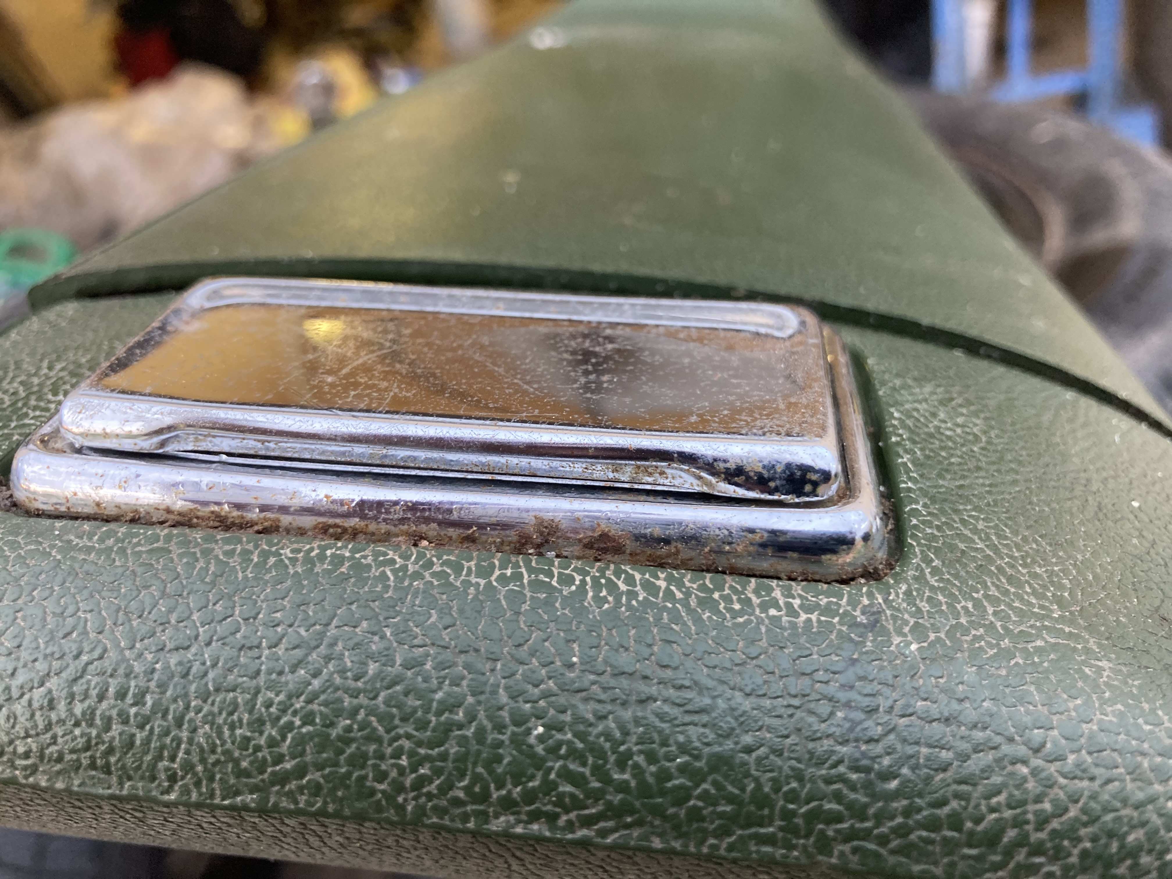

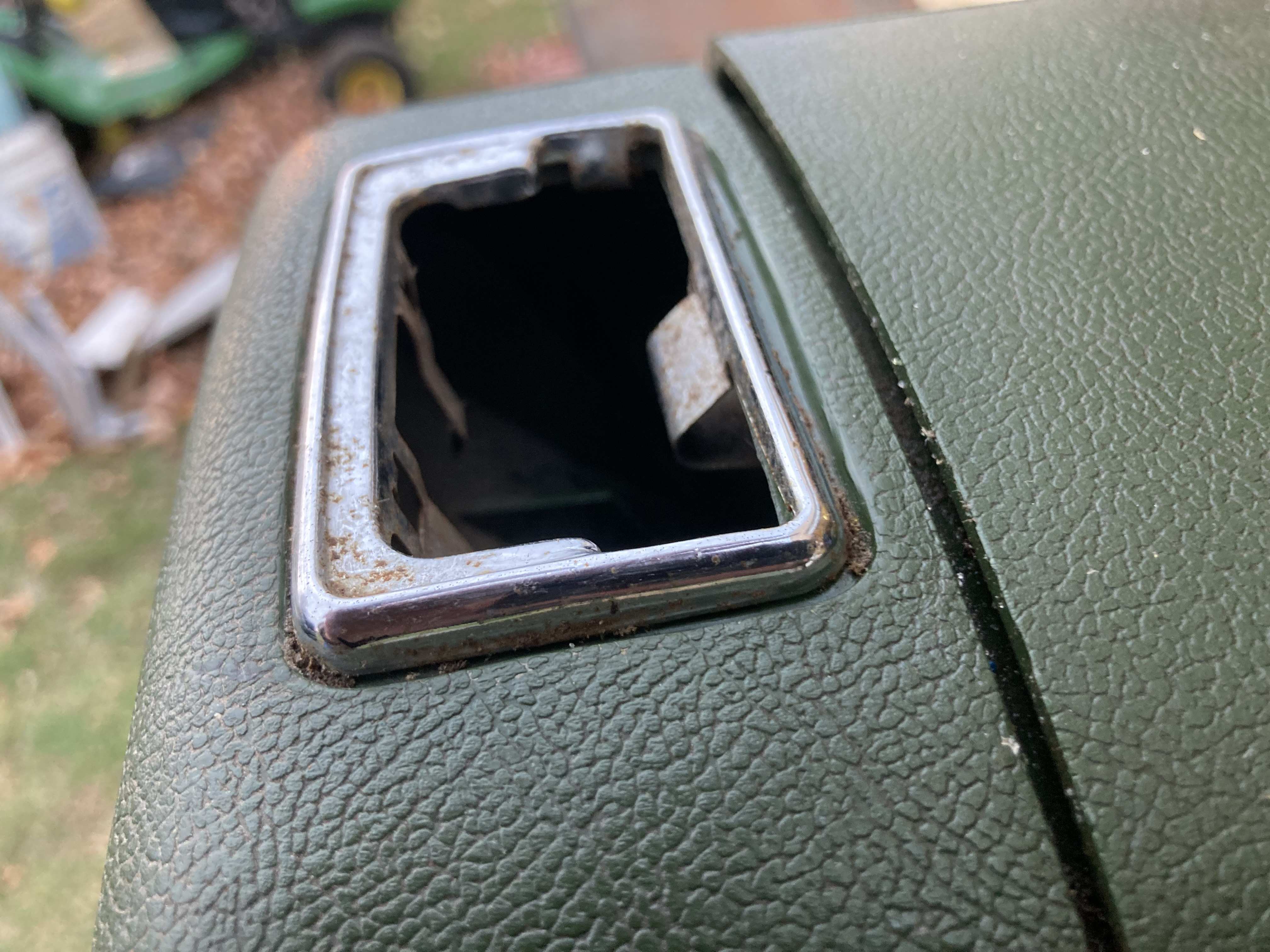

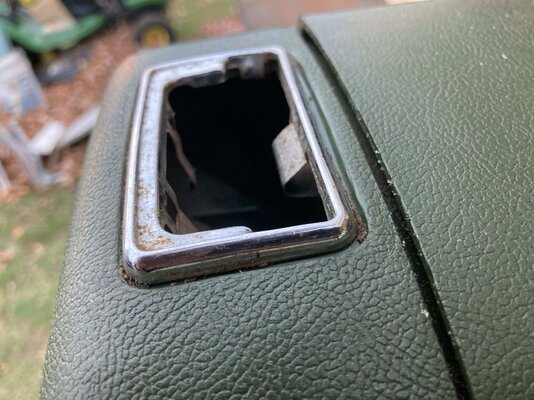

Well you are a ways off from me, I'm in Mount Albert Ontario, Canada. So bunch of pics coming. Bezel is fastened in the console with two tans inside on left and right sides.View attachment 114669View attachment 114670View attachment 114671View attachment 114672View attachment 114673View attachment 114674View attachment 114675View attachment 114676View attachment 114677
I am 18 miles south of Seattle as the crow flies in Deep South port orchard near pierce county line.
Hope these came through ok, let me know if you need anything additional. There seems to be quite a bit more of a curvature to the back end of your console. you may need to warm it up either by hot sunshine or a hair dryer or heat gun to relax the plastic a little to lower the center curve in the console.

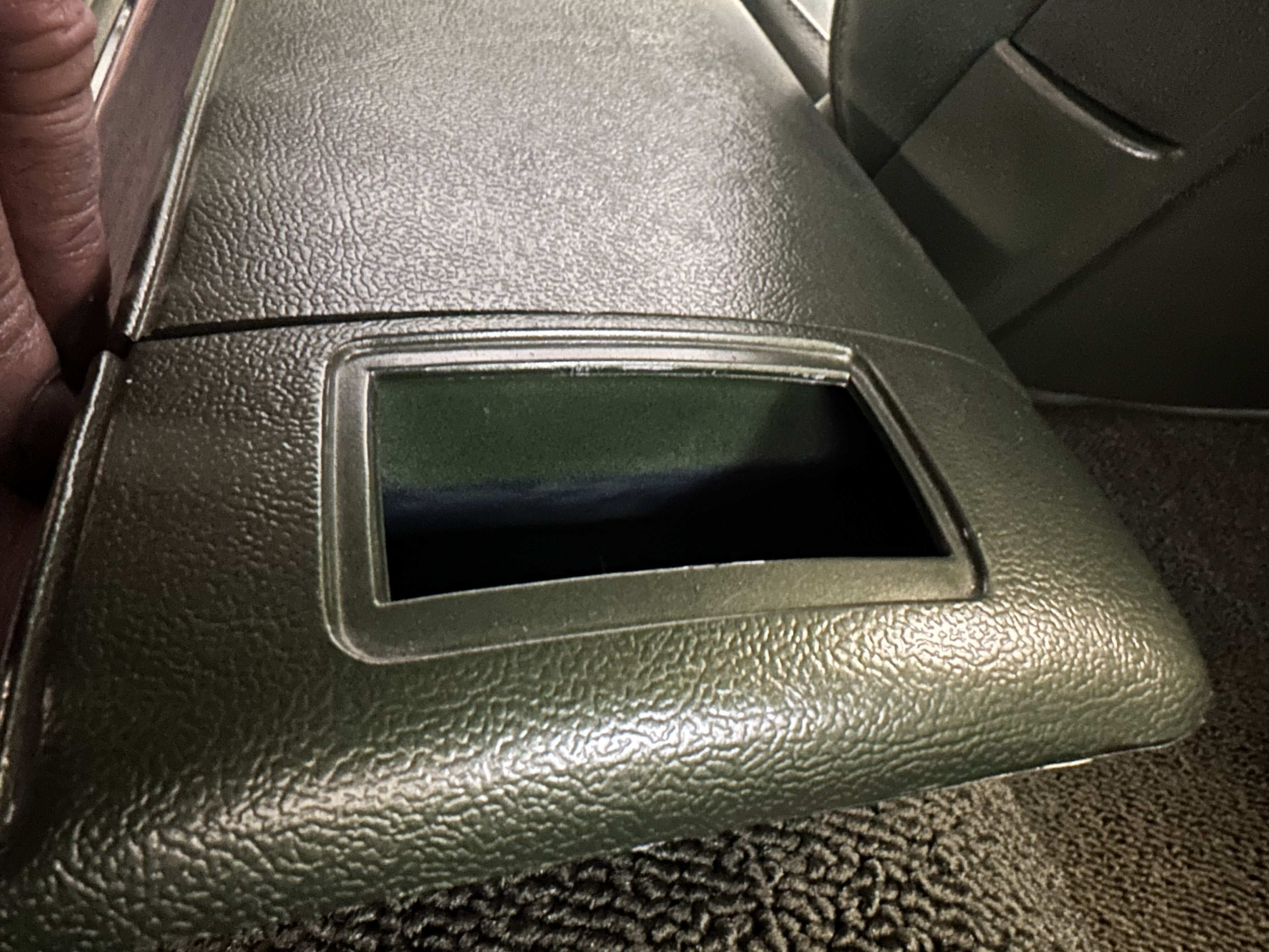

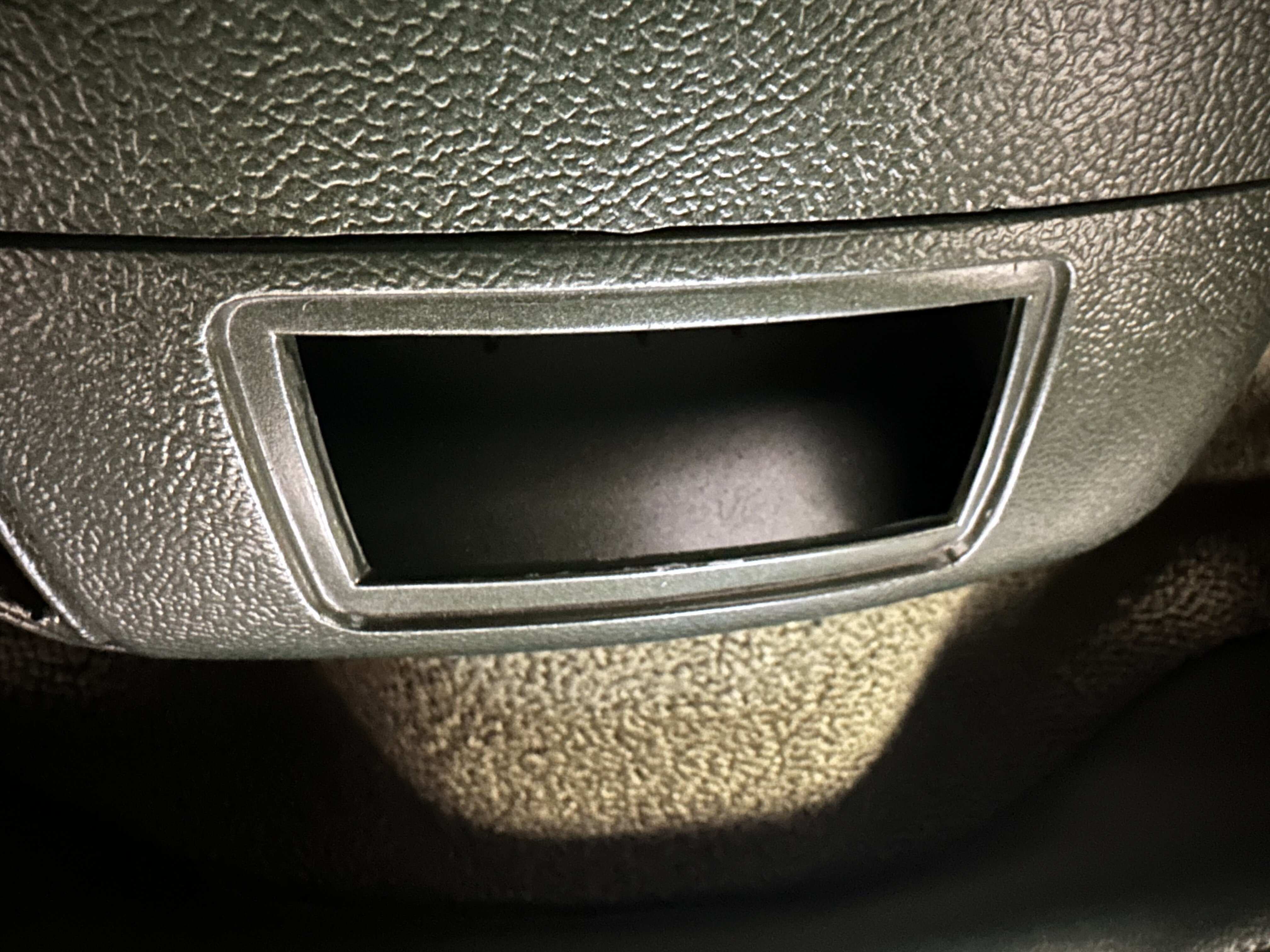

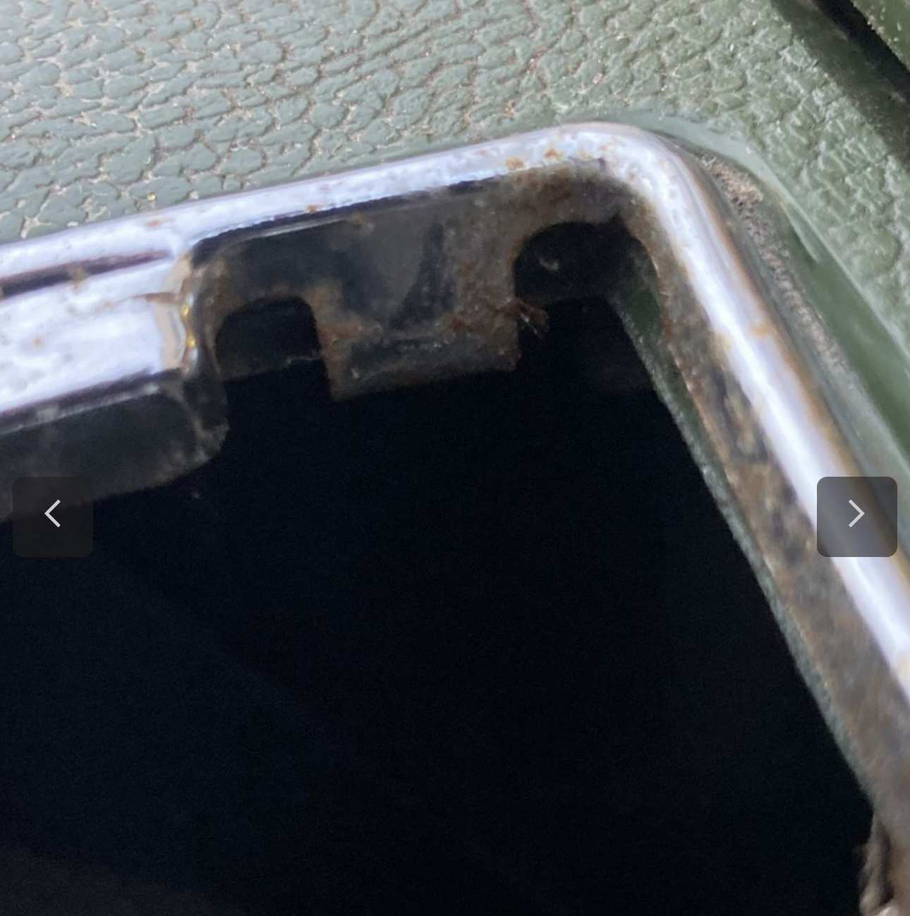

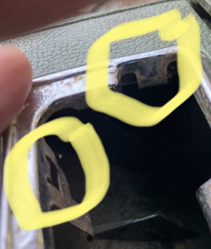

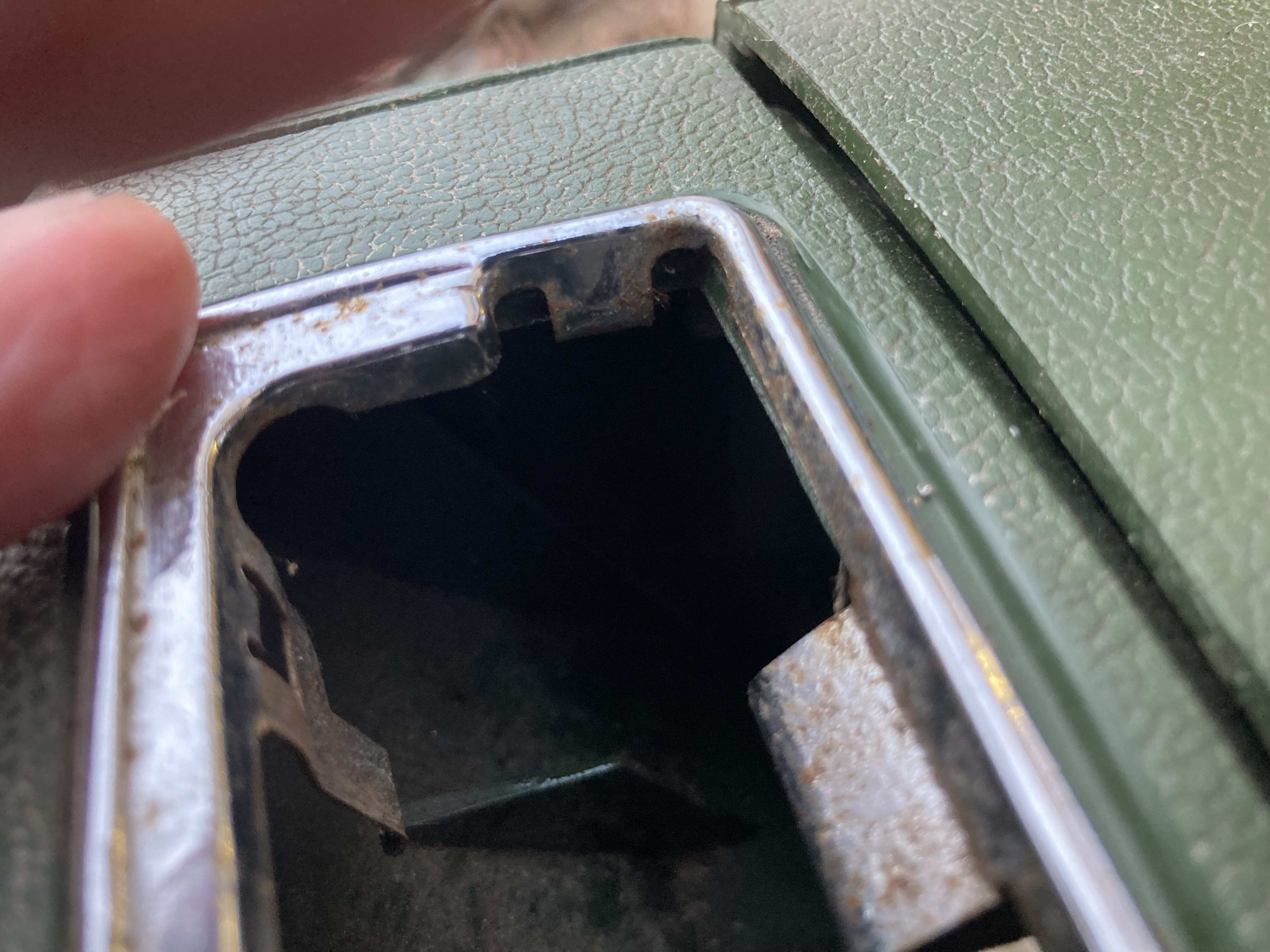

I’m out in my shop and I got the first set of pictures but not the second set. Is this the tab in my photographs that hold them into the console?
I will get you a couple of pictures of the inside edges of mine here in a moment.

I have a smooth edge to my console all around the square.
The part I got from Classic Industries did not have any tabs to bend over and hold it self to the console.

Yes there are short solid tabs on the short sides of the insert, the upper right one you circled . they are bent in under the recess to hold the astray surround/ receptacle in place in the console. The ones on the left center I believe are at the back of the console. Yeah well then there is no way to install the receptacle. I saw a couple of replacements that looked pretty correct one being from Year One and one from Herb's parts. They appear to have the proper locking tabs to secure the bezel in the console.
