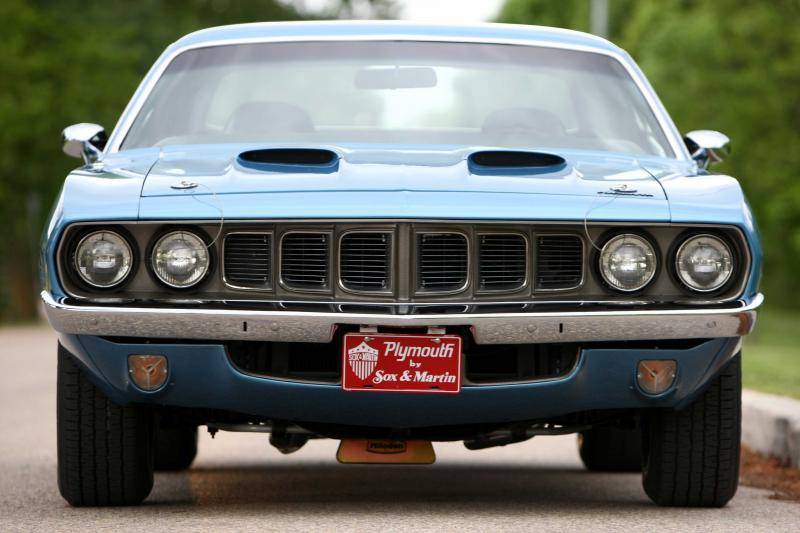

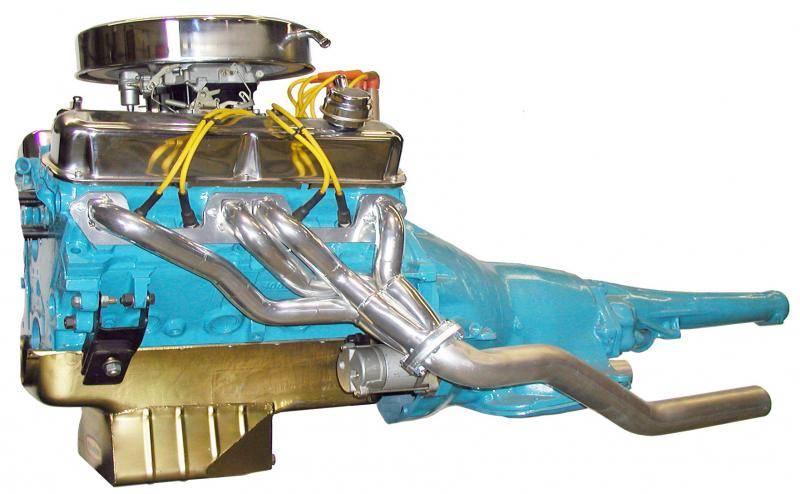

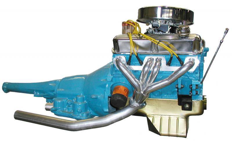

Welcome from Vermont (land of rough / dirt roads). If you don't mind loosing only a couple HP these shorty's from TTI look great. www.ttiexhaust.com . I purchased mine from www.robsrodshop.com . Another advantage with shorty's is it gives you more room to work. You can get to things like the starter without having to take the headers off. TTI is very high quality stuff. ttils.jpgttirs.jpg

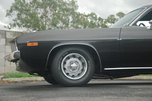

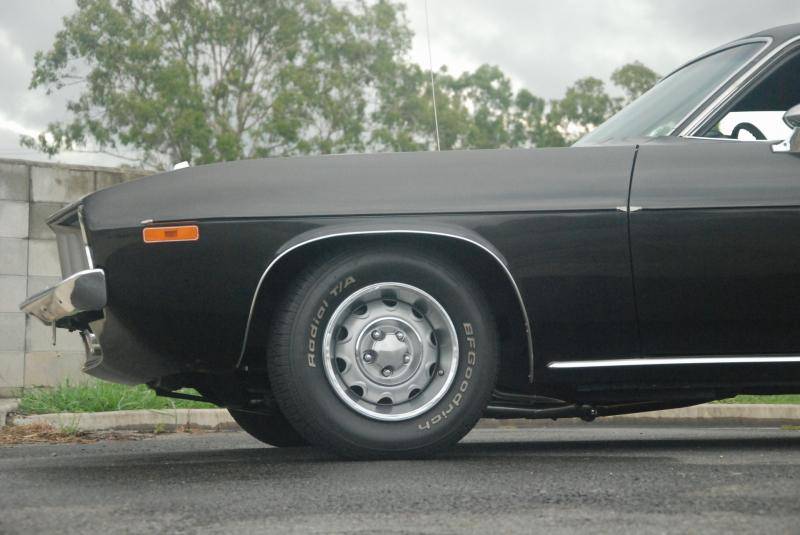

Think i will probably pop some TTI 1-7/8" RACE HEADERS on and hope i don't encounter to many fit problems that burn through my wallet, I tried playing with the torsion bars today tightened them by 5 turns and it looked like it raised the front 50mm so i went for drive around the block and check again and the suspension had settled and the height clearance looks the same as before. Feels like the front suspension being so soft is part of the problem, there is a lot of travel when i push down compared to other cars maybe its better to spend that money on new front suspension setup...?
