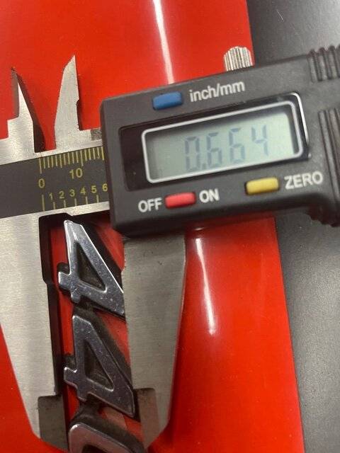

Hi everybody, looking for some help here... Does anybody know the exact dimensions of the hood emblems on a Challenger? (440 six pack specifically would be nice), but I really just need to know the height and how thick the actual emblem is. I'm 3D printing some custom ones and I don't have any on hand right now.

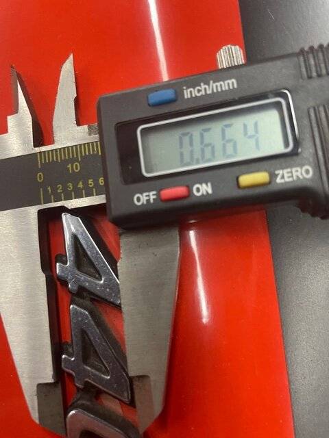

They are different heights, the "440" is one size and the "SIXPACK" is another. I will measure mine and like you know.
70chall440
Dec 11, 2010
1,260
981
Western Washington

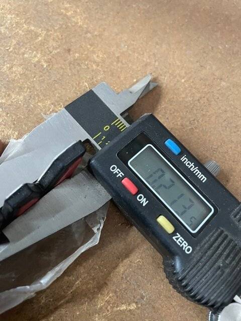

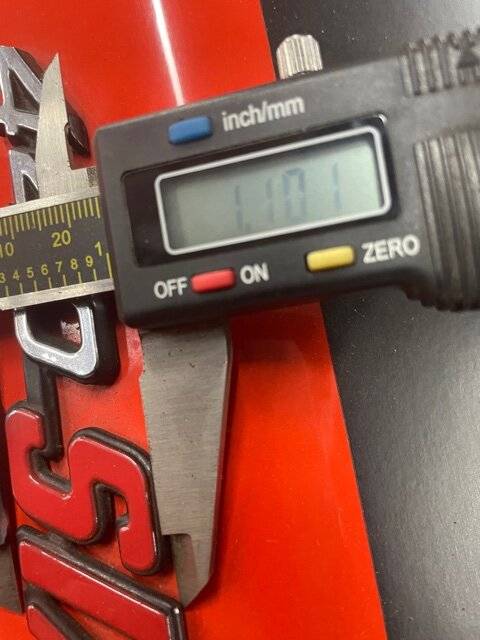

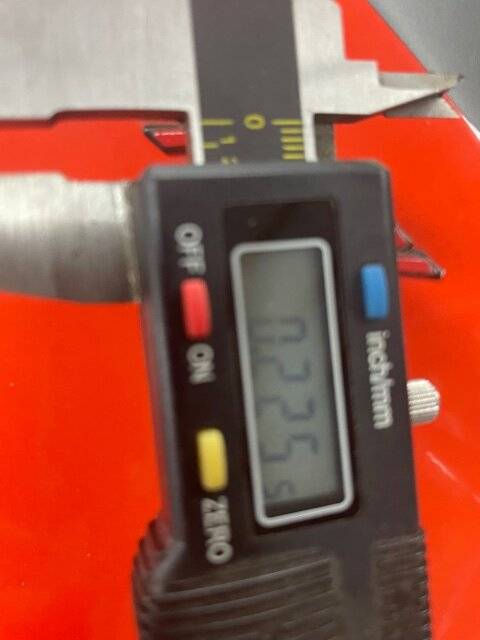

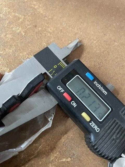

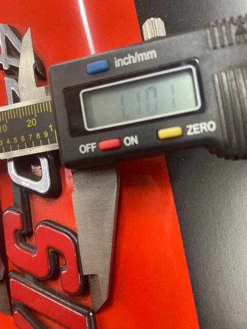

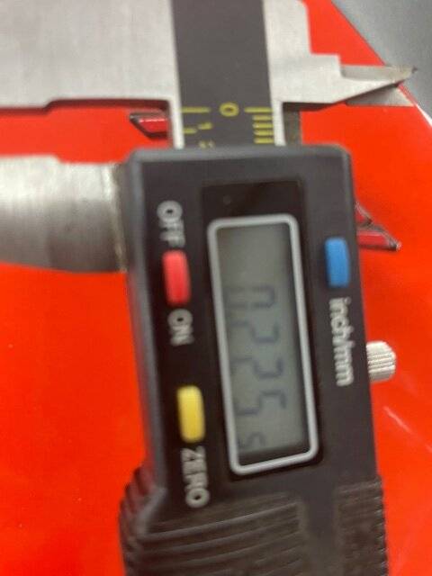

Here are the dimensions
Height of the 440 = .664
Height of the SIXPACK = 1.101
Thickness (on car) = .225
Thickness (off car) = .213
I suspect that there is a slight gap from the emblem to the hood which is why I measured a different emblem, it is a "383 MAGNUM" emblem but I am pretty sure they are the same thickness
View attachment 83310View attachment 83311View attachment 83312
View attachment 83313View attachment 83313

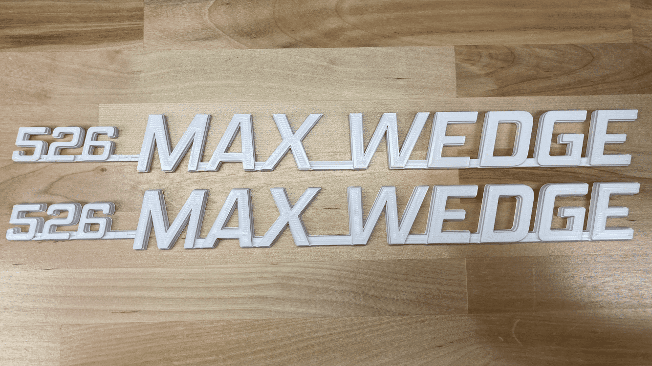

Thanks so much! I’m making some custom 526 MAX WEDGE (might do 526 SIX PACK… haven’t decided) emblems and this helps immensely.

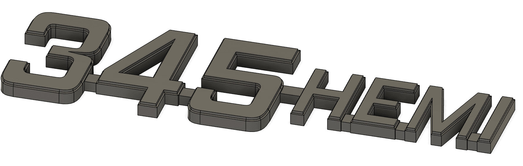

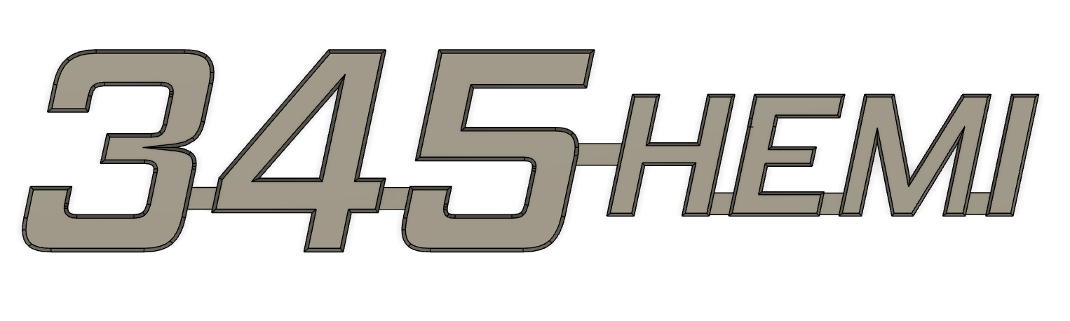

@70chall440 Here's what I came up with. I couldn't match the font exactly, but here's where I ended up. I'll print some prototypes tomorrow. I just used the same measurements you took from the 440 sixpack emblem.

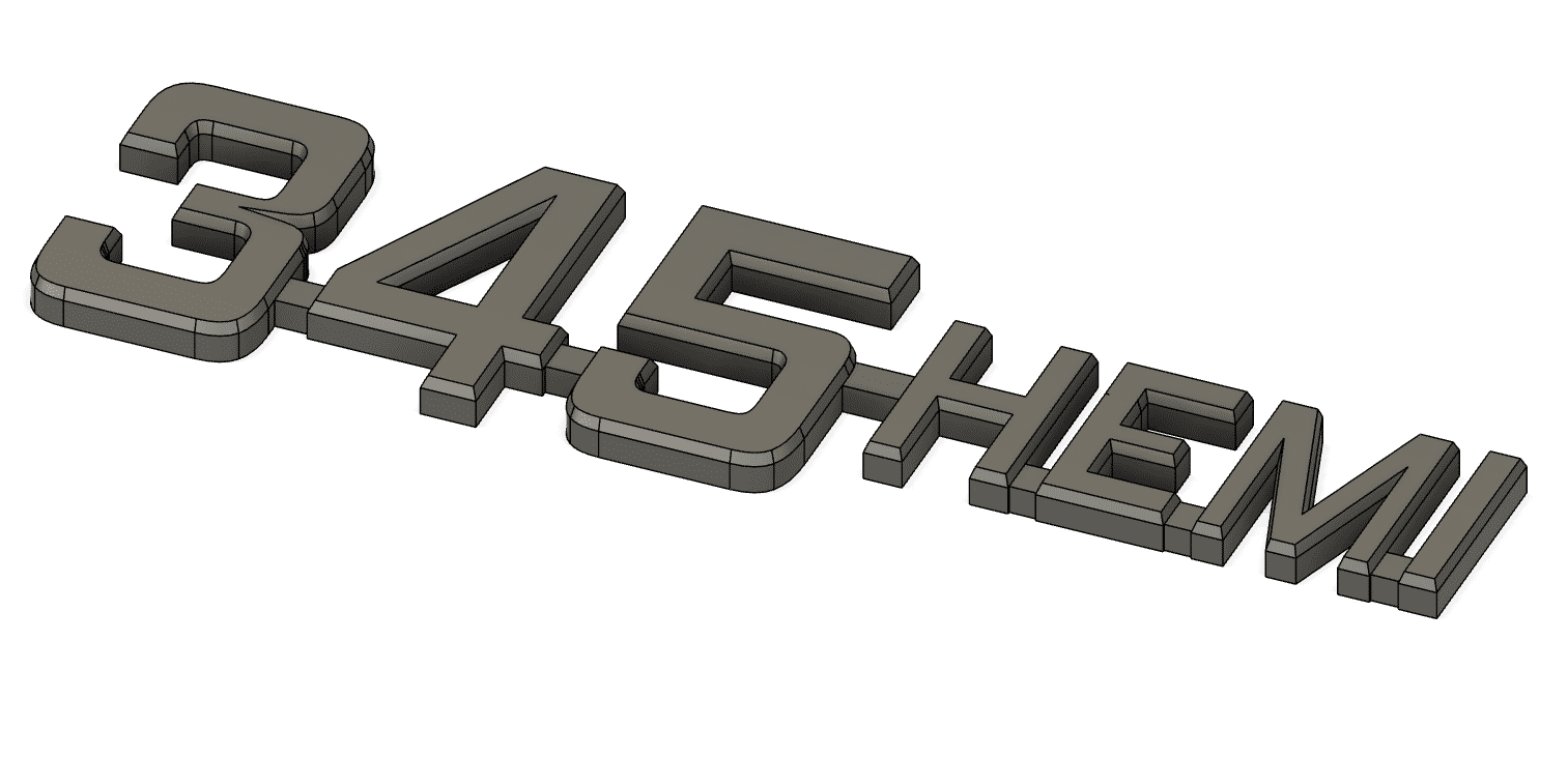

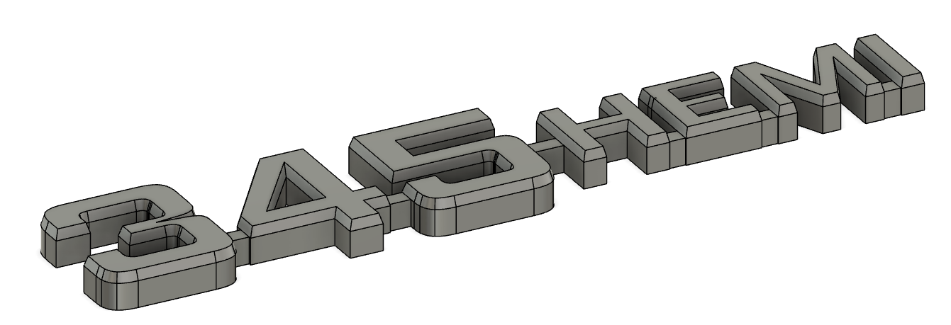

Slight revision... Made the chamfered edges square instead of beveled.

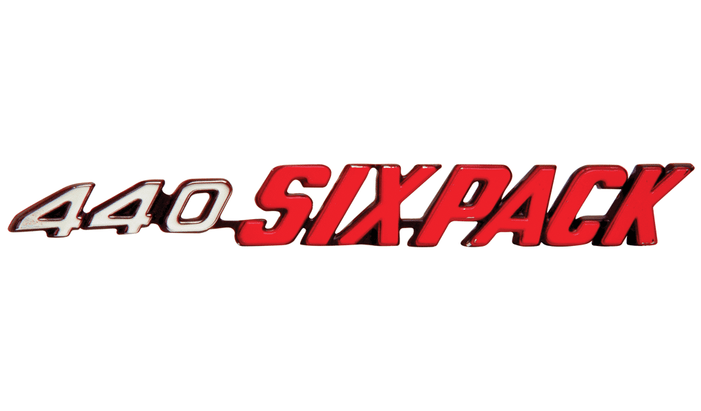

That looks good, I just noticed that the 426 emblem and the 440 Sixpack emblems are opposite in that with the 426 emblem the numbers are larger than the letters bit on the 440 emblem the numbers are smaller than the numbers

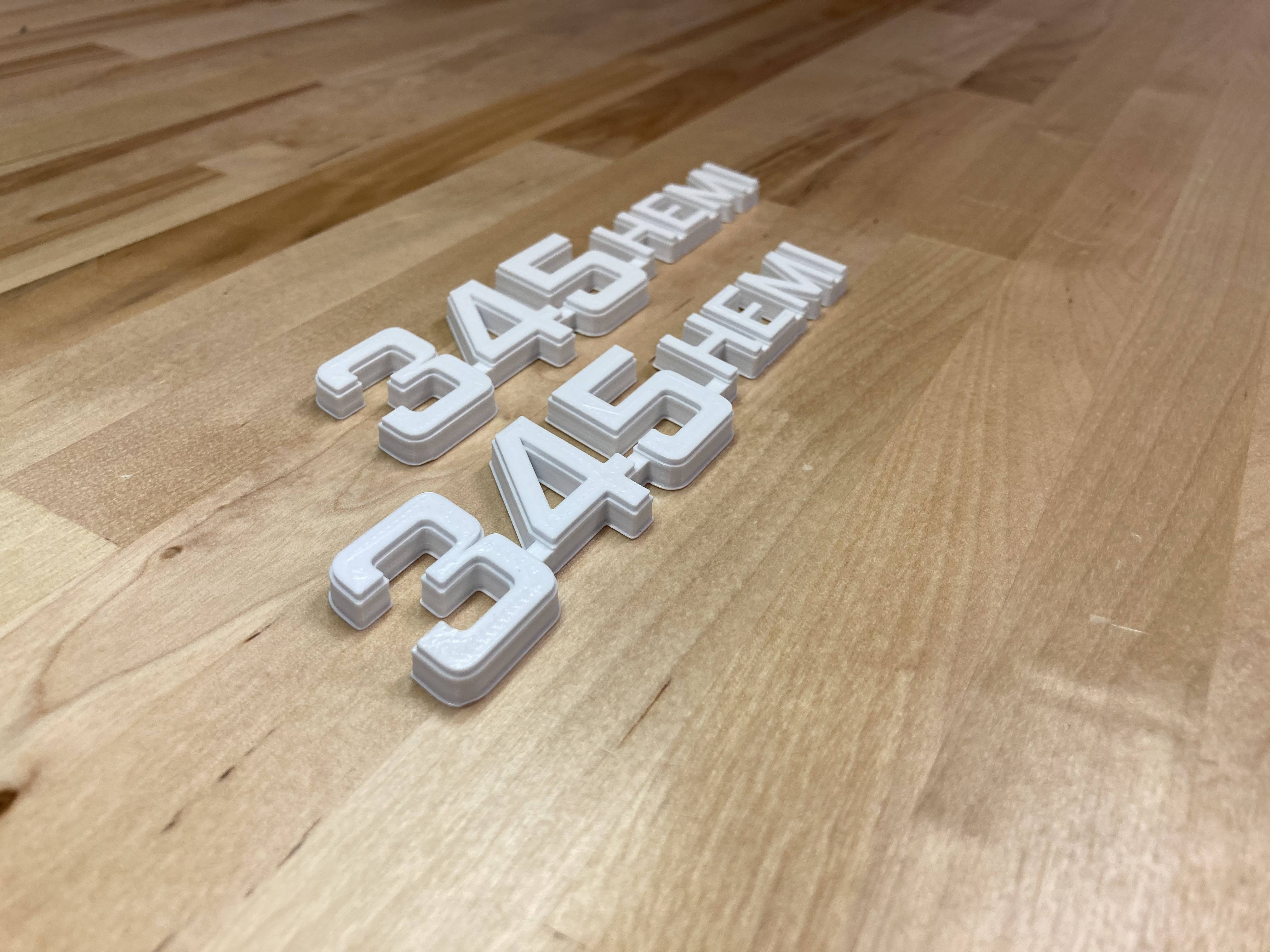

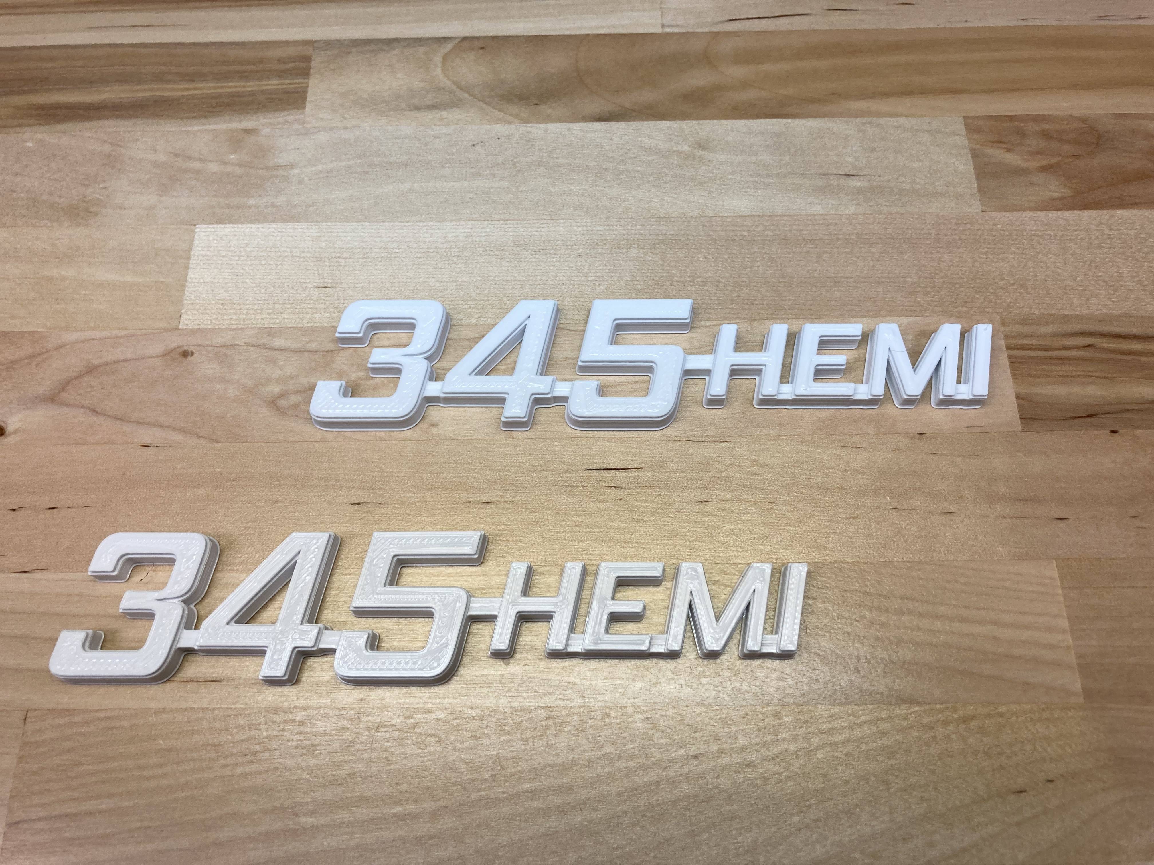

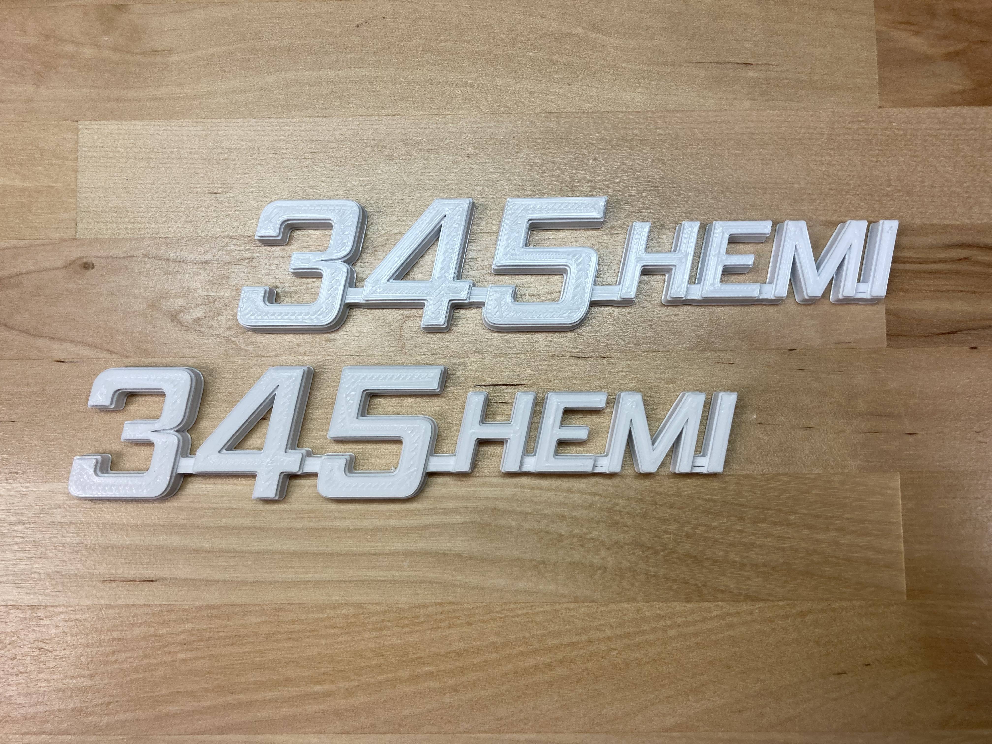

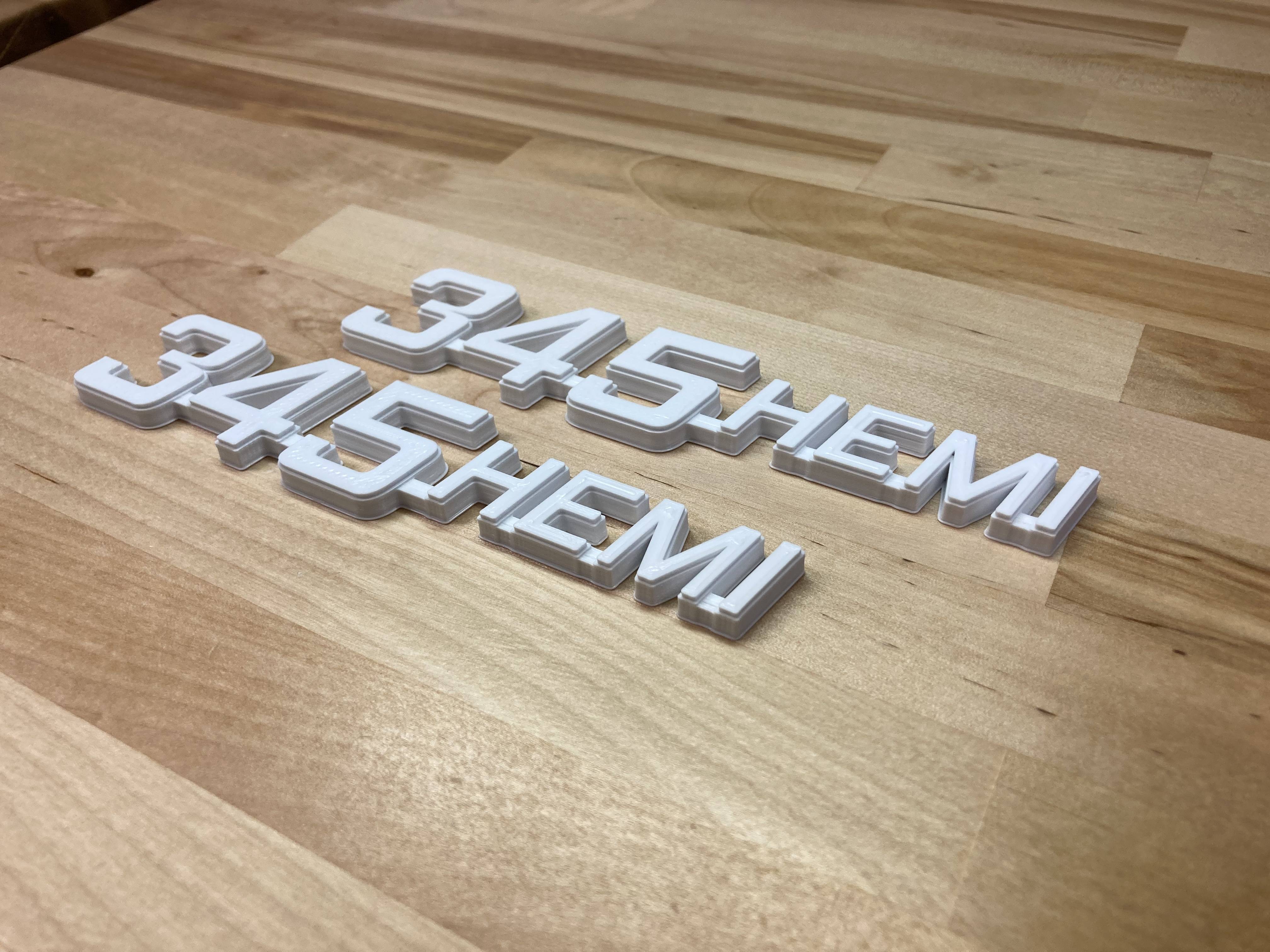

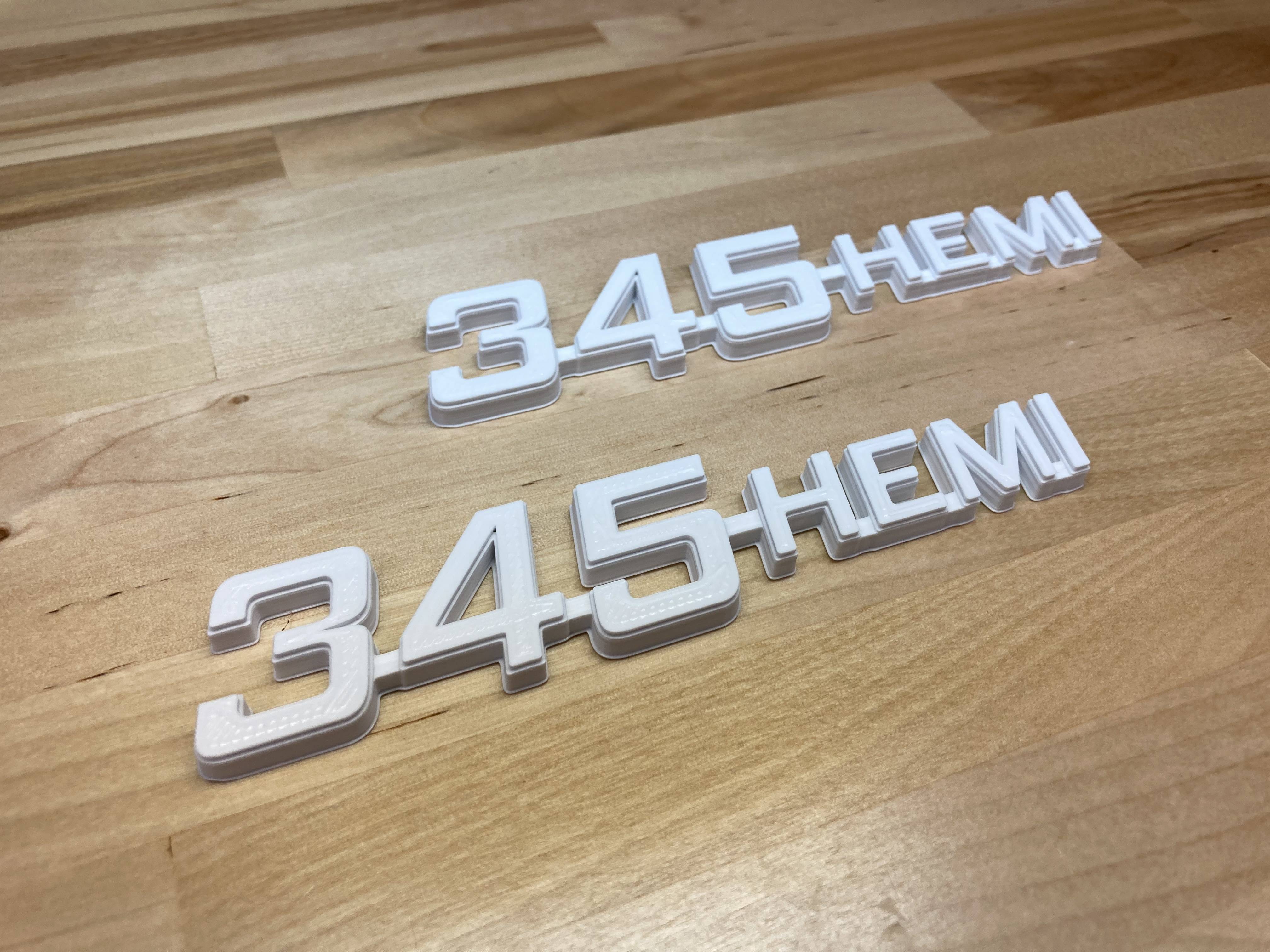

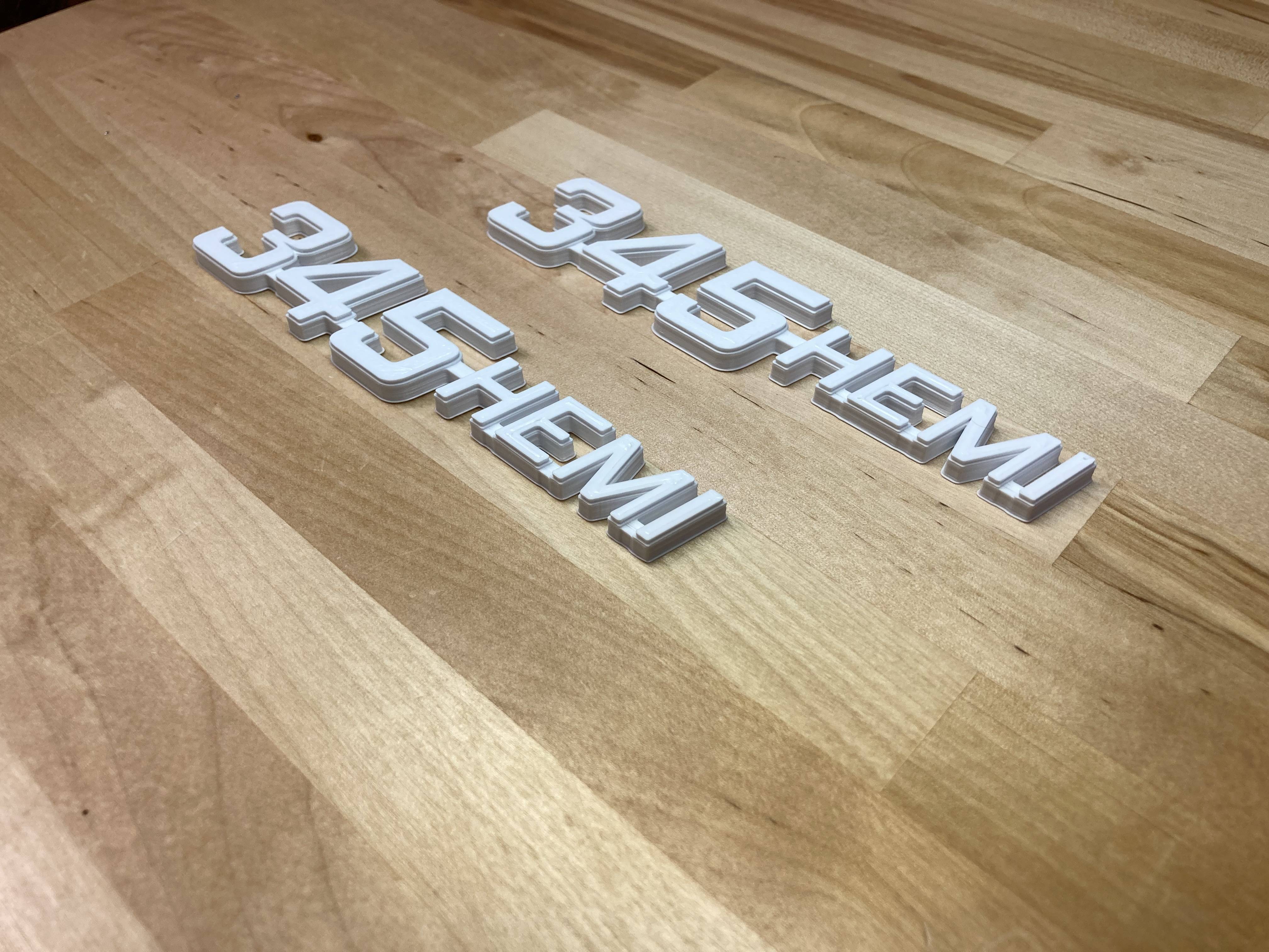

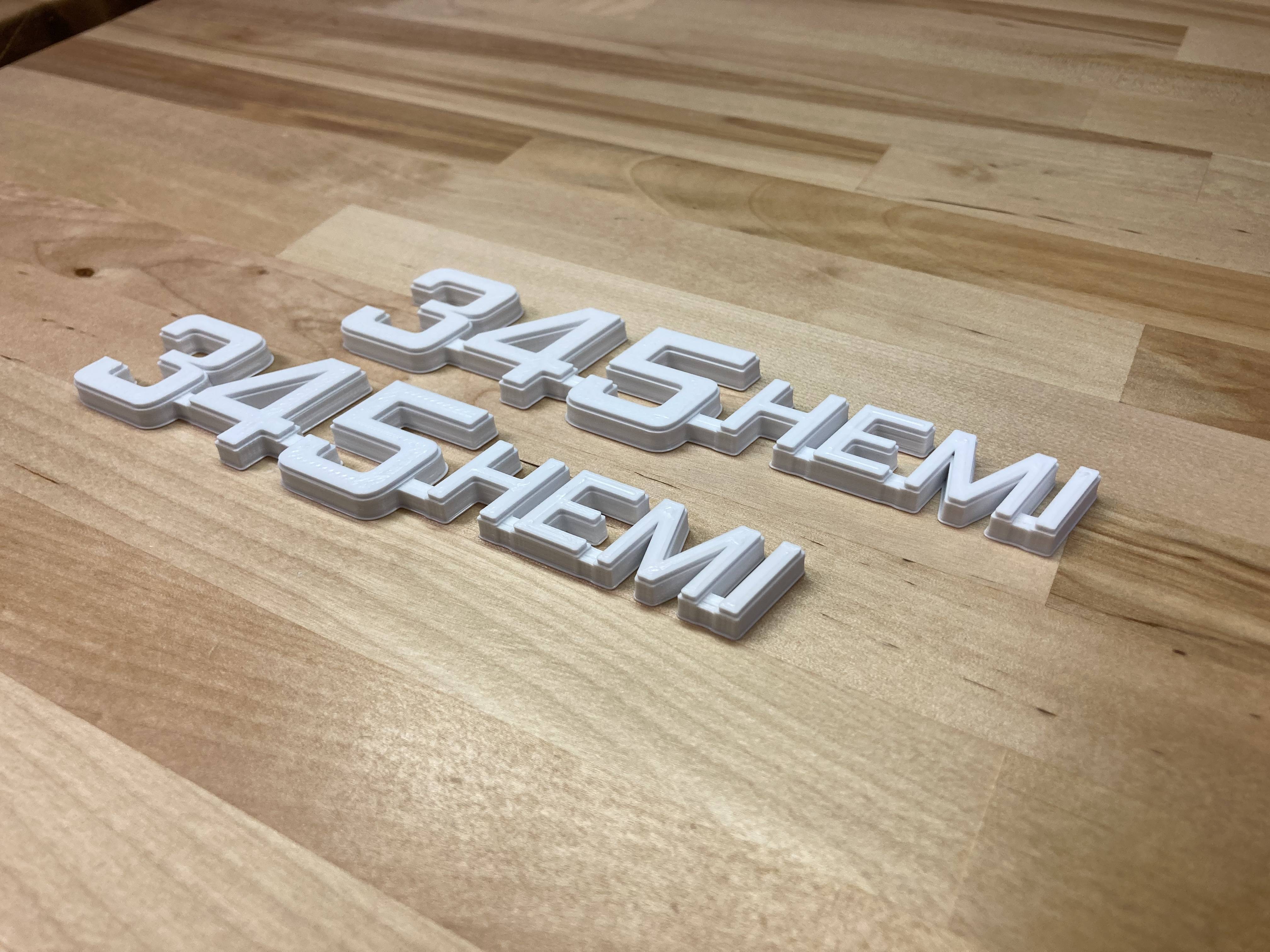

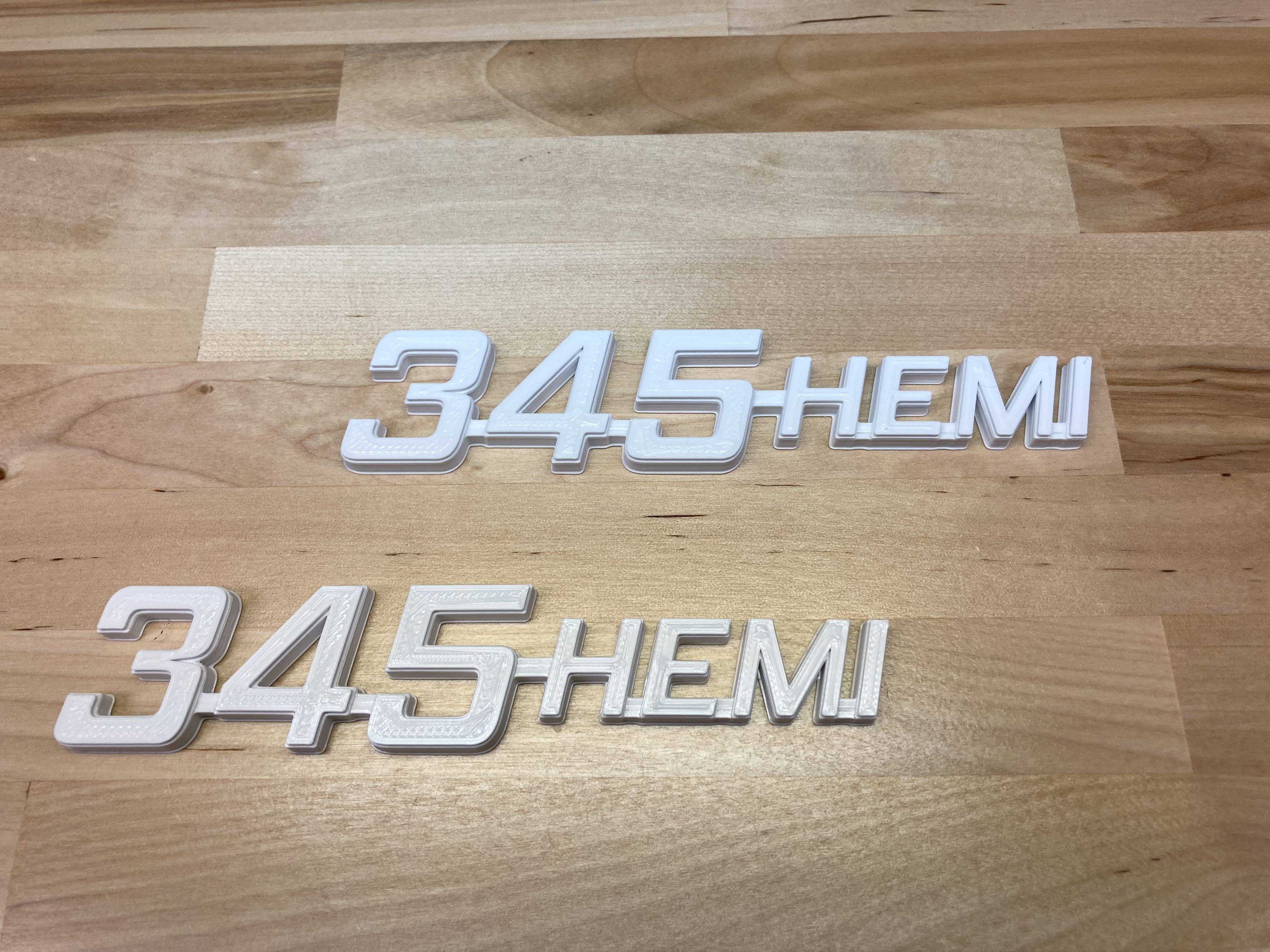

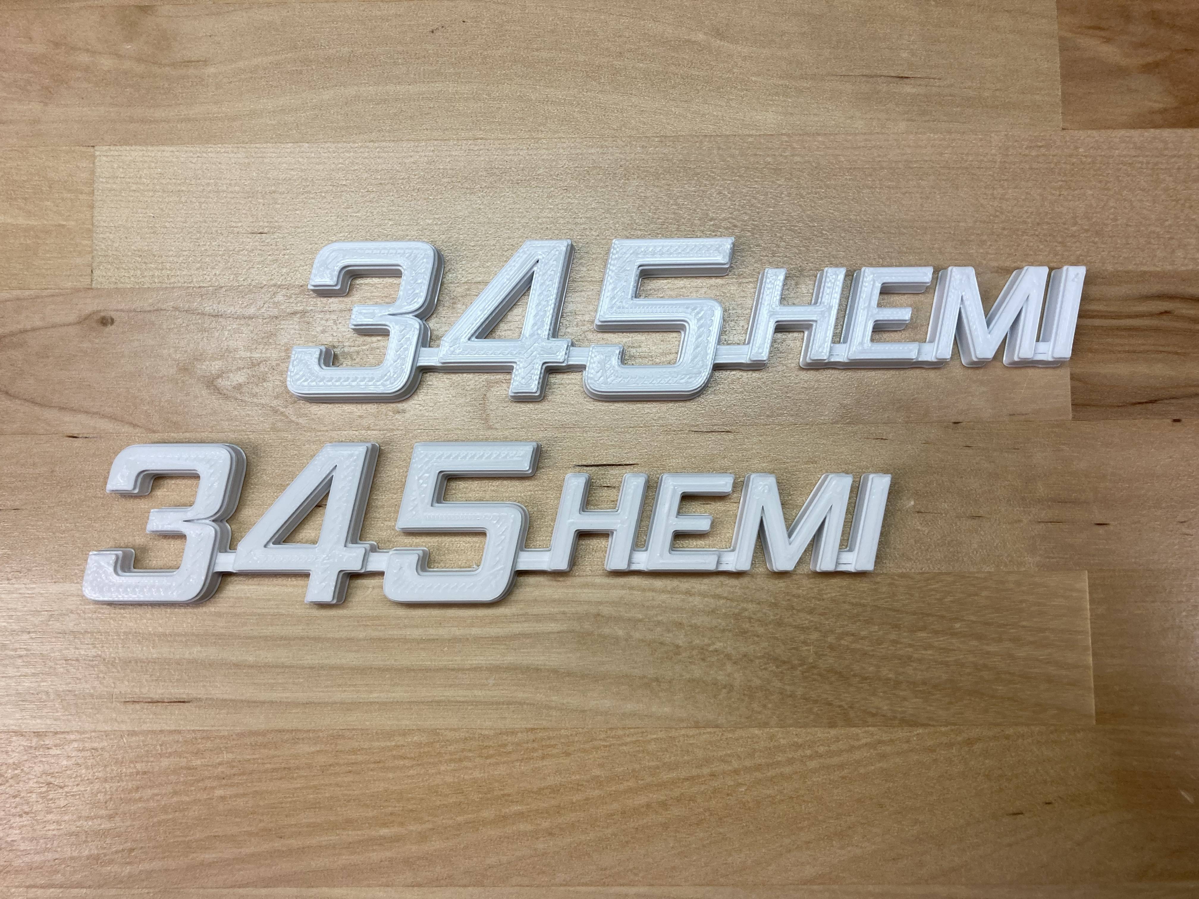

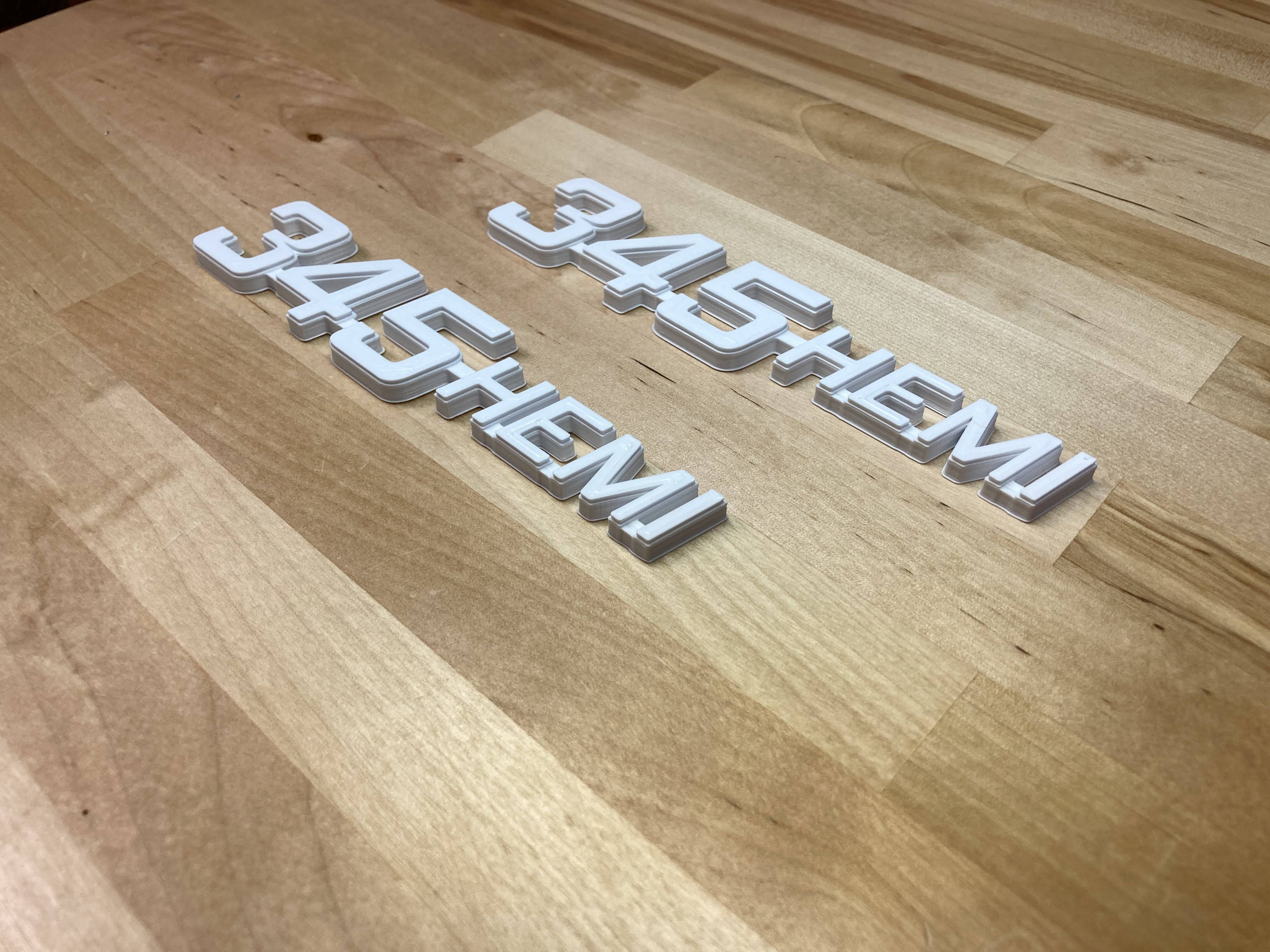

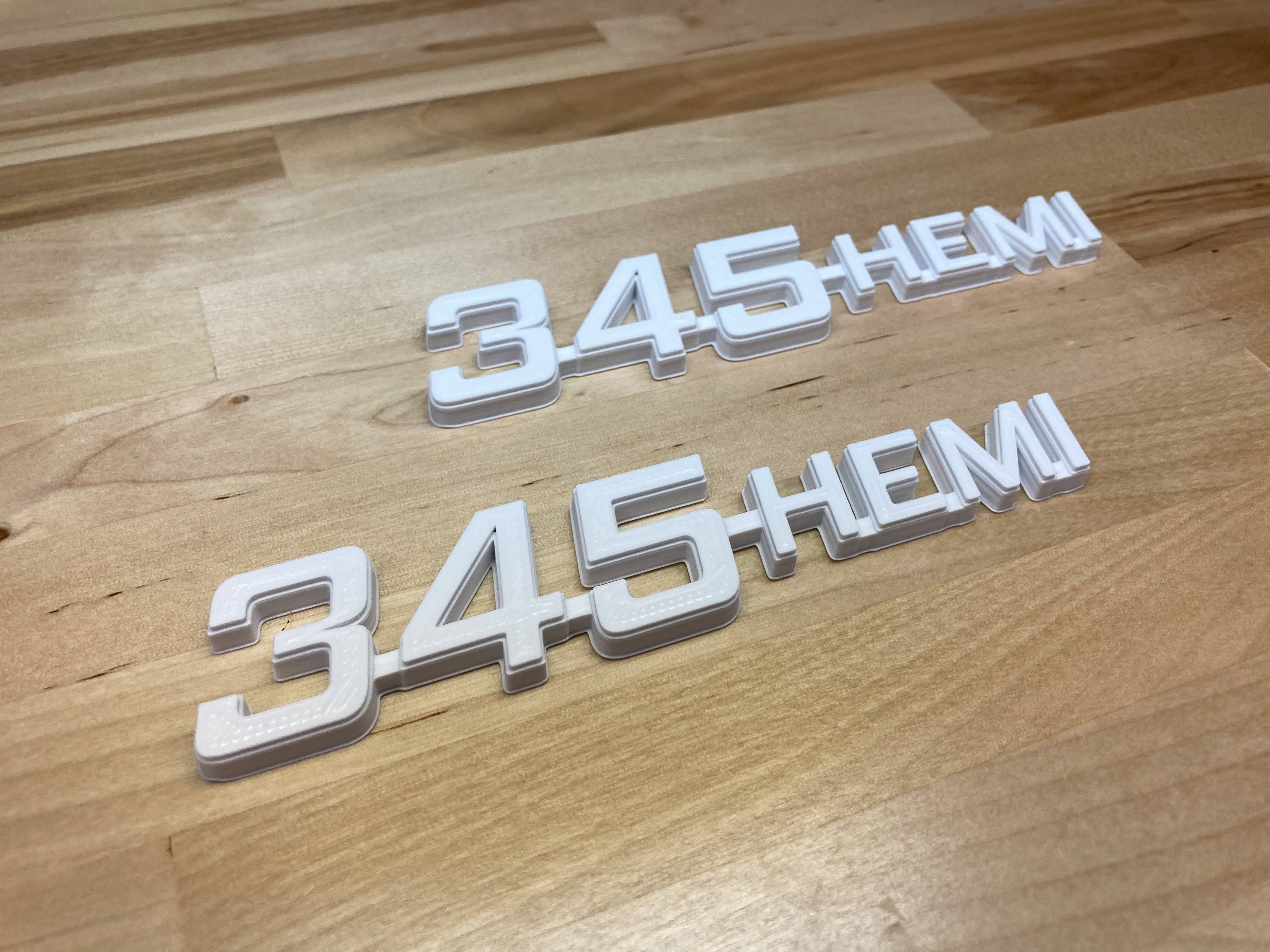

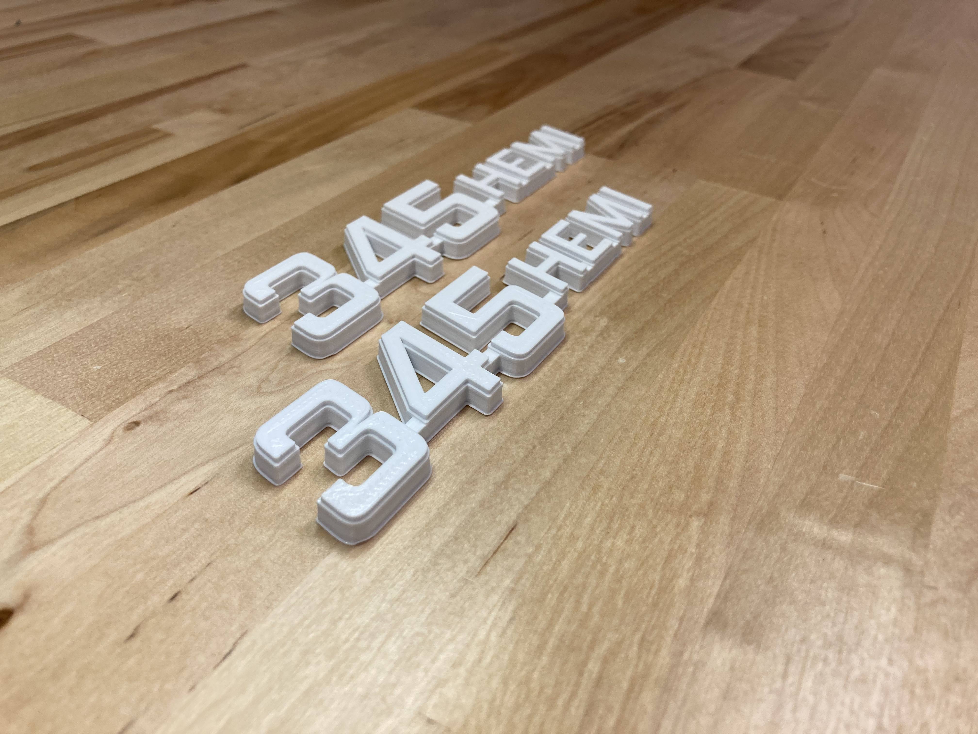

@70chall440 Here are the results.
First one I with offset supports between letters/numbers
And here's take two with the supports all in a line...

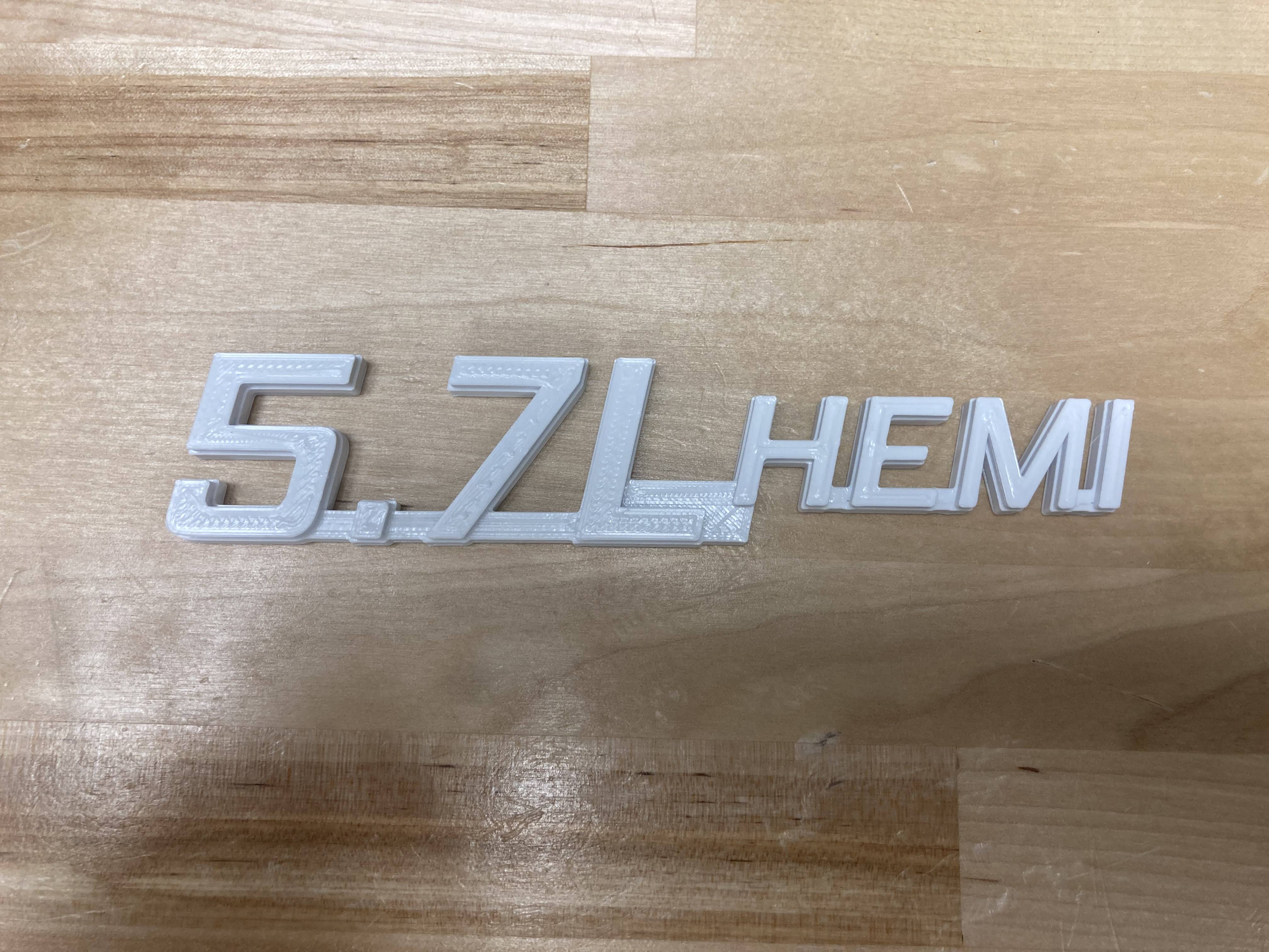

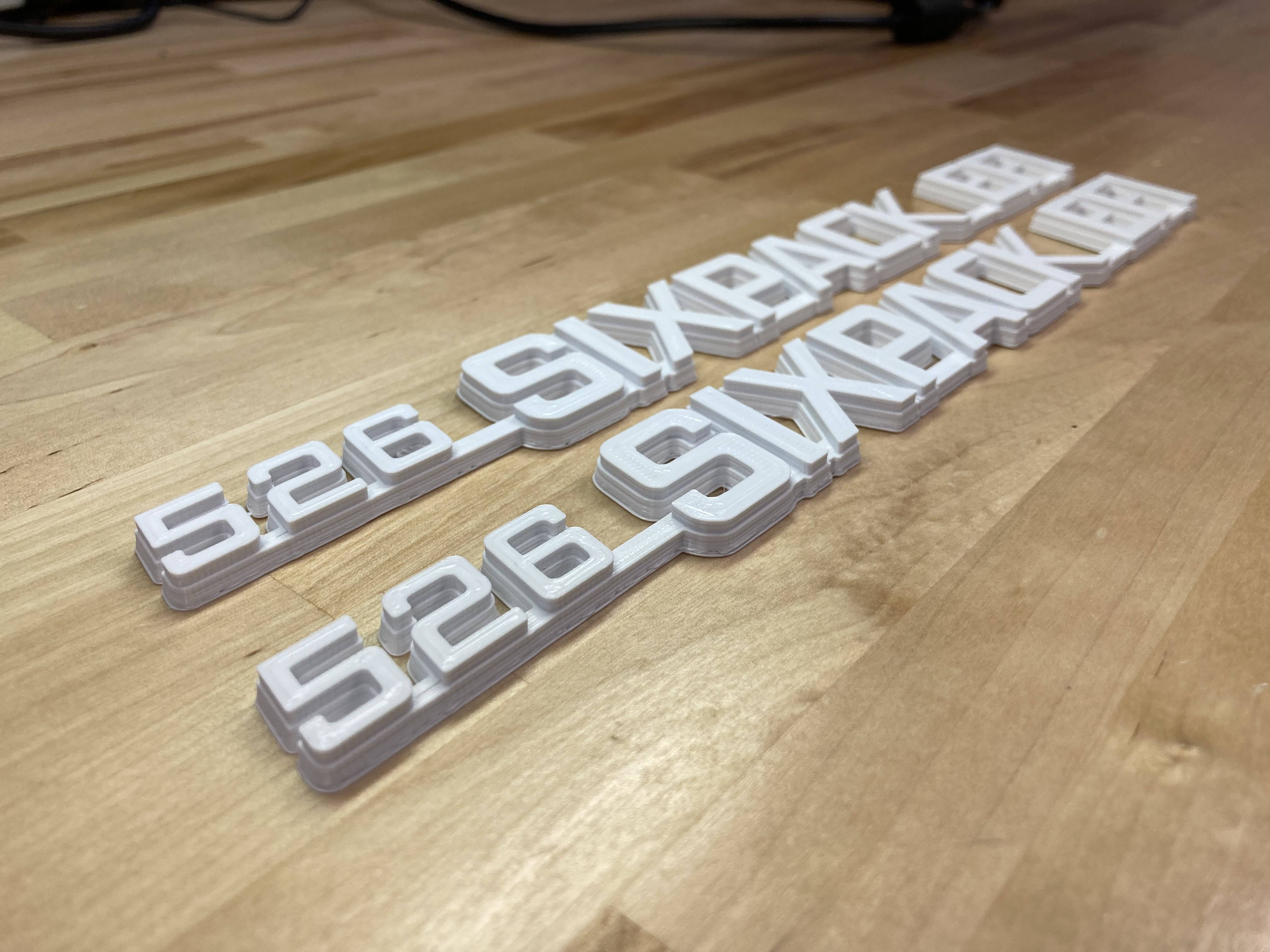

Not sure which I like better. They're both about equal as far as rigidity goes. Right now I'm working on the 526 MAX WEDGE badge and I'm using a 2mm offset from the top of the emblem to the relief. These ones only have a 1mm offset. Will update when they're done printing, then if they look better I'll print some more of these with the 2mm offset.
I like the first ones (I think) but you are right in that they both look pretty good.
