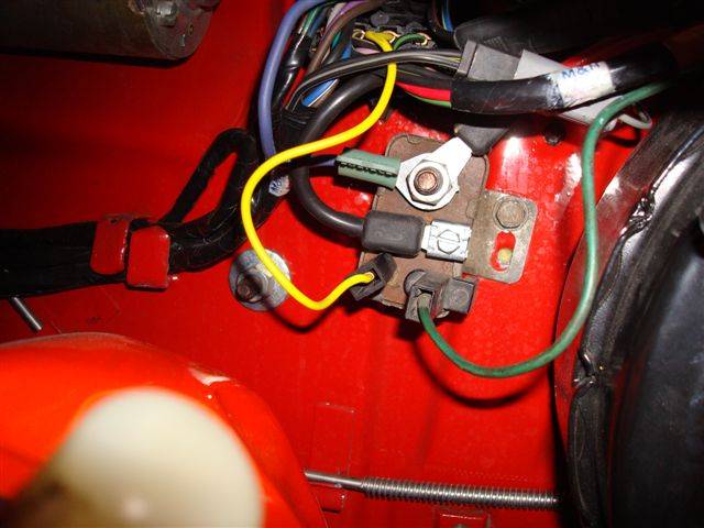

If you have the stock starter relay.Green wire terminal has to be grounded yellow wire terminal you connect to the battery side.To test put a test light on the starter side. ground the test light. Try the key or jump the relay as discribed.

If you have the stock starter relay.Green wire has to be grounded yellow wire you connect to the battery side.

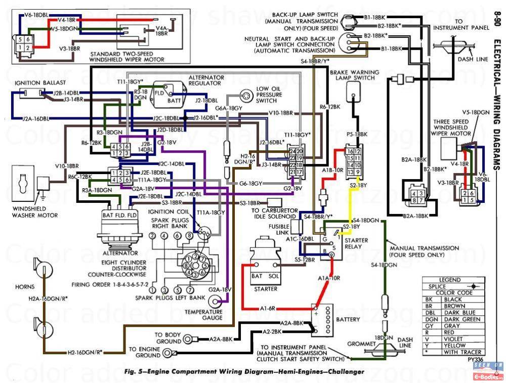

Yeah! this is still the blind leading the blind. I have an idea what you are taking about.This is the engine wiring. It's a little easier to see. The starter circuit.no matter how it's routed it still works the same.
