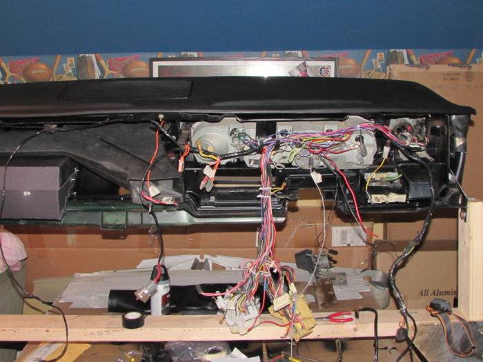

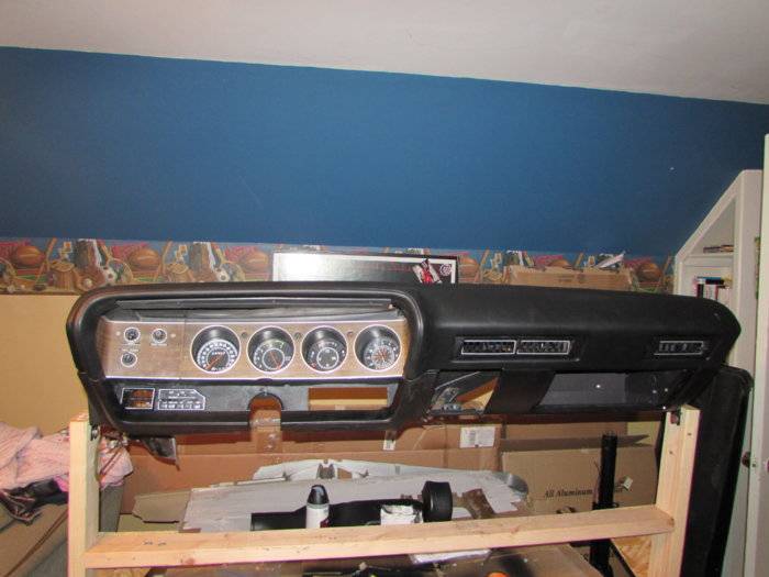

I put in a rally gauge cluster from a standard cluster not to long ago. You will also need to clip off the oil pressure light and use the wire for a gauge. I used the three bulb light bar, it fits. I just haven't found a four light bar yet that is cheap enough. I might modify mine to mimic a factory one if a cheap enough one does not show up. It is not too hard, you can do it. Rod

Yep, did that, didn't remember that point. I didn't use a conversion harness, just made the modifications to the stock non-rally harness.

Man what a difference the correct light bar makes! I drove mine at night for the first time since I installed it and I was mesmerized by just how badly the wood grain overlay looks!:lol:
