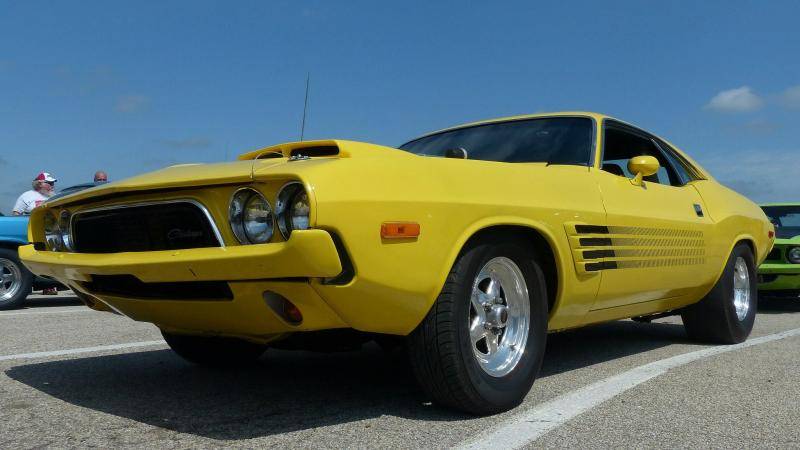

Challenger.jpgBumper reinforcements are removed and only i only run a single bumper bracket on each side. I have ran my motor in a tube chassis 85 Shelby Charger and ran as quick as 9.30 @ 143. Again not trying to be the fastest just looking to loose 100 to 200 lbs from the car. I plan to change the front wheels and tires to a lighter set up, cut the door impact beams out, glass hood and front bumper, change to Strange front disk brakes from the factory brakes and put light weight seats.

Nice car. Are you racing straight up or with a dial in? You know that with a dial in it doesn't matter how quick you are but how consistent you are. You could run 15.0 all day long and win as long as your dial in was 15.0
