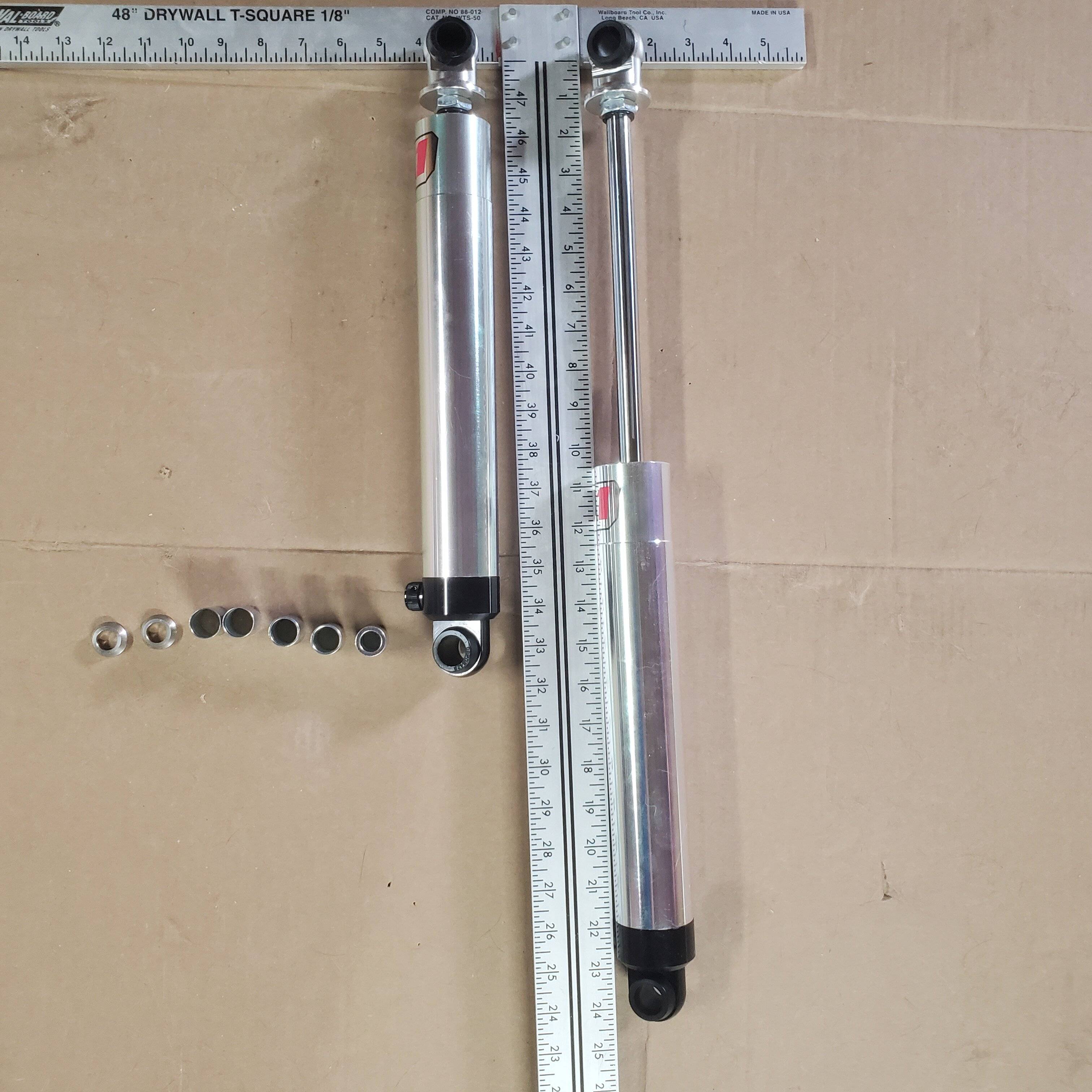

I recently installed QA1 shocks on the back of my '71 Challenger. I believe there is a problem with the length because there is less than 2 inches of compression travel left when installed. The advertised travel is over 8 inches. The car also rides really rough in the back. The QA1 shocks in front are perfect. Anyone else out there facing this? The car is really low in the back (23" from top of wheel well). Looks great, but I am concerned about the rough ride and the low ride in front also. Headers will drag if I'm not careful. Looking for a solution - maybe shorter shocks. Any ideas?

TS901 about 15" fully collapsed and about 23.5" fully extended. Did you get the reducers and funky washers?
