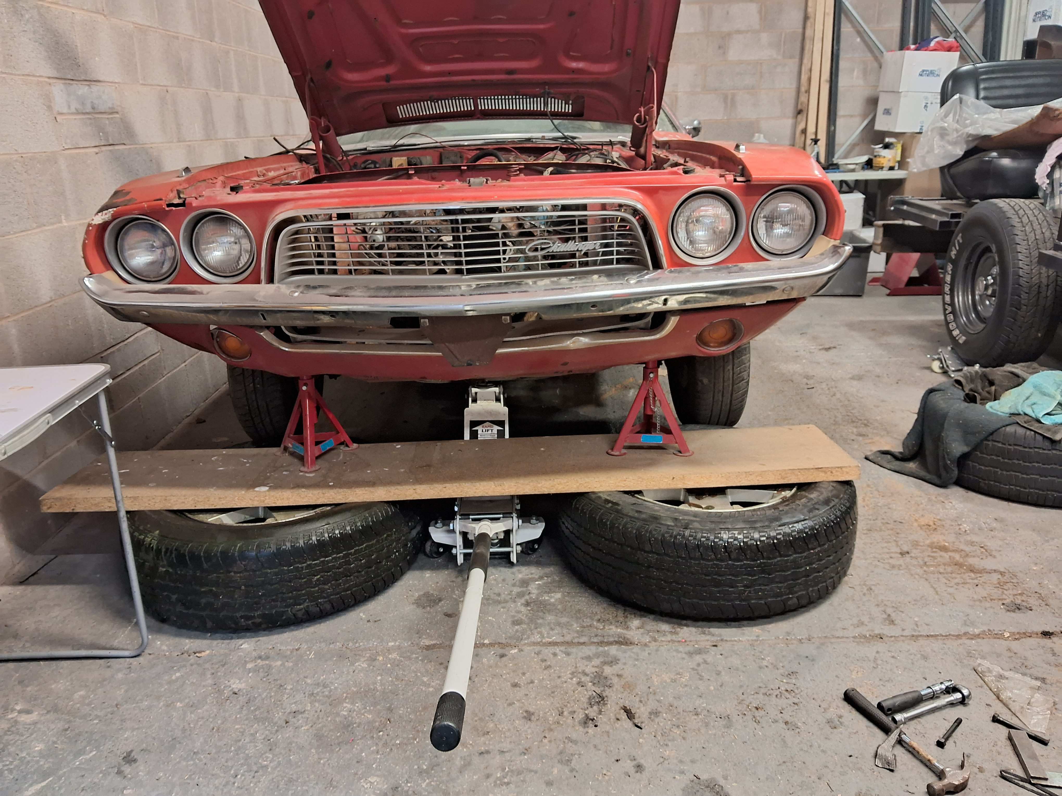

Got garage space .Time to start engine and trans swap,pics of 73 and my refurbed 383.Im going to build lift frame that bolts to front frame rails using removed bumper frame like Jonny mopar did.Dropping K frame,lifting front up via hoist.just making mobile engine cradle for BB then i can free up hoist.
