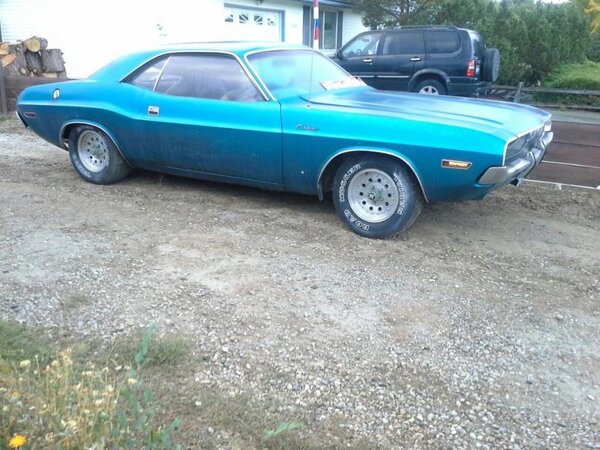

Looks good! I'm working on getting my 1970 Challenger Resto Mod completed! We are putting a 5.7 Hemi out of a 2007 Truck, then adding a 6.1 intake, SRT manifolds, and a Super Charger. We are going to be ordering the Suspension from Magnum Force. I look forward to seeing your completed project! Challenger.jpg

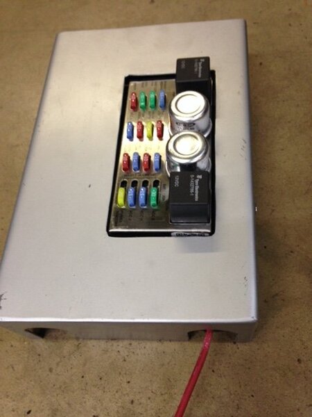

Right now working on running wiring and mounting the pcm and fuse panels.

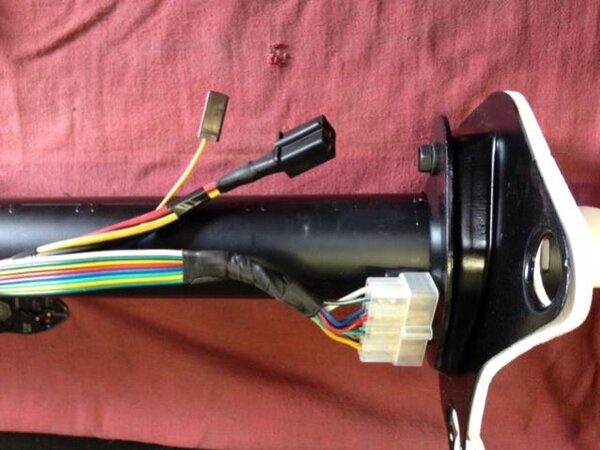

Working on the column wiring today . Had to remove the factory style connectors and install the new ones from Ron Francis.
