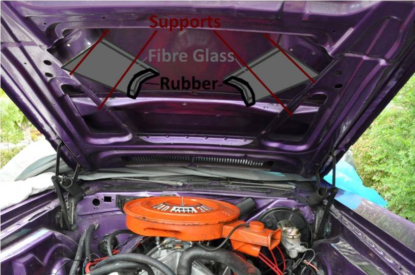

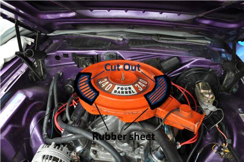

The plan?
So here is the plan so far
1. Cut two sections from air cleaner lid(blue)
2. Build up surrounding area with soft structural rubber (black)
3. Probably cut off and seal over snorkel on cleaner lid, maybe build door on snorkel in case driving in rain?
4. Build two tunnels out of fibre glass (grey)
5. Add rubber around tunnel-filter air hole (black)
6. Build bracing system (brown)
Would driving in heavy rain with a ram air intake cause engine problems? Any experiences to share from people who have ram air would be great.
Suggestions, improvements, hints and any general advice would be much appreciated,
Thanks

First off, I have the same hood on my Challenger and thought the same thing, why not make these things functional instead of decoration. I wouldn't do this if you think you are going to get "big" horsepower gains or much better fuel mileage by the way. So here are my thoughts:
1. challenger6pak brings up a good point. Does the open area in the scoops alone provide enough air during wide open throttle? Pro Stockers have this down to a science. But, backyard engineering on my part says that based on the original air cleaner snorkel hole size, it would be similar. But don't some of these have two snorkels? That's probably the best bench mark to go by, not the single. Obviously you do not want less air available than stock as you probably have made motor changes that now creates more horsepower which requires more air.
2. Heavy rain would probably be a problem as the filter will get saturated after a while. I recommend a least a rain gutter/downspout type configuration be designed to capture water running in at the bottom of the tunnels or maybe something at the bottom of the air cleaner (outboard of the filter) that can capture water and direct the it away from engine (water heater hose as the downspout for example). Water vapor will still get by though and again eventually saturate the filter. I assume you will still run a filter at least while street driving. And removing it at the drag strip really doesn't help all the much anyway. At least not worth the risk. A little water injection won't hurt the motor per say. But your not going to be going balls out in a rain storm anyway, I hope!
3. I assume you would sell or keep this original air cleaner and modify an aftermarket one?
My plan was to just leave the plates that block the scoops out and use an aftermarket air cleaner that has the filter assembly on the top. I'm in California and can easily decide not to drive mine in the rain. But I would carry foam inserts that could be inserted in the scoop holes in case I was surprised. You could also do the foam inserts, but you would have to have a secondary approach to allow dry air into the air cleaner if you plugged the scoop holes during a rain storm. Or park under a bridge and wait it out like I did when I had 2 exposed paper air cleaner filters exposed hanging on top of the 6-71! Good luck, I like the overall idea!

Don't worry, I wouldn't dream of modifying the original cleaner, I was planning on picking up an aftermarket cleaner lid without the snorkel from yearone.
1. To further the rain concept, build a hinged sealable door onto the side of the air cleaner baseplate, so once foam inserts have been placed in the scoops the engine can still breath!
2. Also a support framework will probably be necessary under the cleaner baseplate to take the uneven (forward tending) load off the carburetor.
Thanks heaps Juan, that's the sort of input I was looking for!

It looks like you have the air cleaner with the vacuum operated flap which allows more air flow than the single snorkel. If it were me, I would open the scoops and leave the drain troughs in place. I would open the scoops just to allow more air flow under the hood. It does help with under hood temperatures. Then I would buy the ram air, sealed air cleaner system that uses scoops under the front bumper or under the front of the car to bring in fresh air to the engine. This would save time, headaches, possibly money and it would work for sure.
