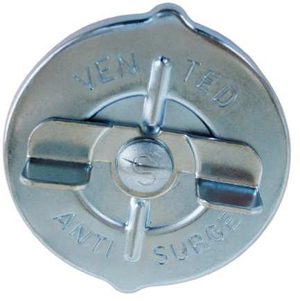

MoparCarGuy
Jun 28, 2020
505
388

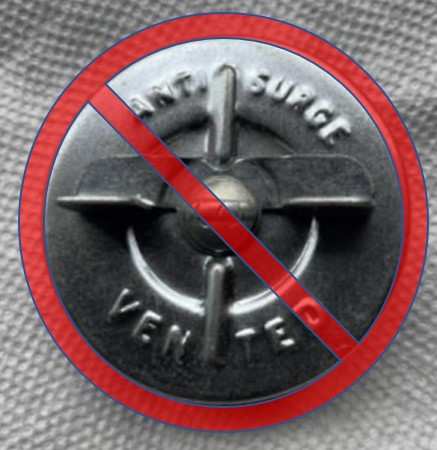

The 1970 VENTED ANTI SURGE fuel cap in repro (currently $75) and the original 1970 Cuda cap installed. There is an incorrect repro out there but it has raised lettering with the ANTI SURGE on top and the VENTED on the bottom.
