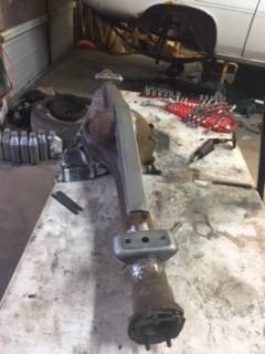

bought new SS Springs only a 3800 pound spring instead of the 3300 pound SS Springs im taking out.
found broken piece in my housing
which ended up being from my clutch pack ears braking off. Bought a spring relocation kit and and a back brace that will be installed before the rear end go back into the car.

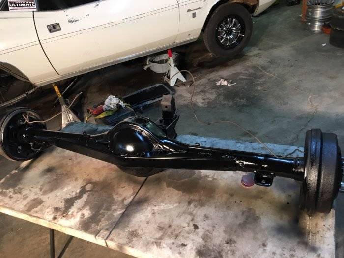

purchs welded, back brace welded,rust ground off rear axle and painted.
Installed and just need oil.
new tires and slicks, slick are going to be wider and taller....think they are going to work.
