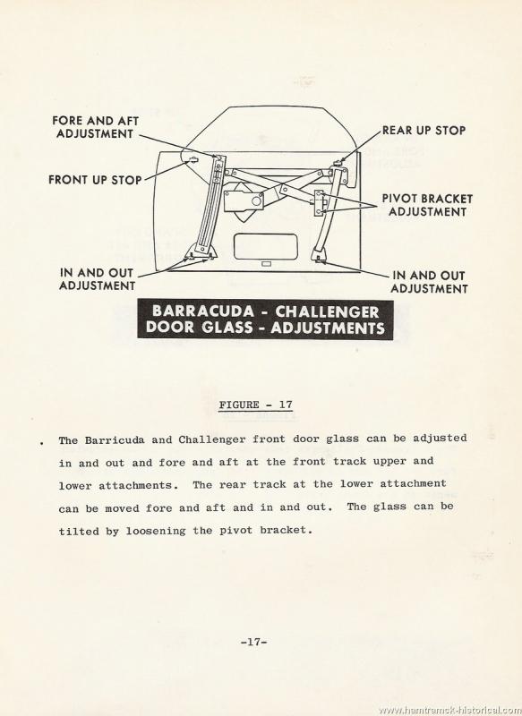

Bought a71 challenger and l when l unloaded it off the truck all the window hardware was at the bottom of the door bought the hardware but dont know where to start any books , bought the dodge body service manual and the pics are not clear enought help thanks this is my first post

Here's a link to another site that covers it pretty good and also some pics.
http://www.cuda-challenger.com/cc/index.php?topic=84250.msg889426#msg889426
