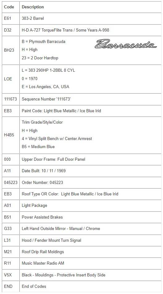

I understand the difference between the Cuda and Barracuda but this one perplexes me. It is obvious it is a Barracuda from the VIN but it came with a 383. I was under the impression that only the Cud's came with big blocks, maybe not. Also, this car has a factory tach on the hood. Is that possible or did someone replace the hood?
Below is what I found on the VIN/Fender Tag decode. Any input is appreciated.

Any big block Barracuda is worth money today. Even the 383- 2 bbl. model that you have. Chop up a Camaro, not a Mopar....
Factory hood tach....no such animal. Added on. Only tach on E-body would be with the Rally Gauge package.

I have never seen a hood tach on any sales documentation.
Nor have I seen one in any mopar parts book.
Agree with moparleo. If the car has it's fender tag and numbers, let it go to a driver. Find a barracuda that has lost it's fender tag and provenance.
Not many BH L or N code cars out there.
However, it's your cash so build what you like out of what you like.

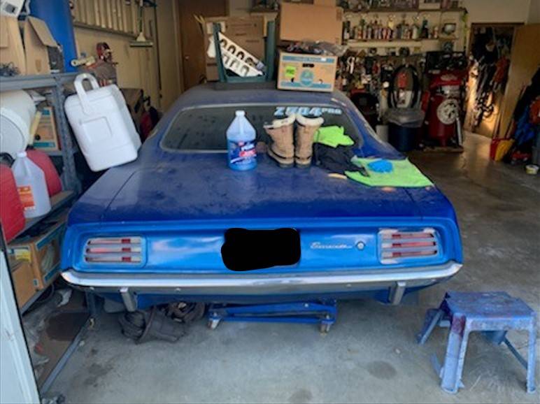

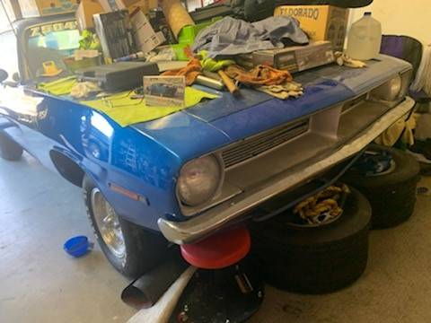

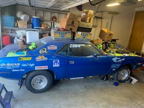

I asked the owner to shoot me a pic of the hood tach. It's in a dank old shed off the car and he's somewhat disabled. Stay tuned. He said it was a dealer option for that's worth.
These are the only overall pics I have that he sent when I initially found out about this car. Dressed like a race car but essentially stock. No motor in it. All there. Numbers matching block and 8 3/4 but no tranny.
View attachment 97802View attachment 97803View attachment 97804

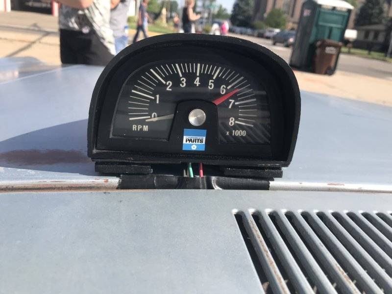

If it matters he had all the **** cleared off of it when we took a look at it.

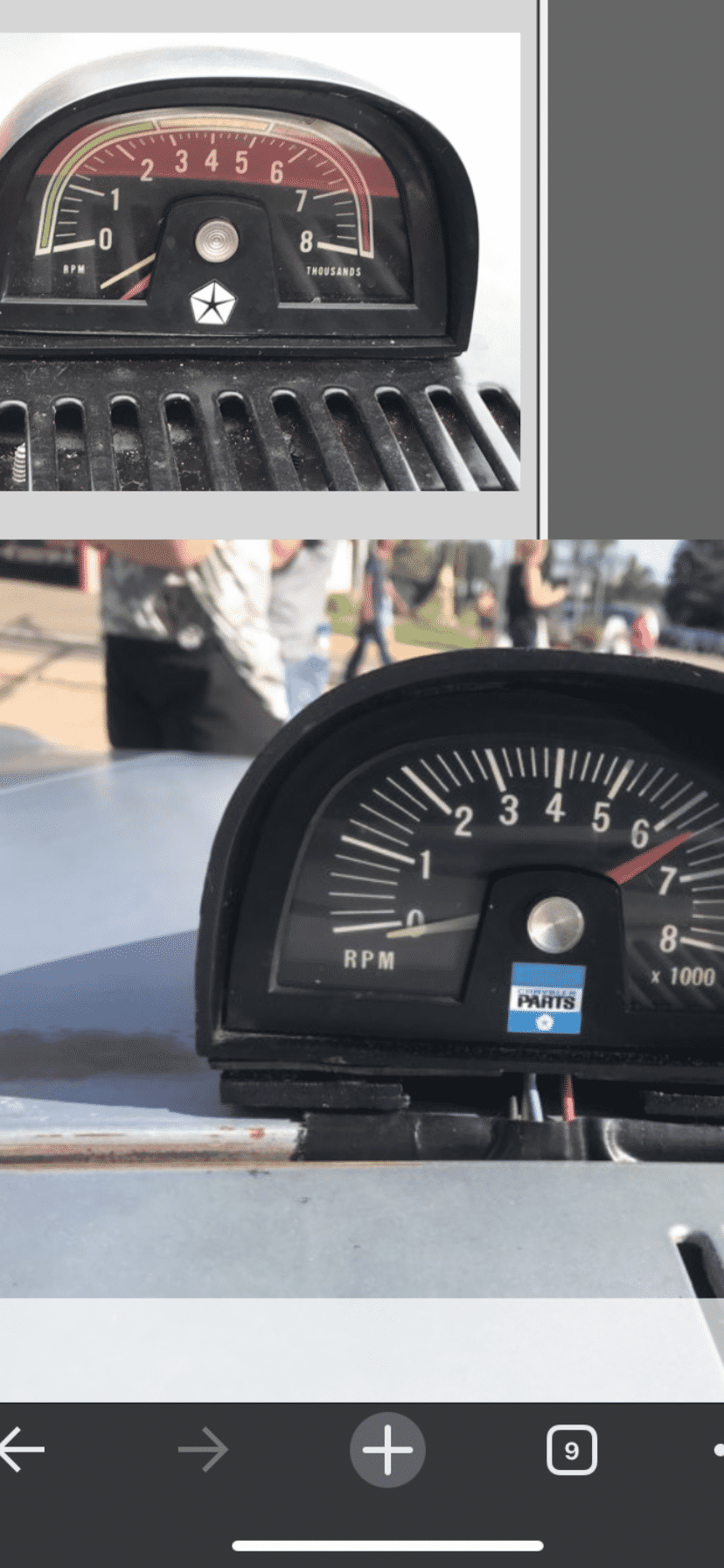

Here is the best pic he could get of the hood tach. No scoops obviously. Any input is appreciated.

Mopar did sell tachs back in the day. (Direct Connection or Hustle Stuff) They had marginal accuracy and are pretty rare today in good shape.

Probably a dealer accessory. If so, should have the logo somewhere on it.
Not available when ordering a car to my knowledge.
Pic from FABO

I've tried to find one of those dealer or day two tach's and they are pretty difficult to find. And a shiny penny at that.
