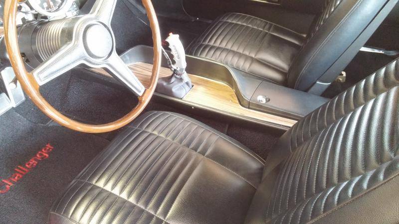

I didn't want to hijack the thread below so decided to start my own. I have a 70 challenger with centre console and a quicksilver ratchet with reverse pattern vb. Besides the fact that it looks quite ugly on top of the console, it doesn't shift very well. Often it wont find 3rd and struggles to engage reverse.
What shifter works well with the console, i'm thinking of changing it back to a forward pattern vb with shift kit and stock shifter but the console looks like it's been cut bigger than the shift gate to accommodate the ratchet so i would have to repair that and try and get some sticky woood finish to cover it.

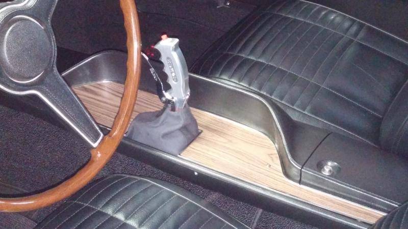

I had showed this in another thread but this is the hurst quarterstick with pistol grip, which I installed. I also have a reverse pattern vlavebody, the shifter seems to work and shift fine. I did have the factory automatic and swapped to the https://www.coperacingtrans.com/index.php?cPath=97_122&osCsid=273d3b03db2e16548ec783495f4168f1 shift-r-gate and that works very well but wanted a different look.

That looks very neat and i've heard good things about the quarter stick but i notice there's no gate to see what gear your in.

That is true, but with the quarterstick it is easy to determine which gear you are in. The reverse and park are not accessible unless you press the lower release lever to go in reverse and pull the pistol grip lever to go to park, and since I have a manual reverse valve body, 1 shifts easily to 2 and you must pull the pistol grip lever to move to third. I find that I easily know what gear is engaged, especially since I use 1,2,3 due to the manual nature of the VB.
Also, I find that I never really look to see what gear my vehicle is in even in my everyday truck. Perhaps it has become intuitive. :icon_wink:

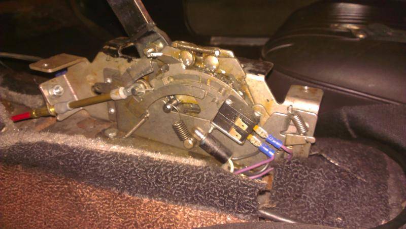

IMAG0242.jpgDiscovered a couple of reasons why the shifter dont work well, the cable is melted despite having a heat protective sleeve and the fitting that goes on the shift lever is upside down making it tight to the the trans case, i've flipped it over, ordered a new cable and i'm goint to try and loop it under the trans pan to keep it away from the headers. Also i cant see the blocker pins on the shift mechanism, so they may be missing. I've took the top plate off which has been cut extensively and i'm going to try and mount the shifter lower and make a new top plate.
Here's a pic of the shifter, can anyone see the blocker pins ? because i cant.

Turns out mine was only 3 spd and an earlier model that didn't have the blocker pins according to the B & M guy.
