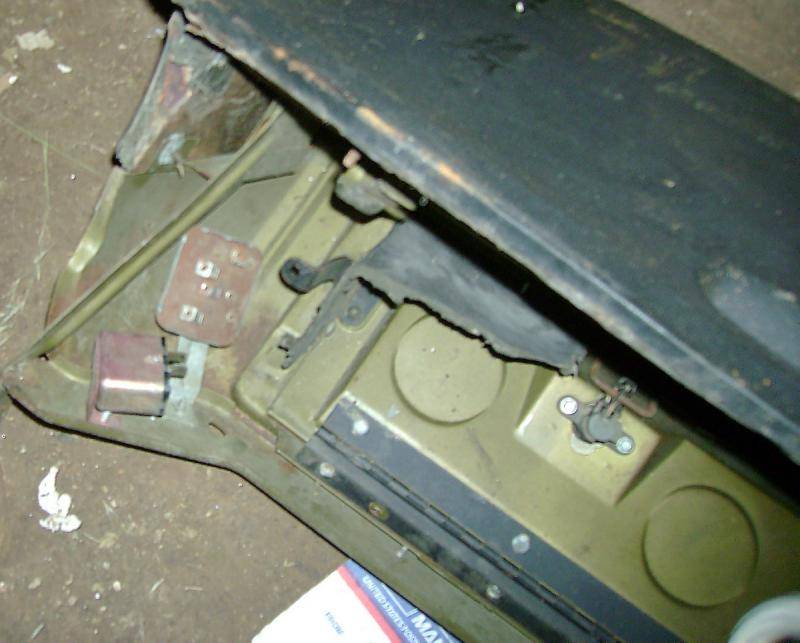

Oct 15, 2015 #1 dongei Well-Known Member Joined Jul 4, 2015 Messages 208 Reaction score 18 Location SW Florida I need to replace my low fuel relay and seat belt light relay but can't find where they are located located. Any ideas ?
Oct 15, 2015 #2 EV2RTSE Well-Known Member Joined Dec 13, 2013 Messages 262 Reaction score 159 Here is the low fuel relay (to the right), offhand I forget what the other one is? Last edited: Oct 15, 2015
Oct 15, 2015 #3 dongei Well-Known Member Joined Jul 4, 2015 Messages 208 Reaction score 18 Location SW Florida That is awesome! Can't get any better than a photo.
Oct 15, 2015 #4 J js29 Well-Known Member Joined Aug 5, 2012 Messages 671 Reaction score 152 Location lee center ny 13363 the low fuel relay should be to the right of the glove box, one screw holds it at the bottom. the seat belt relay is to the right of the steering column. round, about the diameter of A quarter about 1.5 inches long. Last edited: Oct 15, 2015
