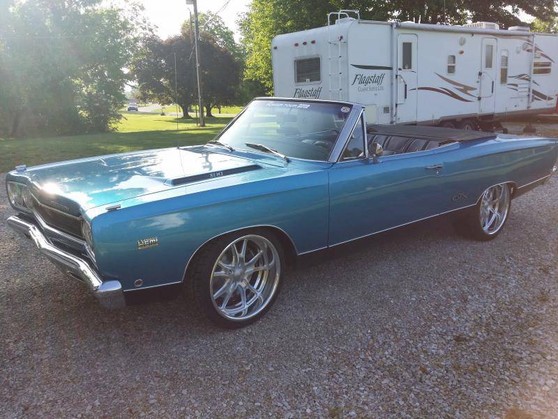

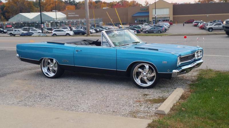

20x10 with 5.5" back spacing fits perfect on a B body not shure about the E bodies but i think that they would fit the same no cutting i think that the info your searching for and 4.5 back space on the front first pic is 22x10 5.5 backspacing 20x8 front 4.5 back spacing second pic is 20x10 5.5 backspacing and 19x9 front 4.5 back spacing i have not tried them on my cuda yet Judas priest Halloween Party 14 082.jpgconvertible pictures 007.jpg
