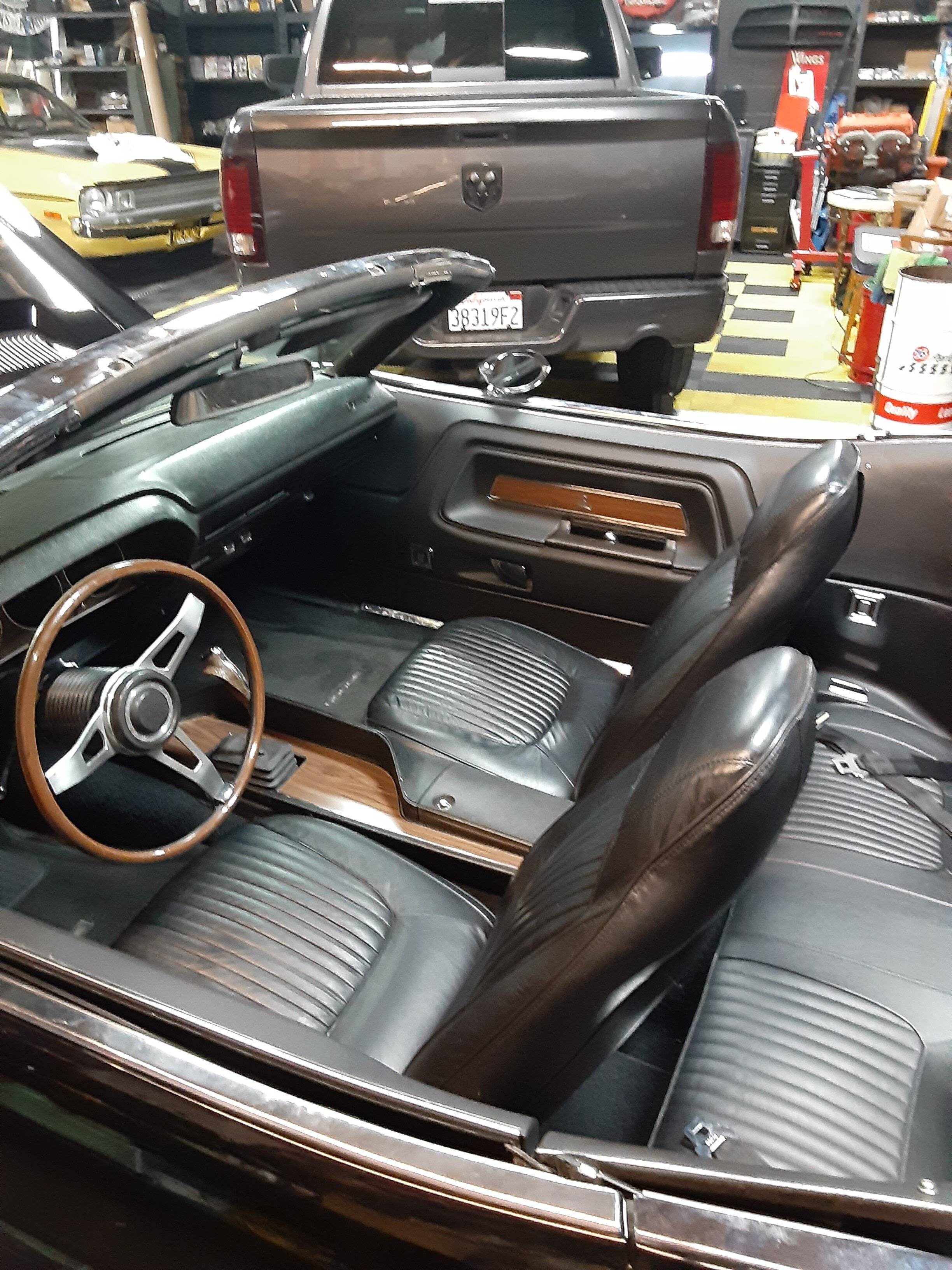

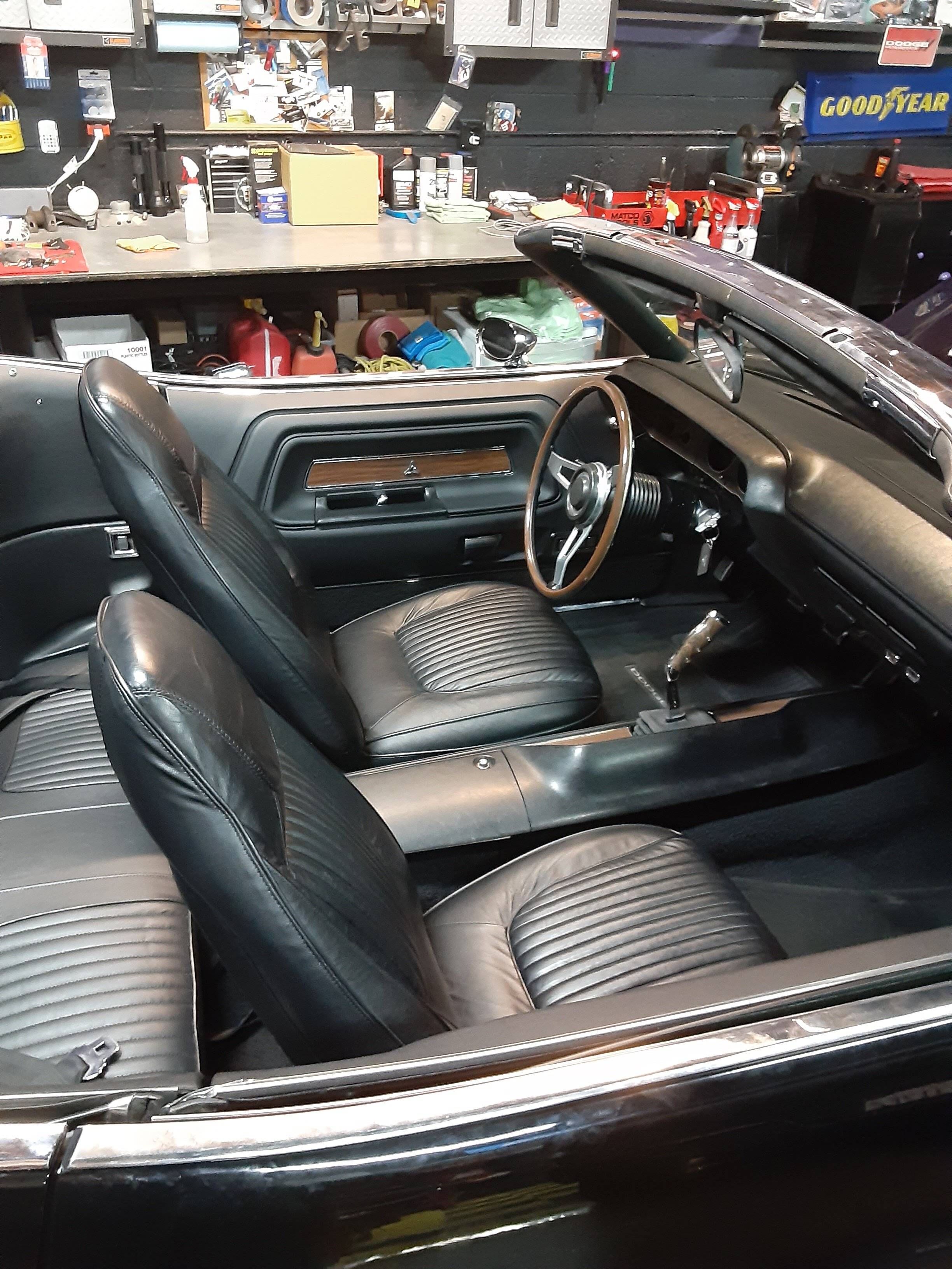

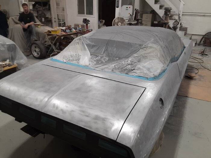

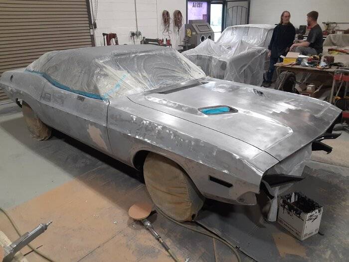

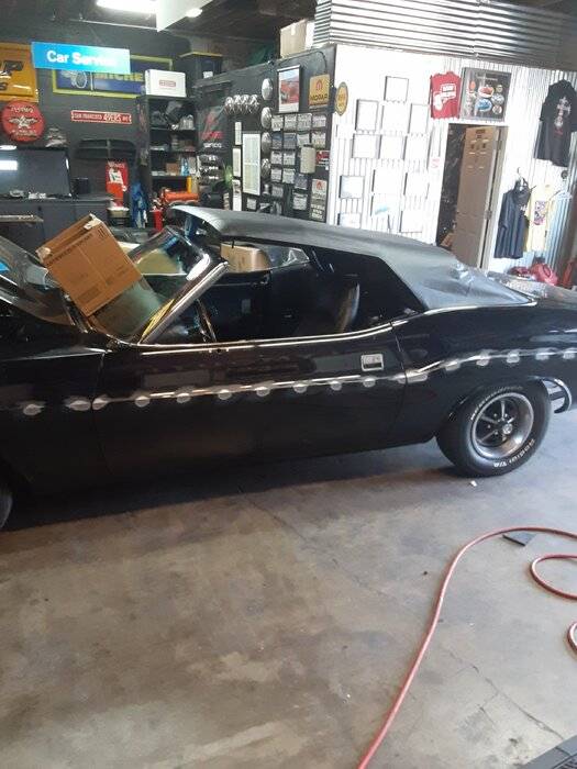

Thanks again for a great referral.I have ordered parts from them in the past and they always show up to the MOPAR shows with lots of hard to find items. I spoke with Ed this morning he is going to send me some clips that should work and he has the reflectors for my door panels that I have been searching for. A good morning. I attached some photos of the TXP Challenger in progress

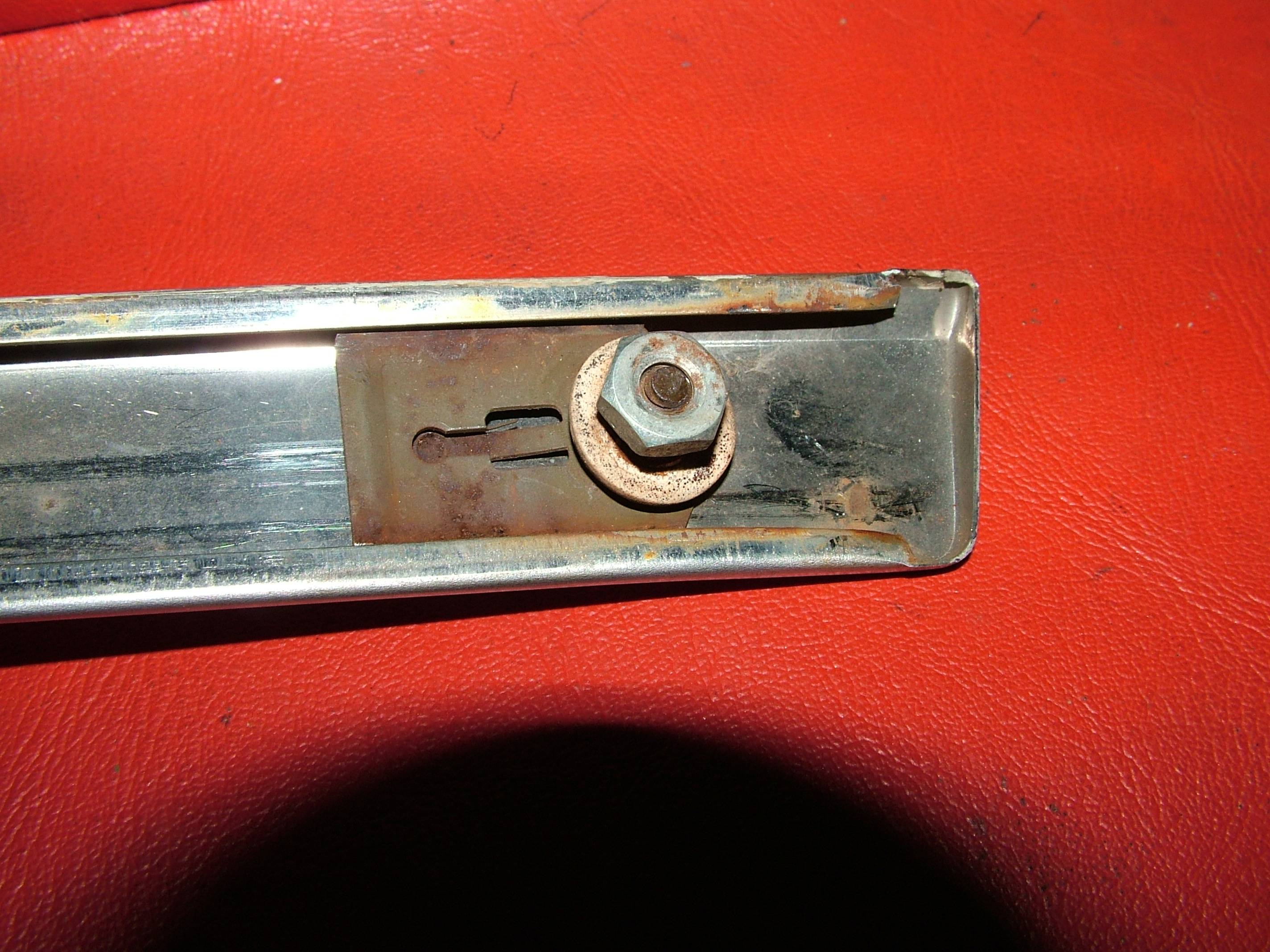

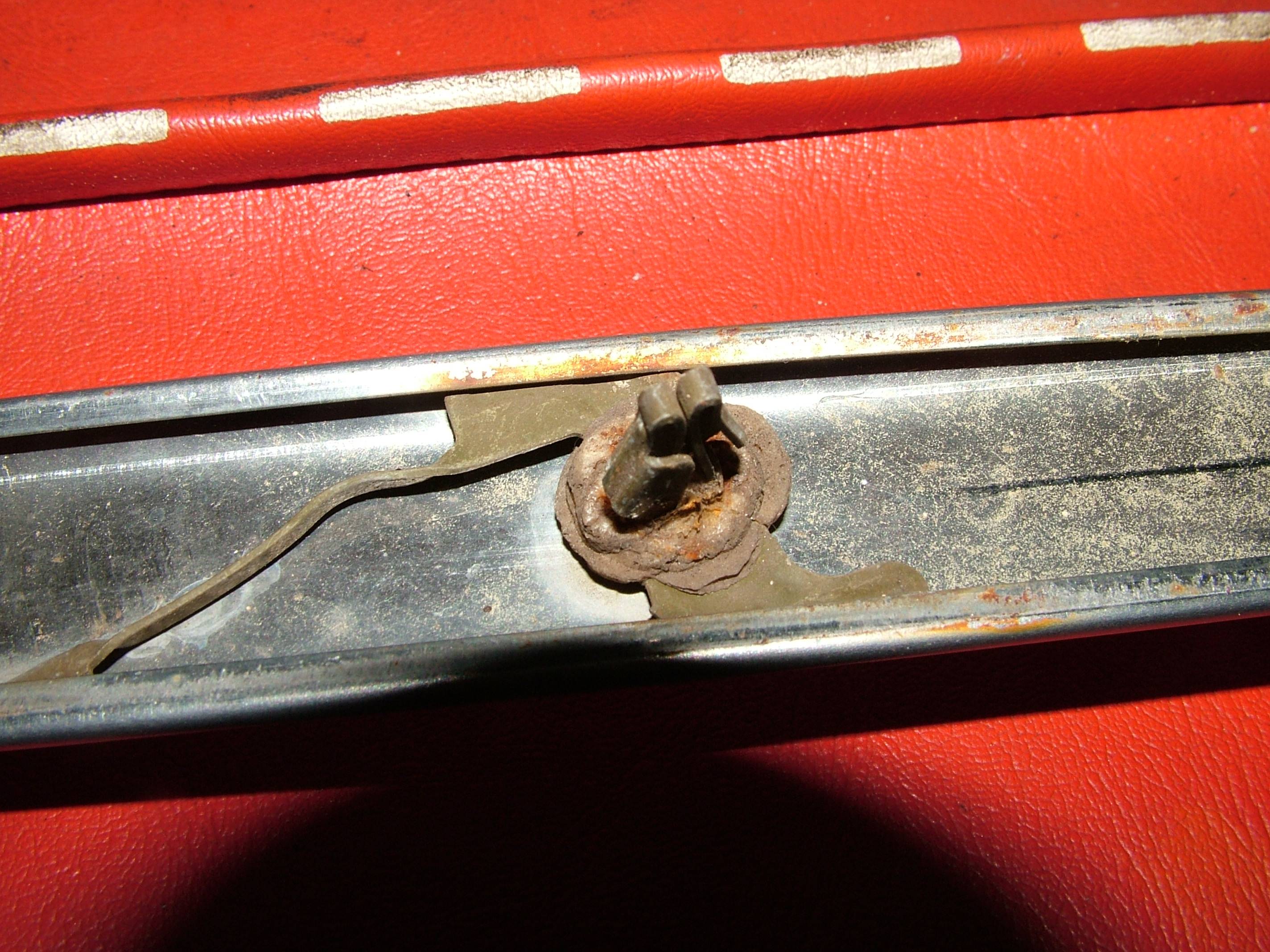

Andy, here are the correct clips and what was on my car.
The one with the stud and nut go on the moulding ends.

althafastner.com Just looked on the 19th shows they have the clips that go into the holes, clip goes in and center plug pushes the ears out making them tight.
I did not look at those clips, but I believe those are for the body side mouldings. Andy is looking for the top of door mouldings and by the quarter windows. They are called belt mouldings. See my post above.
Ok, it appears to be different than a later cuda with belt mounding
the ends looks the same with a threaded stud and nut though.
Got it, yea I was thinking the door belt bright.

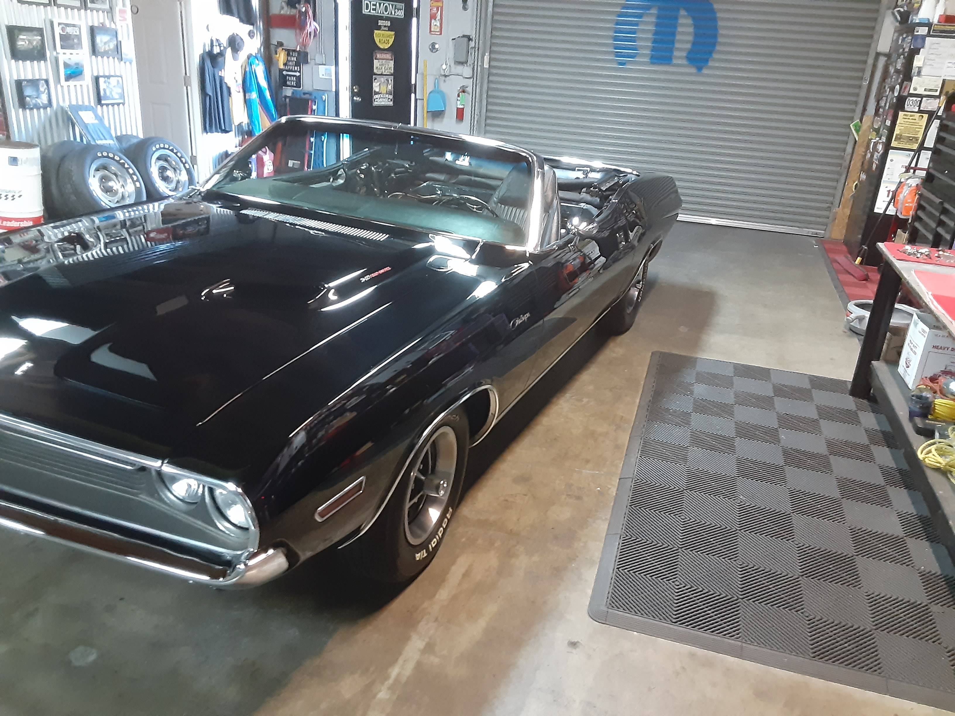

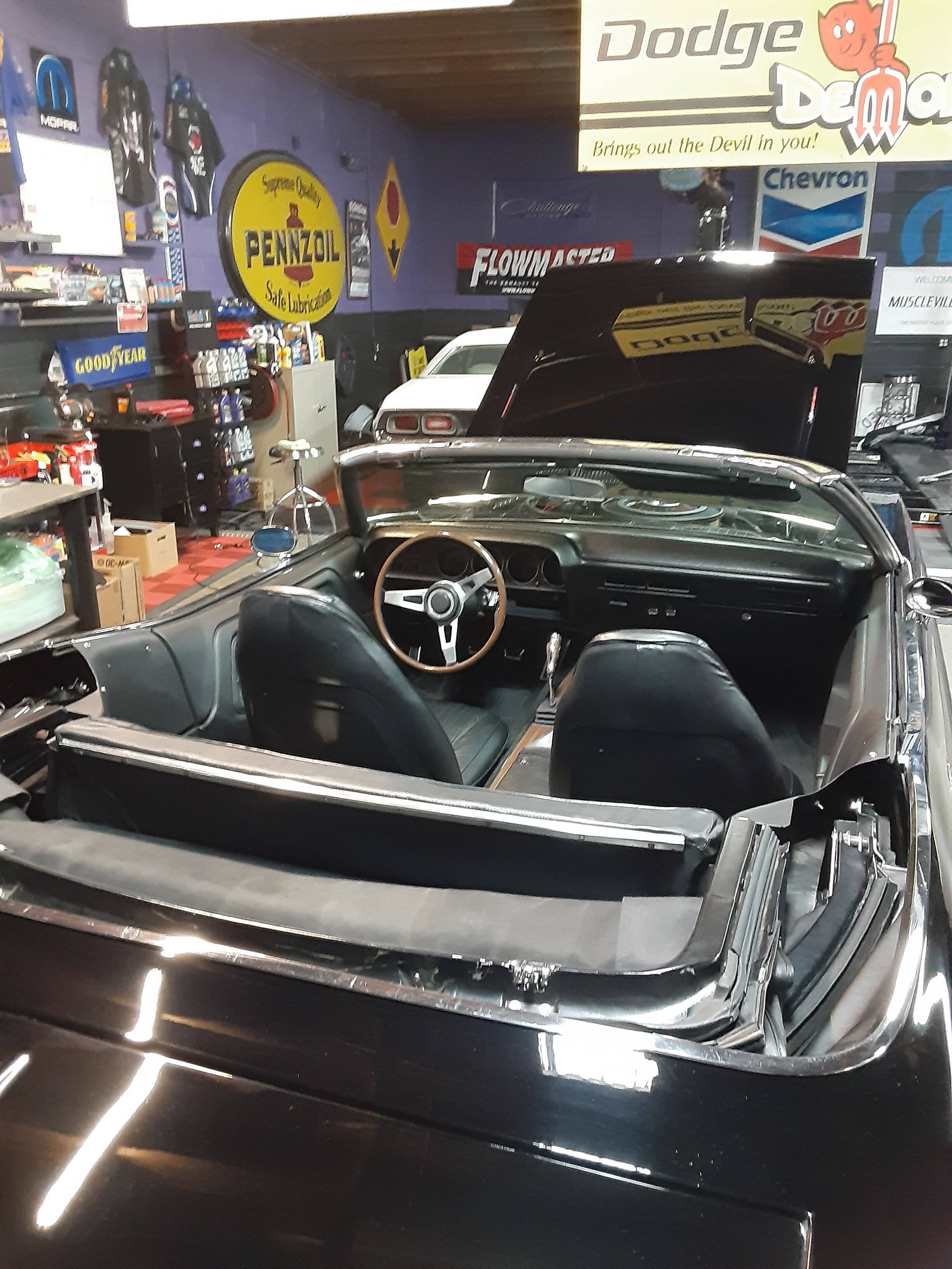

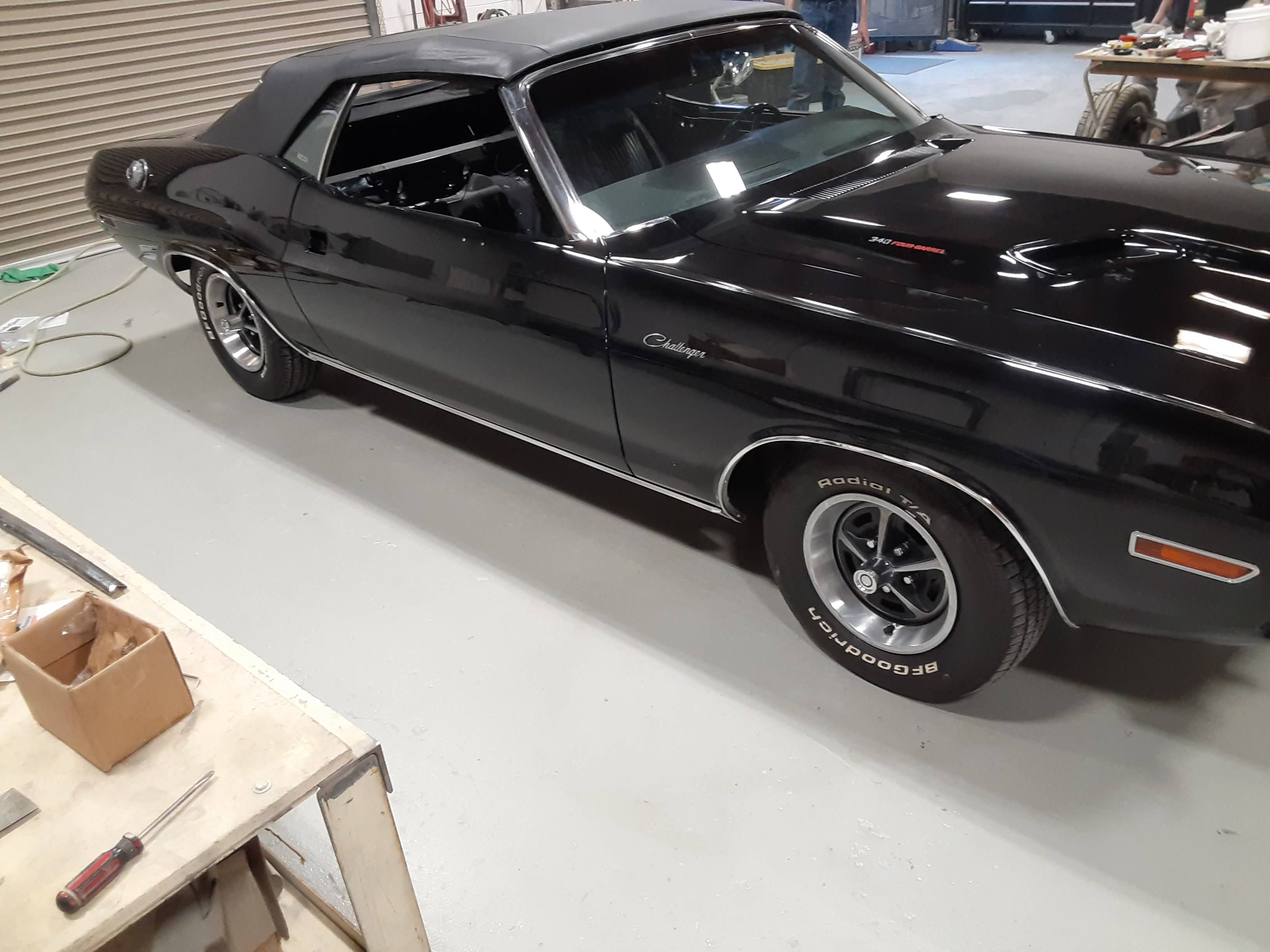

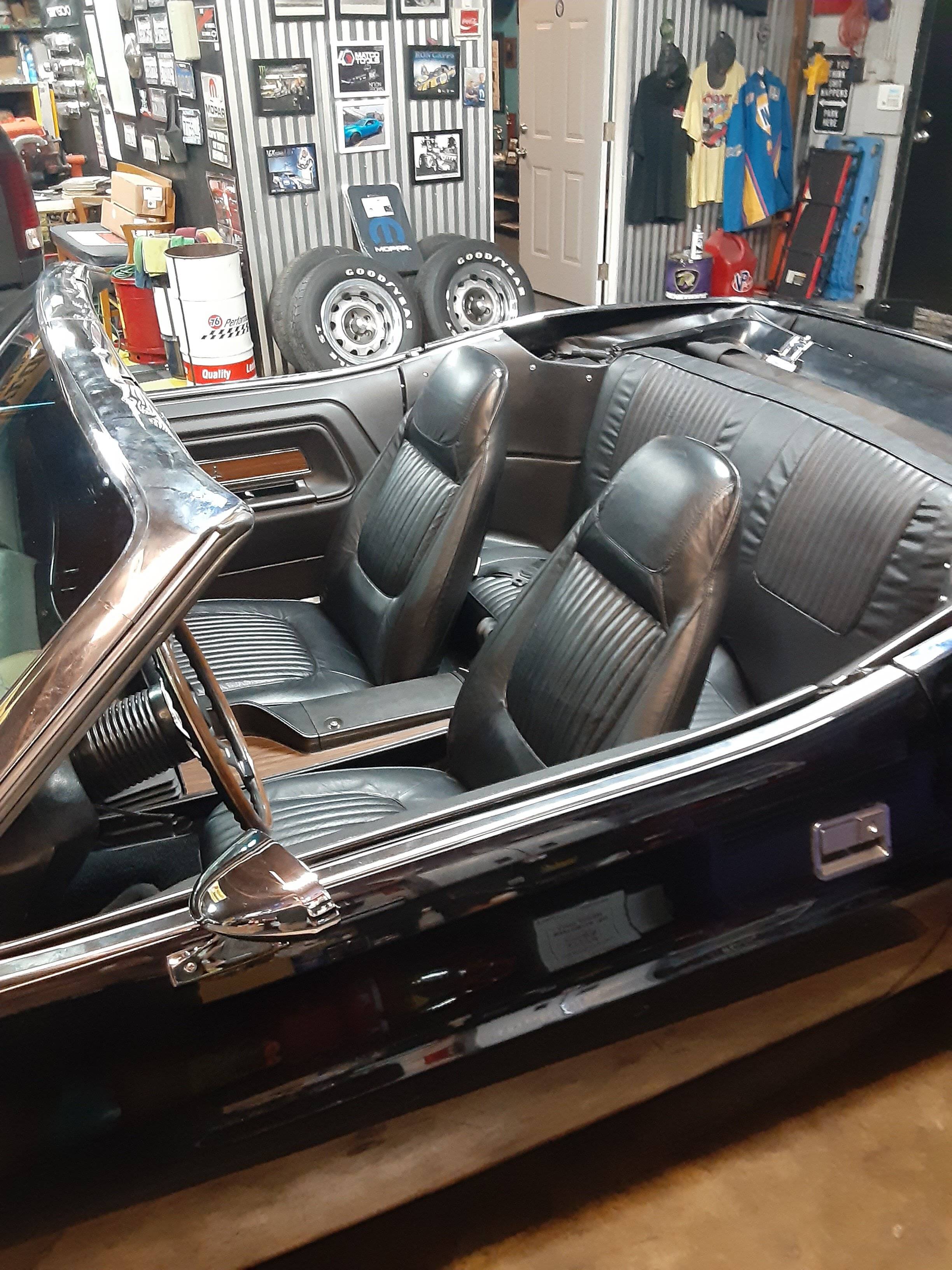

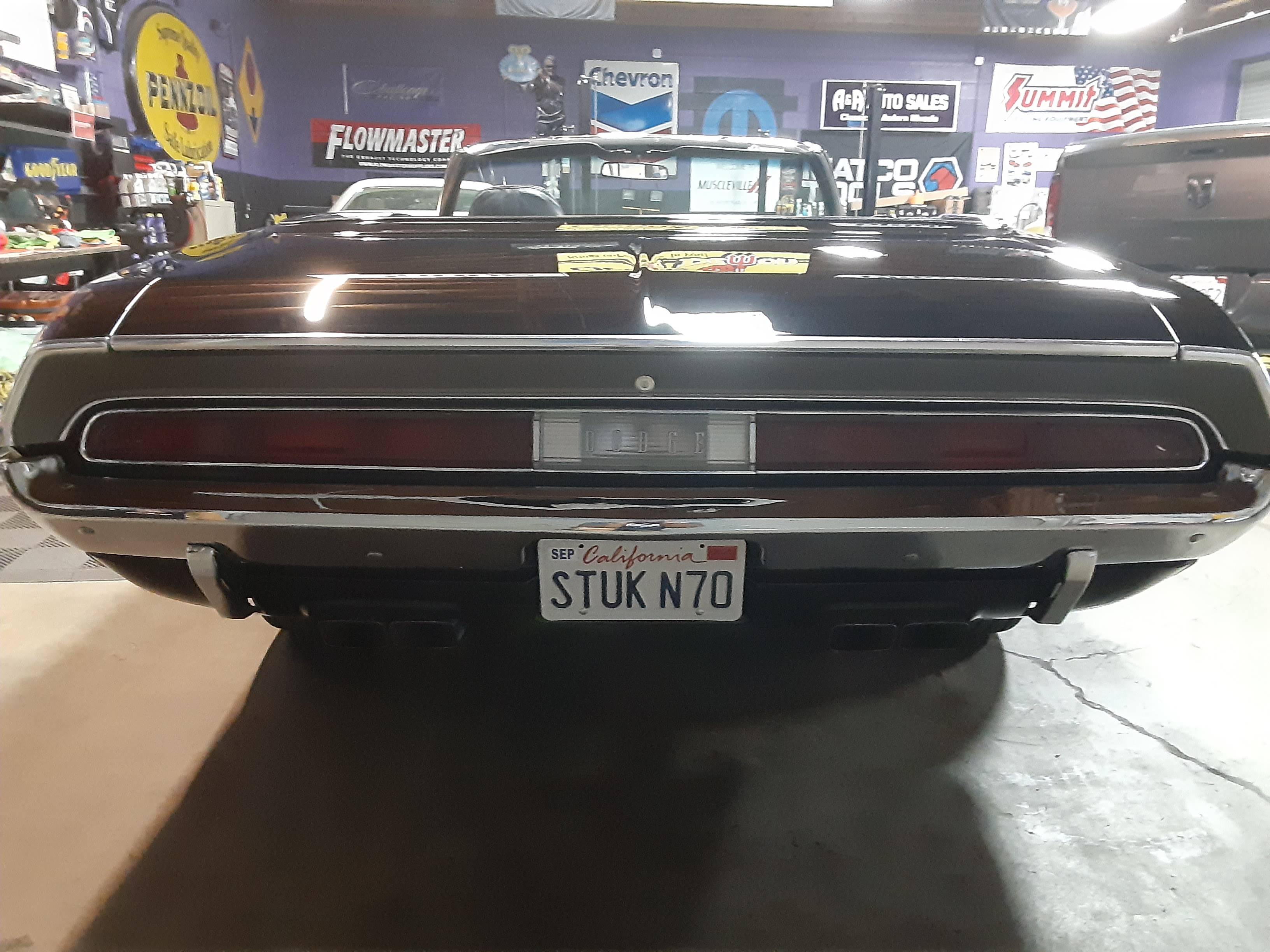

Thanks for the help and the info. Ed at the MOPAR shop sent me two different clip options. One set was metal an the other was plastic. They both worked but the plastic worked better. We did have to hone out the holes a little to have them go in easier without damaging the trim. Ed also set me up with some clips off an A body tail panel that worked on the rear tail panel with a little modification. So here are some pictures all the trim is on and put the interior in today. Tanks again for the input I do appreciate it
