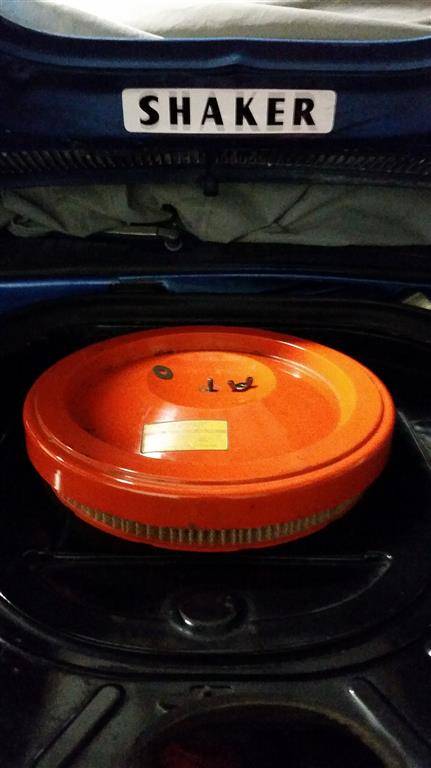

Sep 17, 2021 #2 70chall440 Well-Known Member Joined Dec 11, 2010 Messages 1,261 Reaction score 986 Location Western Washington A shaker hood/bubble has its own air cleaner base/system. You cannot use anything else without a significant amount of fabrication.

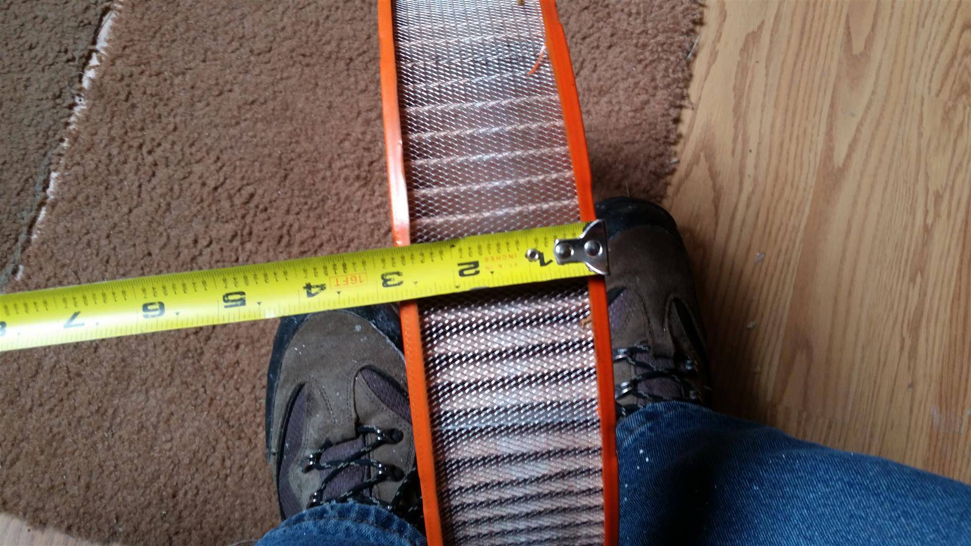

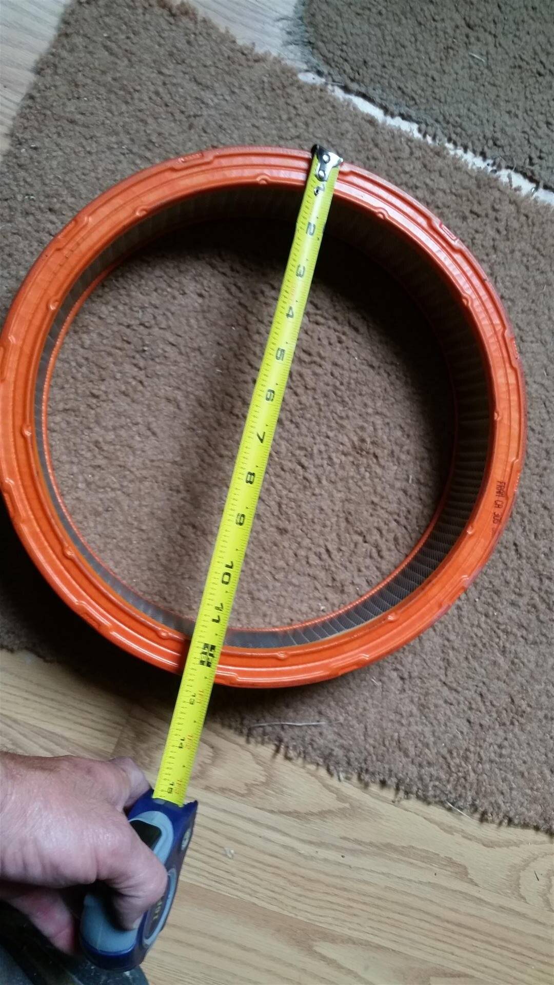

Sep 17, 2021 #4 T terrywalker Well-Known Member Joined Aug 31, 2013 Messages 593 Reaction score 410 Timbowtie said: thank you Click to expand... These photos may help. TerryW.
Sep 17, 2021 #5 T terrywalker Well-Known Member Joined Aug 31, 2013 Messages 593 Reaction score 410 In my photo is a FRAM CA 305 filter element. WIX filter 42044 crosses over to Fram. Terry W. Last edited: Sep 17, 2021
