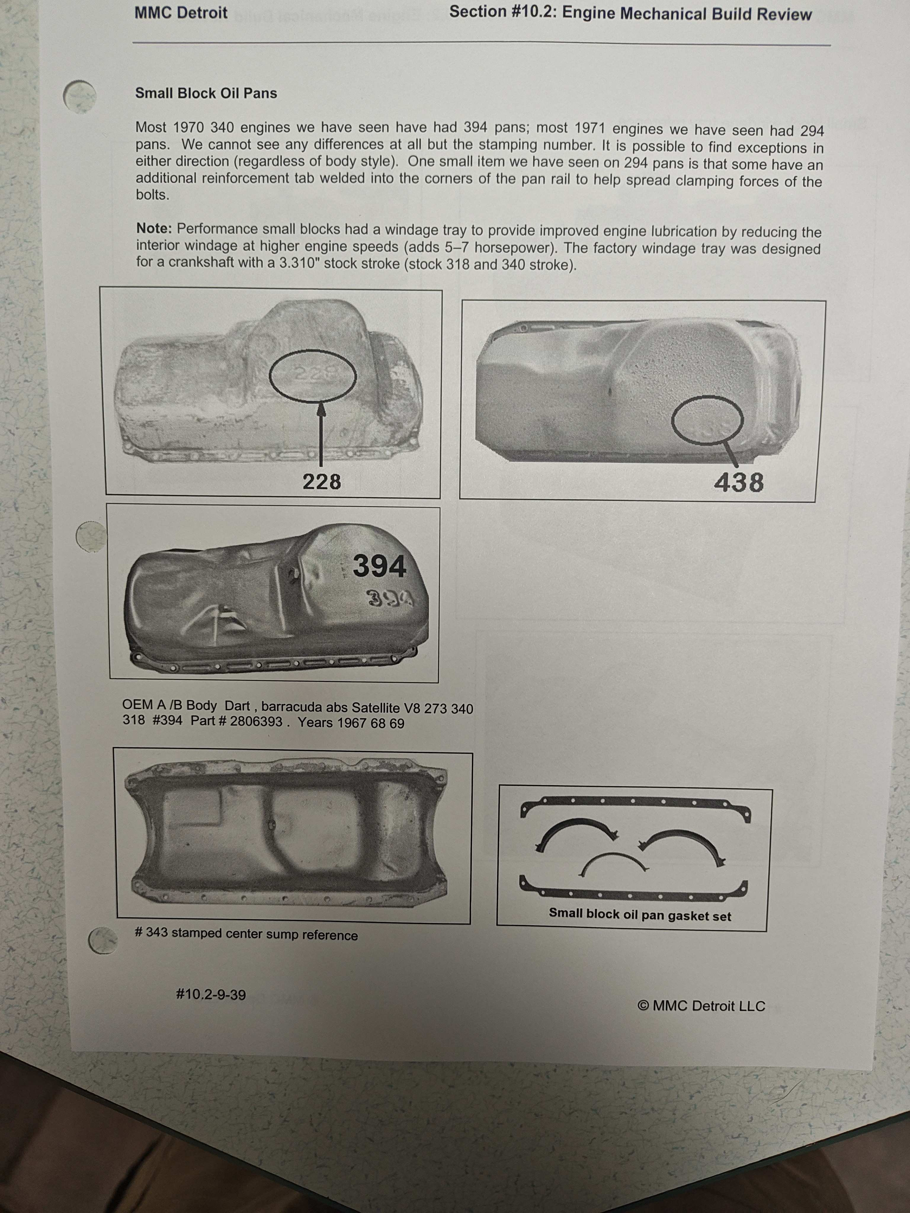

May 12, 2024 #1 K KennyCuda Well-Known Member Joined Aug 3, 2020 Messages 412 Reaction score 61 What's the correct numbers stamped on the bottom of a TA Challenger oil pan ?
May 12, 2024 #2 Xcudame Well-Known Member Joined May 27, 2023 Messages 2,506 Reaction score 1,847 Location Southeast Arizona See below from MCC:
May 12, 2024 #3 K KennyCuda Well-Known Member Joined Aug 3, 2020 Messages 412 Reaction score 61 Great Thanks You
May 13, 2024 #4 floyd Well-Known Member Joined Mar 18, 2012 Messages 453 Reaction score 302 I’m pretty confident that 294 pans are correct for T/A motors. I’m away from my references but can post some supporting info later.
May 13, 2024 #5 Xcudame Well-Known Member Joined May 27, 2023 Messages 2,506 Reaction score 1,847 Location Southeast Arizona Basically nothing special for a 340 oil pan that wasn't also on the 318.
May 13, 2024 #6 floyd Well-Known Member Joined Mar 18, 2012 Messages 453 Reaction score 302 Xcudame said: Basically nothing special for a 340 oil pan that wasn't also on the 318. Click to expand... Agree that pan is not special. It’s my opinion that MMC is a bit off on the timing of 394/294. I think 294 is correct for 70-71 340s including T/As. I’m definitely NOT suggesting that a 294 is a “T/A oil pan”. The gougers will feed off such a suggestion
May 13, 2024 #7 K KennyCuda Well-Known Member Joined Aug 3, 2020 Messages 412 Reaction score 61 so if I change it I should go with the 294 pan ?
May 13, 2024 #8 floyd Well-Known Member Joined Mar 18, 2012 Messages 453 Reaction score 302 If you care about numbers, I’d use a 294 on a T/A motor. If numbers aren’t a big deal, a 394 will work just as well.
May 13, 2024 #9 Xcudame Well-Known Member Joined May 27, 2023 Messages 2,506 Reaction score 1,847 Location Southeast Arizona Even though MCC says differently, I agree with Floyd, as he has never steered anyone wrong!
