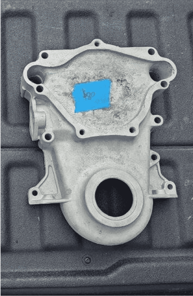

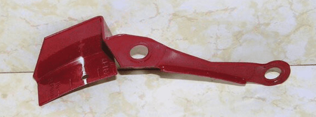

The 1964-1968 273, 1967-1968 318LA, and 1968 340 were equipped with the separate tab on the passenger side with matching damper, or harmonic balancer, for the driver hose inlet cast iron water pump. The following images show the timing cover for the 1964-1968 applications and the separate timing tab the separate bolt on tab:

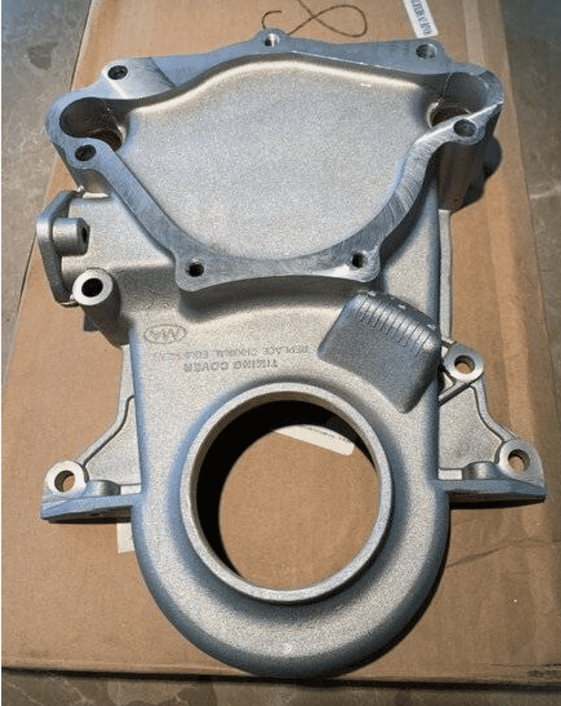

1969 and some late 1968 LA engines including the 273, 318, and 340 have the timing "tab" cast into the cover housing on the passenger side, and a matching marked damper. The following image shows the 1969 and late 1968 cover:

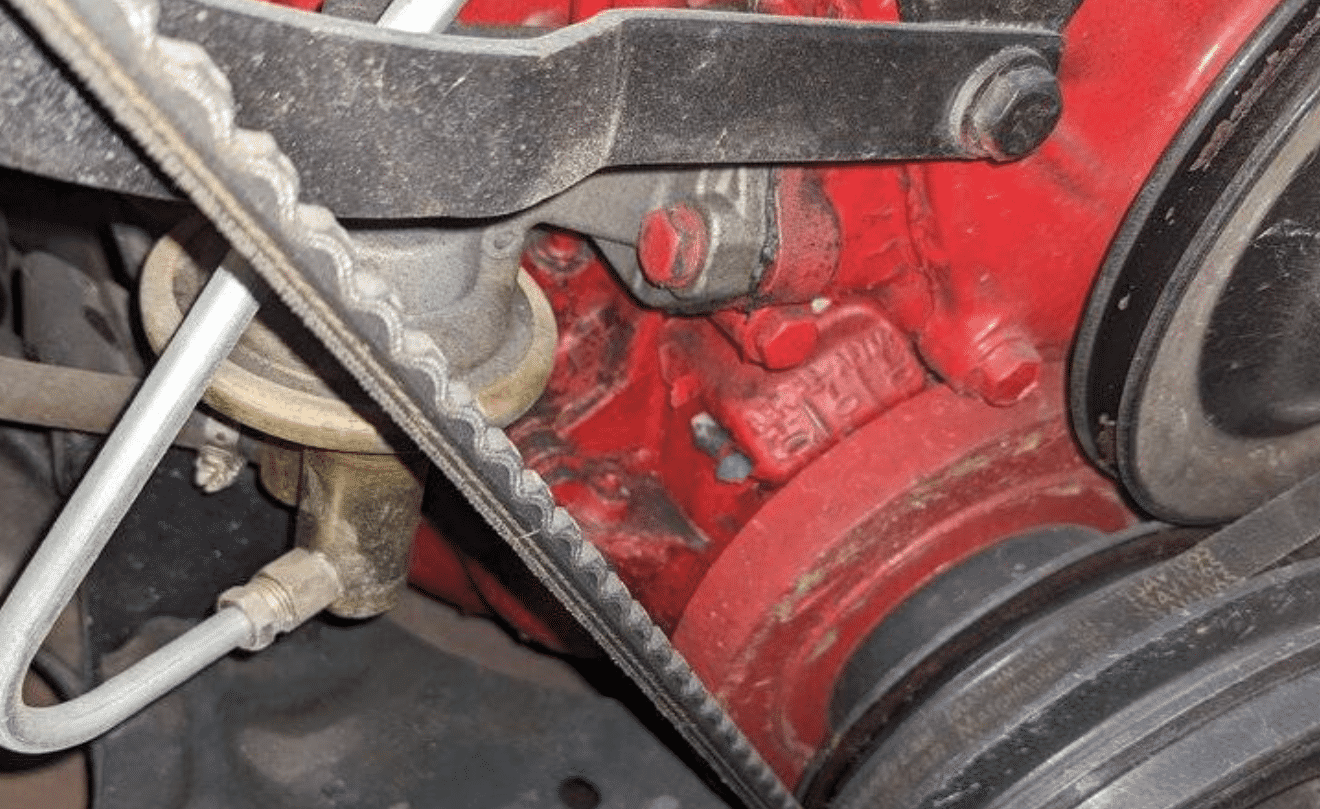

The following image shows an installed 1969 340 timing mark setup:

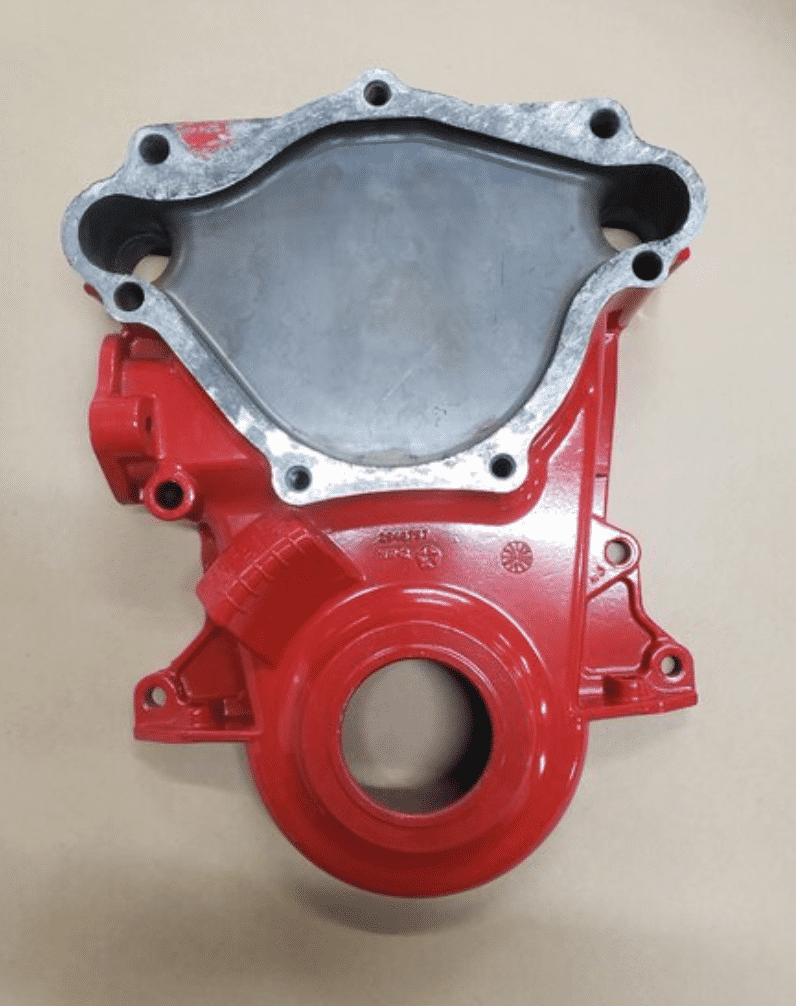

The cast in timing "tab" was relocated to the driver side for 1970 with the new aluminum water pump with hose inlet on the passenger side along with matching damper with relocated marks. This cover was used through 1991 on the LA engines, although it was revised starting with the 1978 318 engines to allow the seal to be replaced without removing the cover.
The following image shows a 1970-1977 timing cover:
The following image shows a 1978-1991 timing cover:
