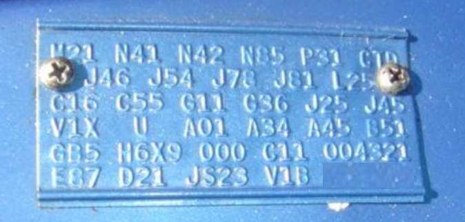

I have a 1970 383 Cuda 4 speed car with factory A/C. I want to see the fender tag or broadcast sheet of a 1970 mopar with these two options. Its been impossible. Anybody able to help me or direct me on how to find one (or more)?

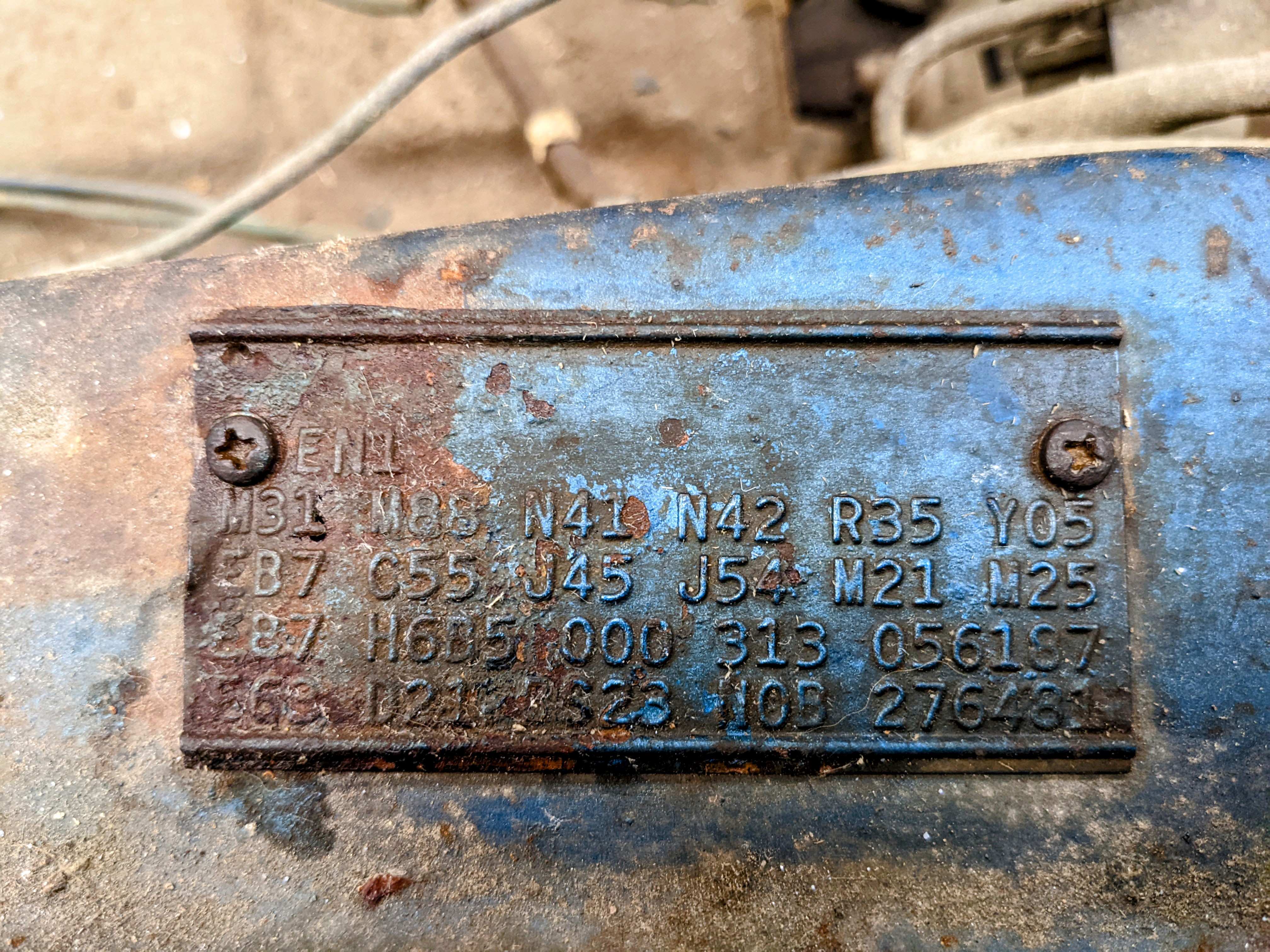

I have a 1970 4 speed with A/C but it is a 340 car. Not sure in your wording above if the engine size was important.

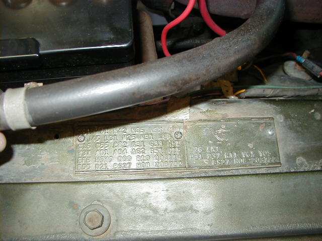

For the time being. This is a 383 4sp. H51 is the code for AC. This is MOPARMITCH'S tag and sheet.​

Thanks. I do not think engine would matter for my purposes. I was trying to see if there was a specific “Y” code associated with this combo. From what I am experiencing is it’s very rare to get both options. I do not think cars were delivered to dealerships with this combo and think someone would have to specifically order it maybe having a specific Y code associated with it?
