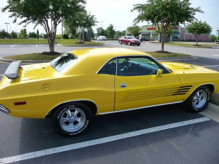

Good morning. I have a 340 in my 72 Challenger and plan to install a 440 engine. Is there anything that I should know before I do all of this that would help me avoid pain and sorrow? What about the motor mounts? I plan to put a new Holley 650 CFM on it. I would think that should be enough. I will install a high performance cam to give it a little sound. What about the exhaust? I recently put new exhaust on the car before I got the 440.
Any advice would be appreciated. I am excited about the change. I plan to drop the 340 in a 73 Dodge Dart Sport (Demon) with a rebuilt 727. It is a work in progress.
