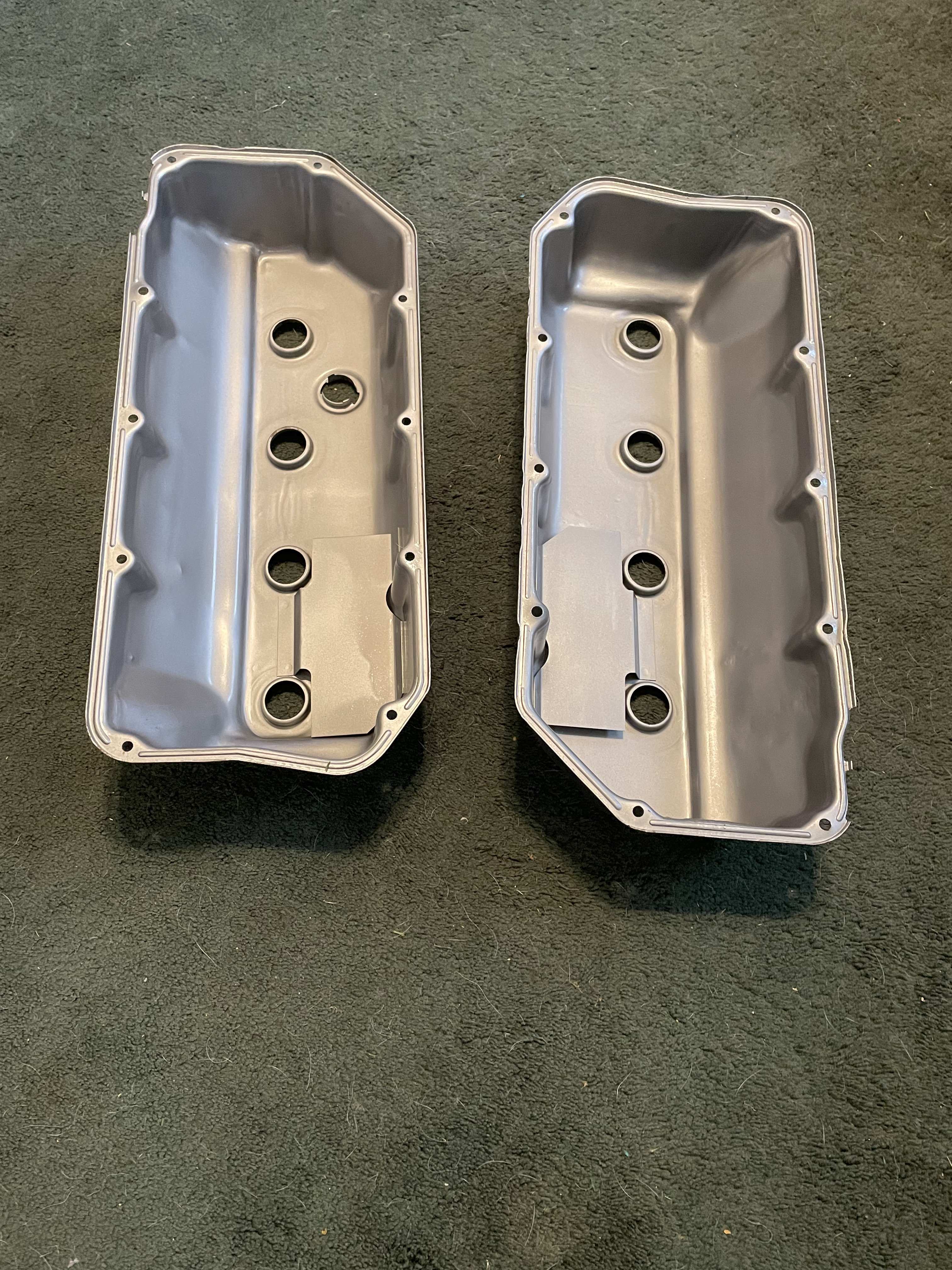

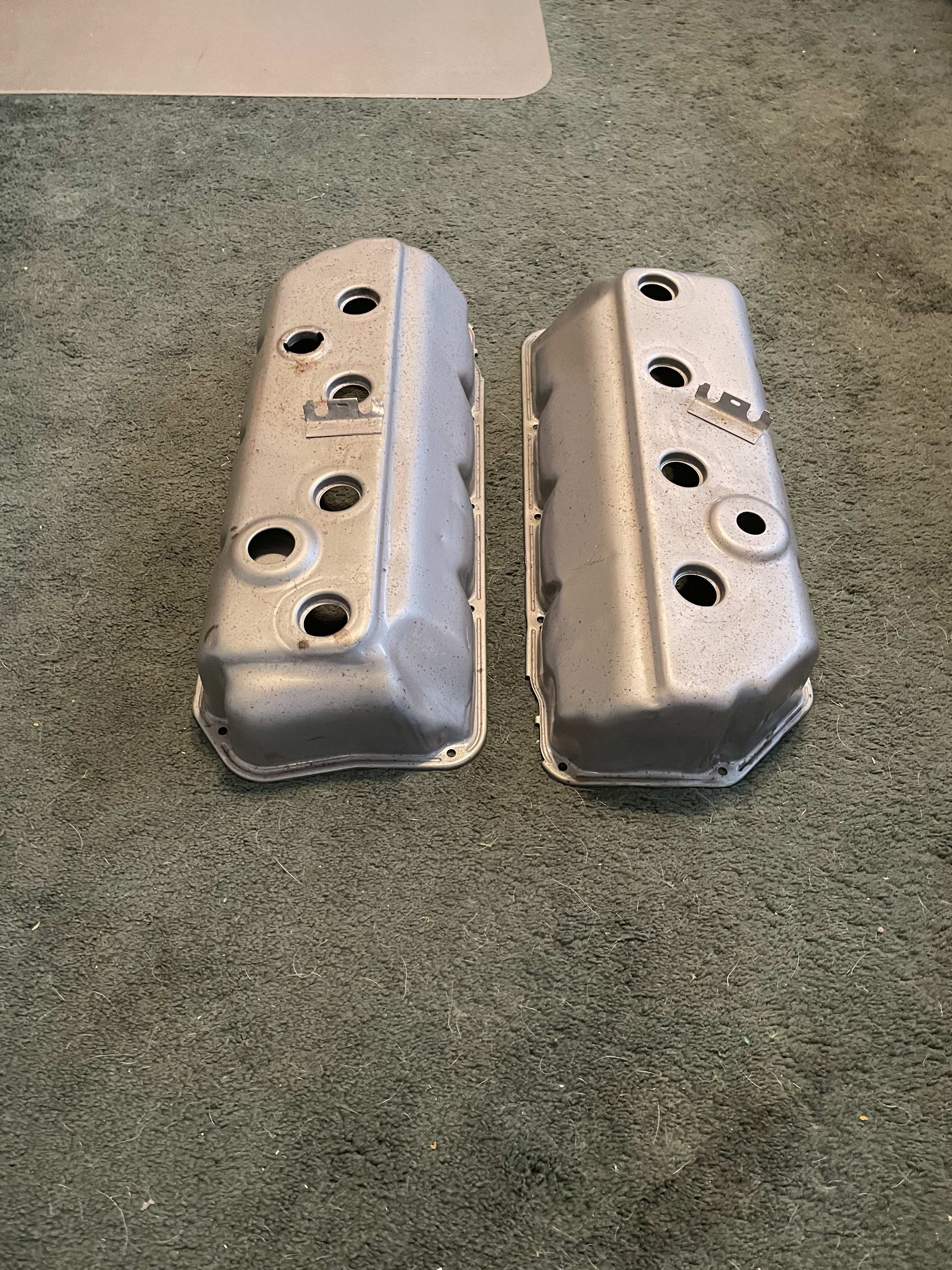

Does anyone know how to properly get the “black wrinkle” finish on hemi valve covers? Special paint?
I have a set that I got a few years ago for my build, stripped them to restore and then ended up finding a NOS pair from Mopar Performance that were bolt on ready. I am going to finish cleaning these up and paint them.

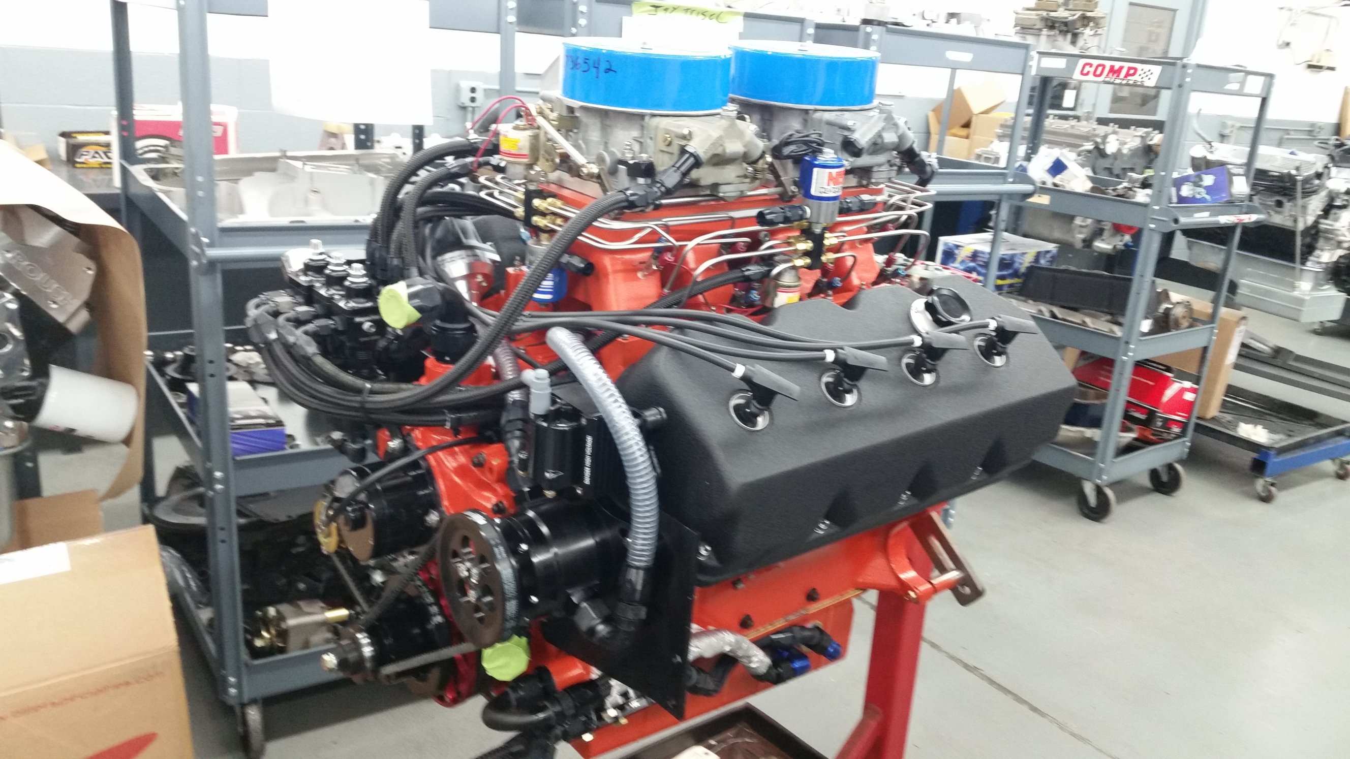

I painted mine with the VHT and baked them under some heat lamps that we have here at work. They came out perfect. These were a polished pair of rocker covers that I media blasted in a cabinet.
