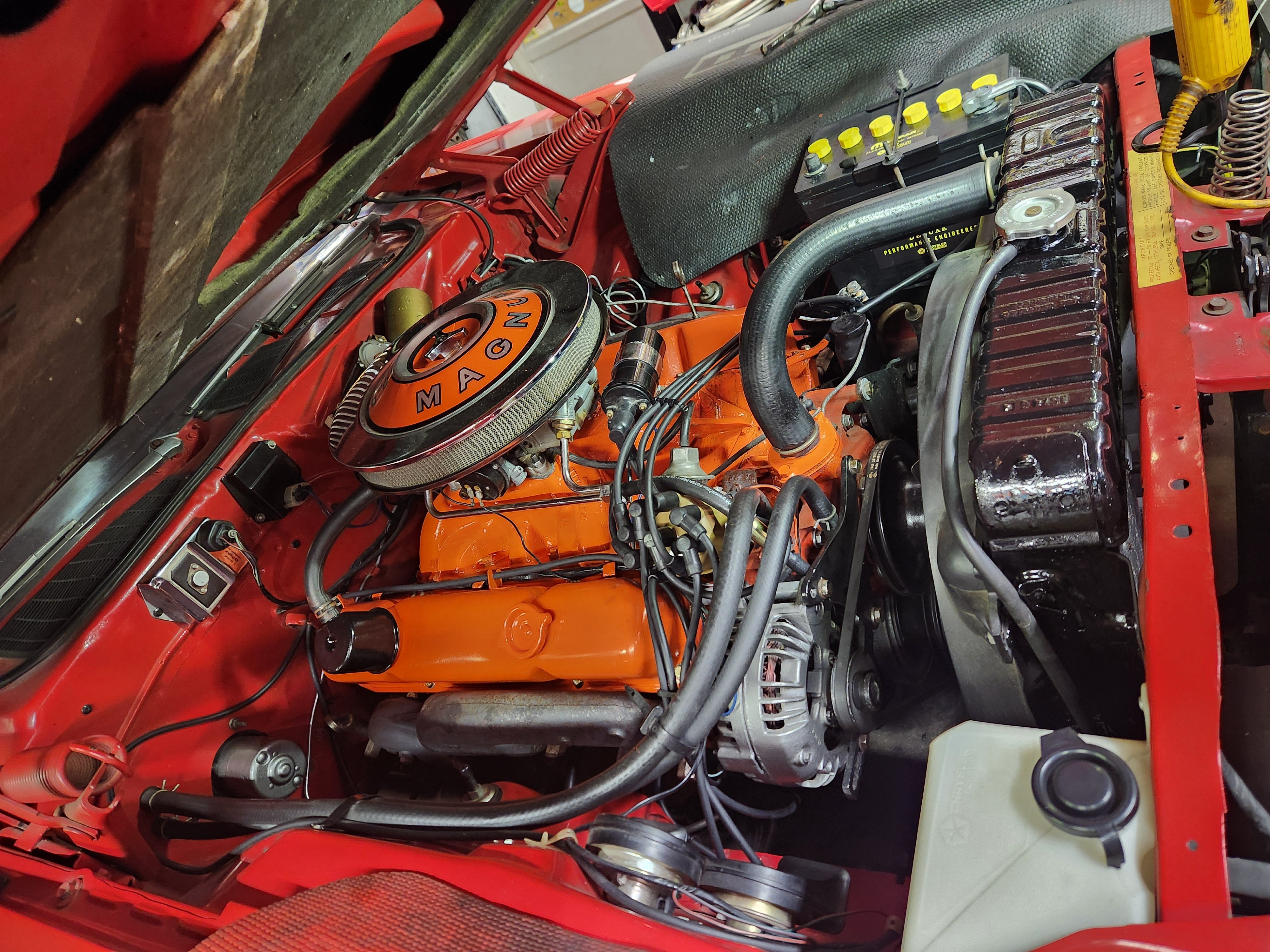

I have what I believe is a later A body over flow in my red 70 Challenger. It came on the car when purchased it. I just put it back on after redoing the engine bay. On my blue 70 Challenger I have a billet aluminum aftermarket overflow (required for track use) as nothing is stock about this car.
