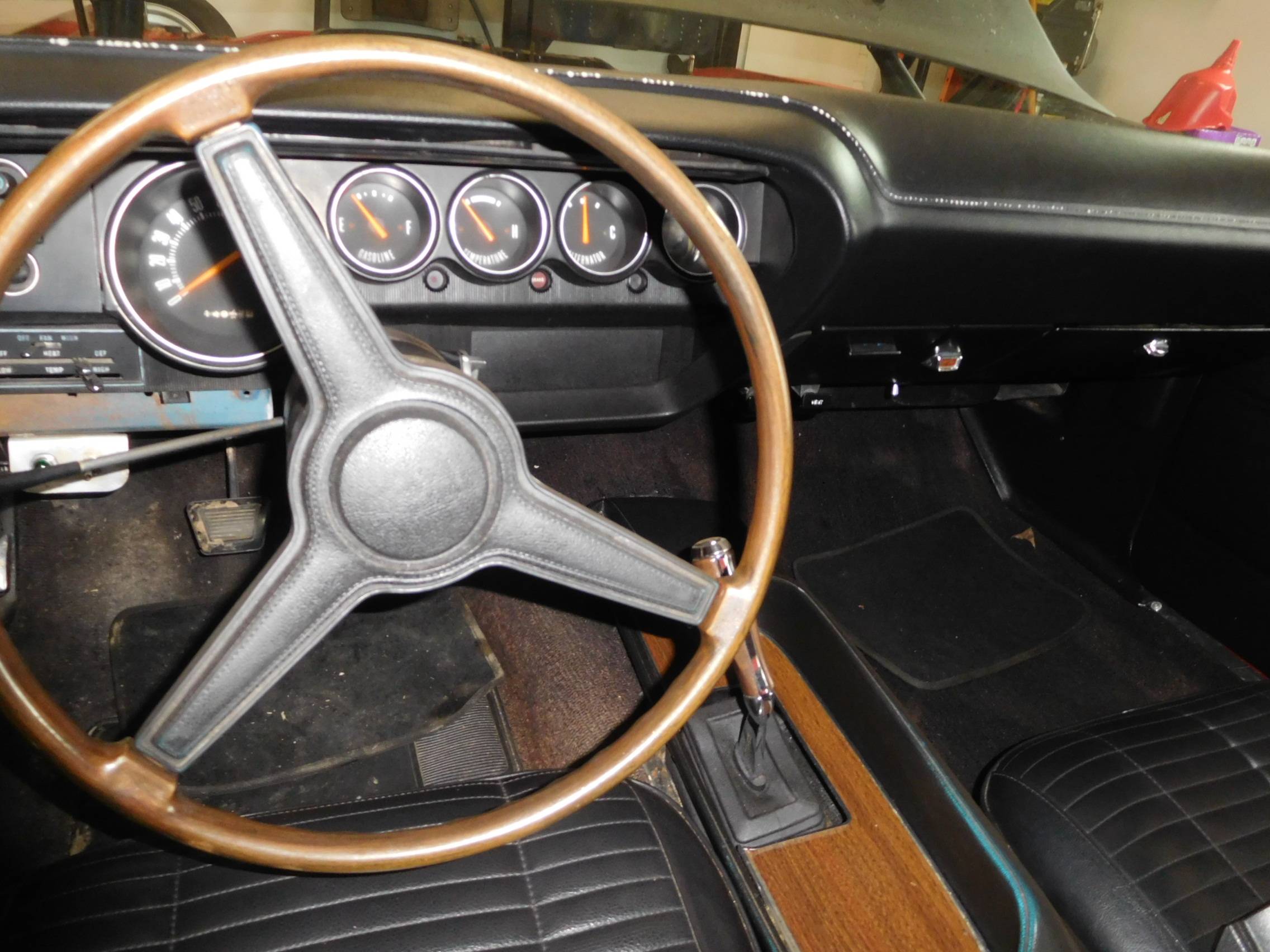

My T/A doesn't have a rallye gauge package and has no clock in the far right position. Someone shoe horned a pitiful oil temperature gage into it, which does not work and is recessed too far to the rear to read anyhow. My question.........I can order a clock delete from YearOne.....has anyone attached a 2.5 inch gage to a delete plate to mount a gage in that position? It seems like a no brainer, but I haven't heard of anyone doing it. I also have a radio delete plate and have considered adding a mini 3 gage package (1.5 inch gages) in that position....cut out a plate to match the original, of course....not cutting up original.

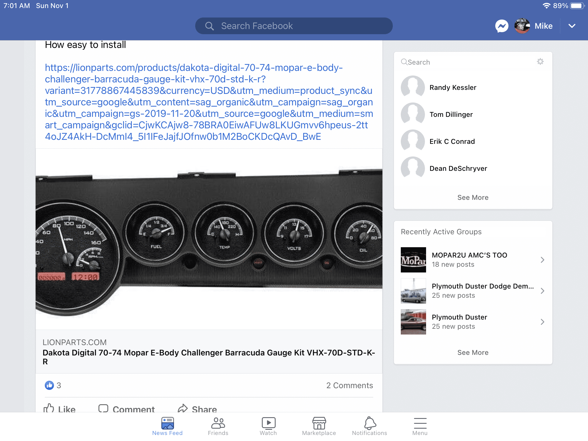

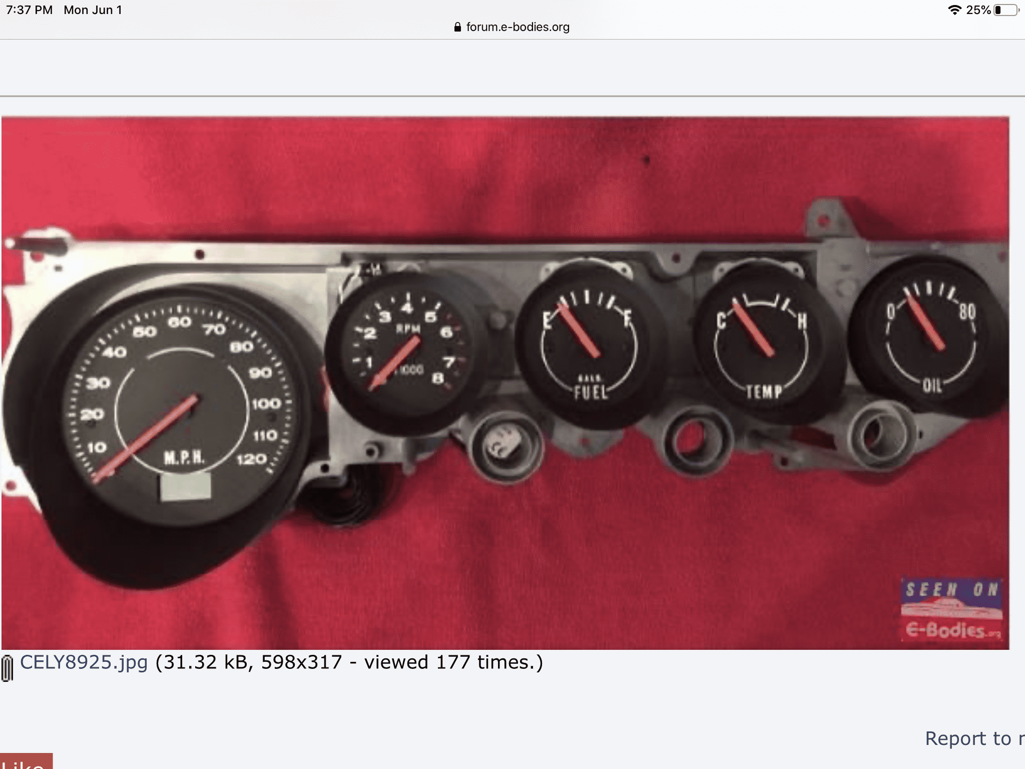

There are companies that make custom gauges for these standard dashes. Here’s a couple referenc pics. Some swap the Ammeter for a volt gauge which I like. The tach is nice too when installed by the Speedo and pushing the others over. And of course an oil pressure gauge would be nice.

I like the custom dash format, Beekeeper, but not at the prices. I think I'll proceed to add an oil pressure gage to the delete plate and see how it works. Will maintain the oem look anyhow if I can come close to matching the factory gages.
