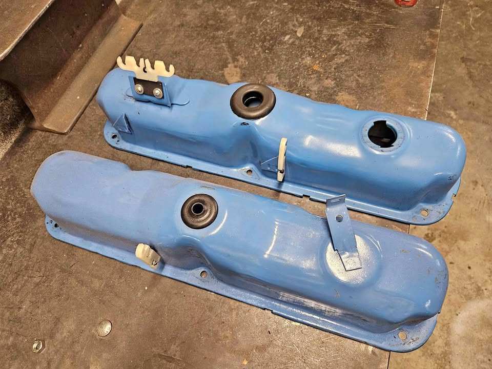

Do these look right for a 71 340
The pictured valve covers are 1973 or later.
The bracket with the plug wire separator and bracket bolted to it is actually the mount for the vacuum amplifier that was introduced in 1973 and used into the 1980s. The upper plug wire separator tab on the other valve cover is different than earlier as well.
