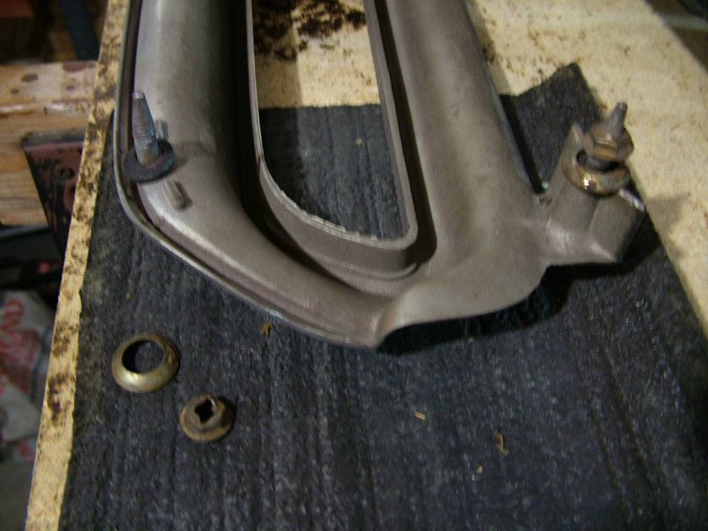

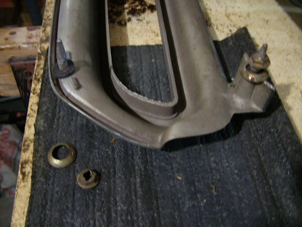

The two tail light housings are held in place with #8-32 studs with #8 PAL nuts with sealant, no washer. 8 in each housing for a total of 16. Be sure to use PAL nuts for machine threads and not the thread cutting type.
For the tail light panel you do need the thread cutting type. Here is a pic of my 71 tail light panel. There is foam washer which goes on the stud first, then after the panel is on the body a special cone washer and then the thread cutting PAL nut. There are 12 of the cast in place panel studs.

OK, after getting the wrong nuts first (they are really 10-24, not 8-32), I went with KEPS nuts (captive star washer) for the housing studs. Next, I bought the 1/4" thread cutting PAL nuts from Lowes, but they seemed to have a rough time going on. They didn't want to cut a steep pitch, but rather very fine and even stall and just spin and cut without tightening unless I used a LOT of pressure downward. I only did 2 to hold it on for fear of destroying the studs and ultimately the panels. There were 2 remaining original PAL nuts with the dome washers still in place. Where can I get more of those? I'm not going to do any more with the hardware strore junk.

Ya, your'r right on the 10-24, the 8-32 are for the lenses. Sorry about that. For the PAL nuts try rtspecialties or restorationspecialties.

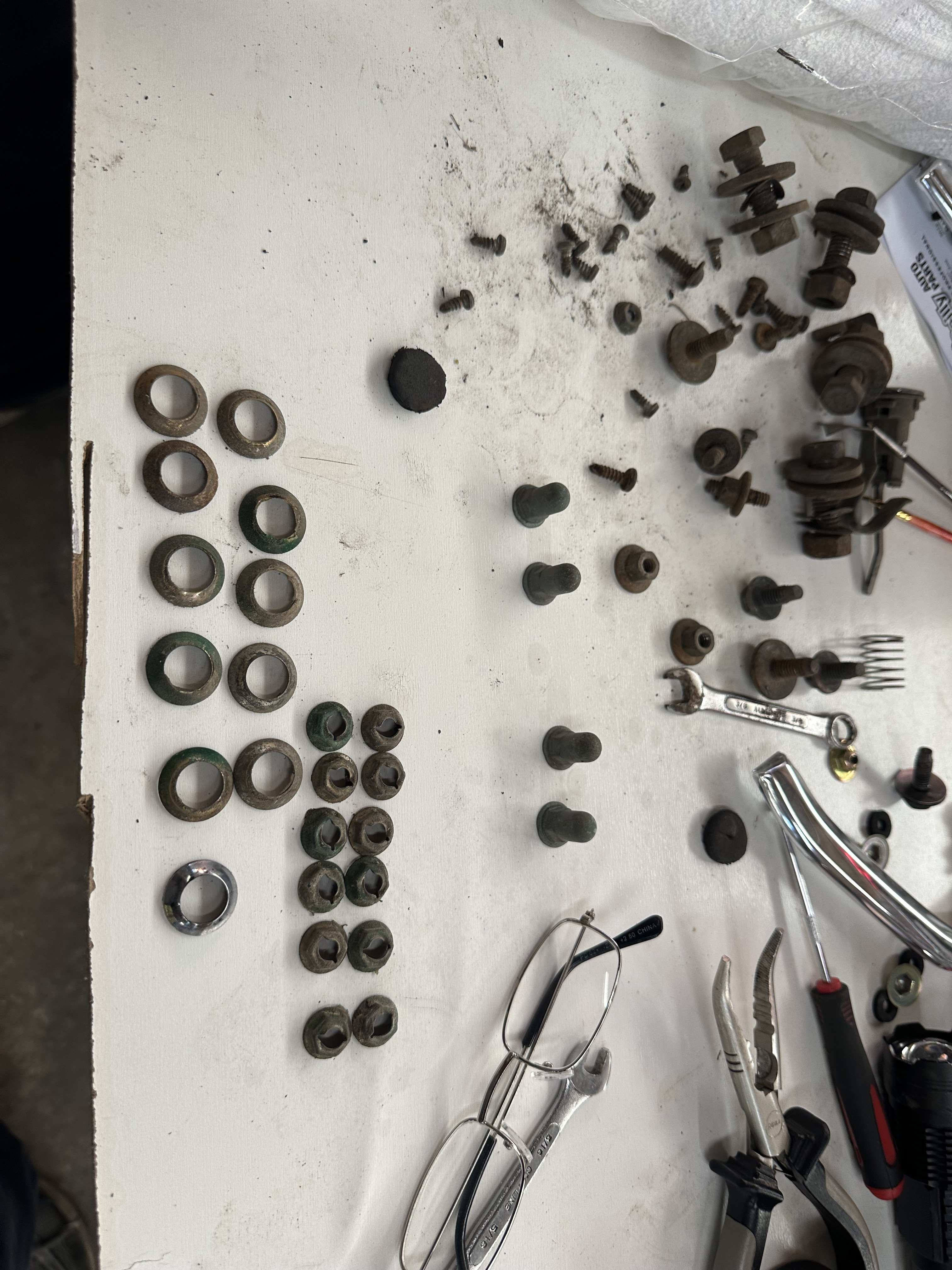

Gary Kitchens
Mar 3, 2017
118
21
I too am seeking 1 cone washer, i have everything else from the disassembly,
