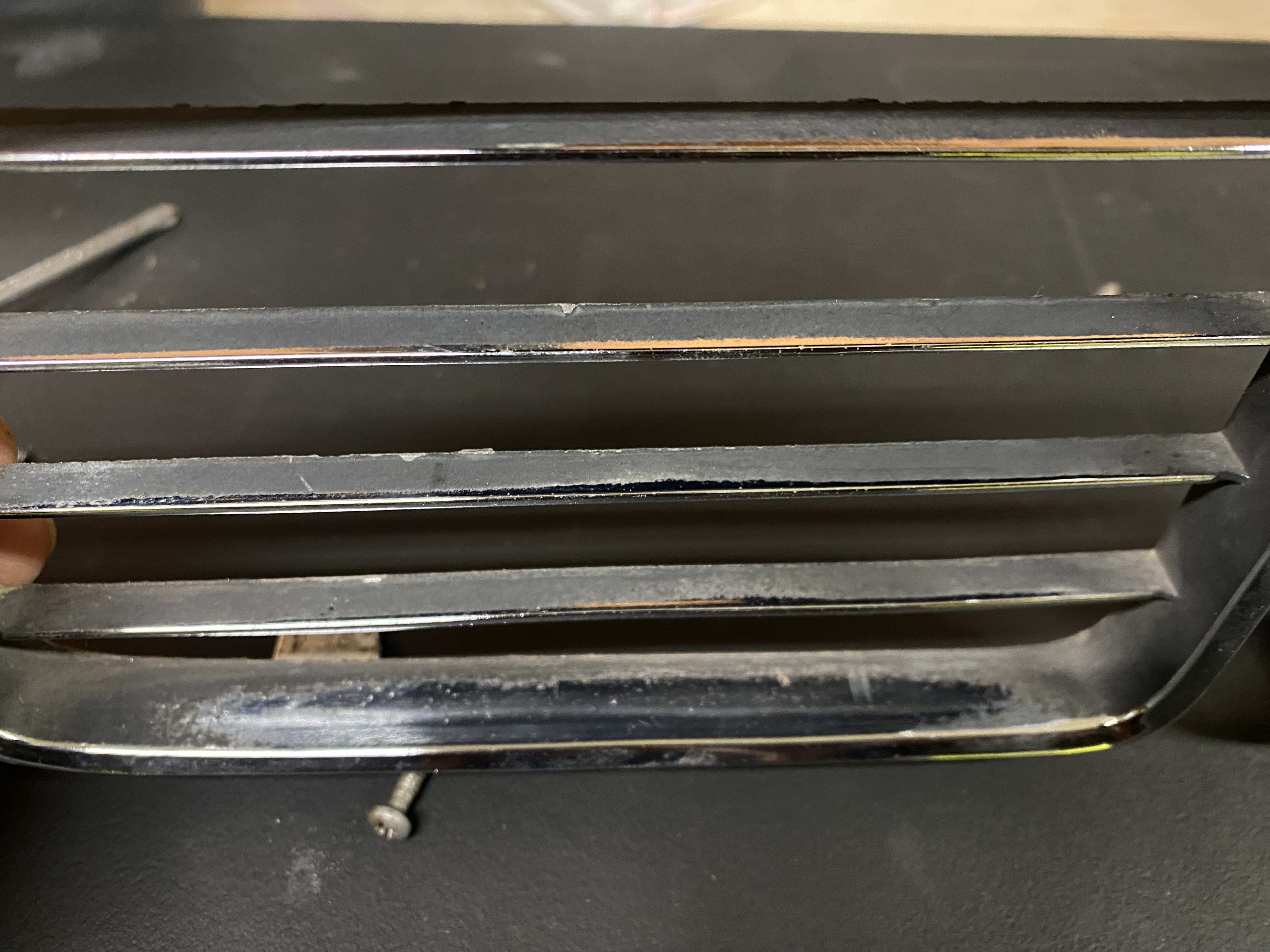

71 Cuda tail light panel was spray painted black 30 yrs ago over the factory OEM stainless steel.
How do I remove the paint? not sure if paint thinner is the right way to remove it without damaging the metal underneath. Appreciate the advice everyone.

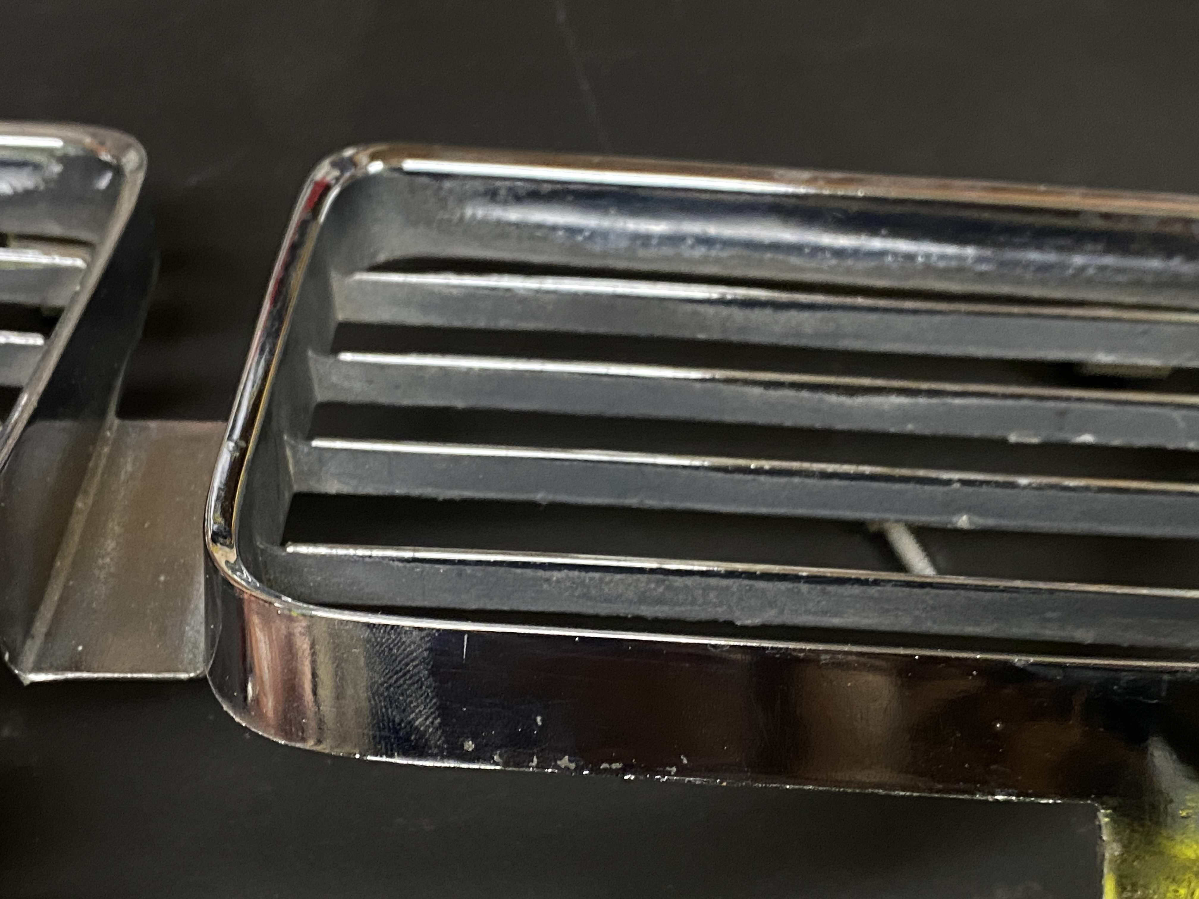

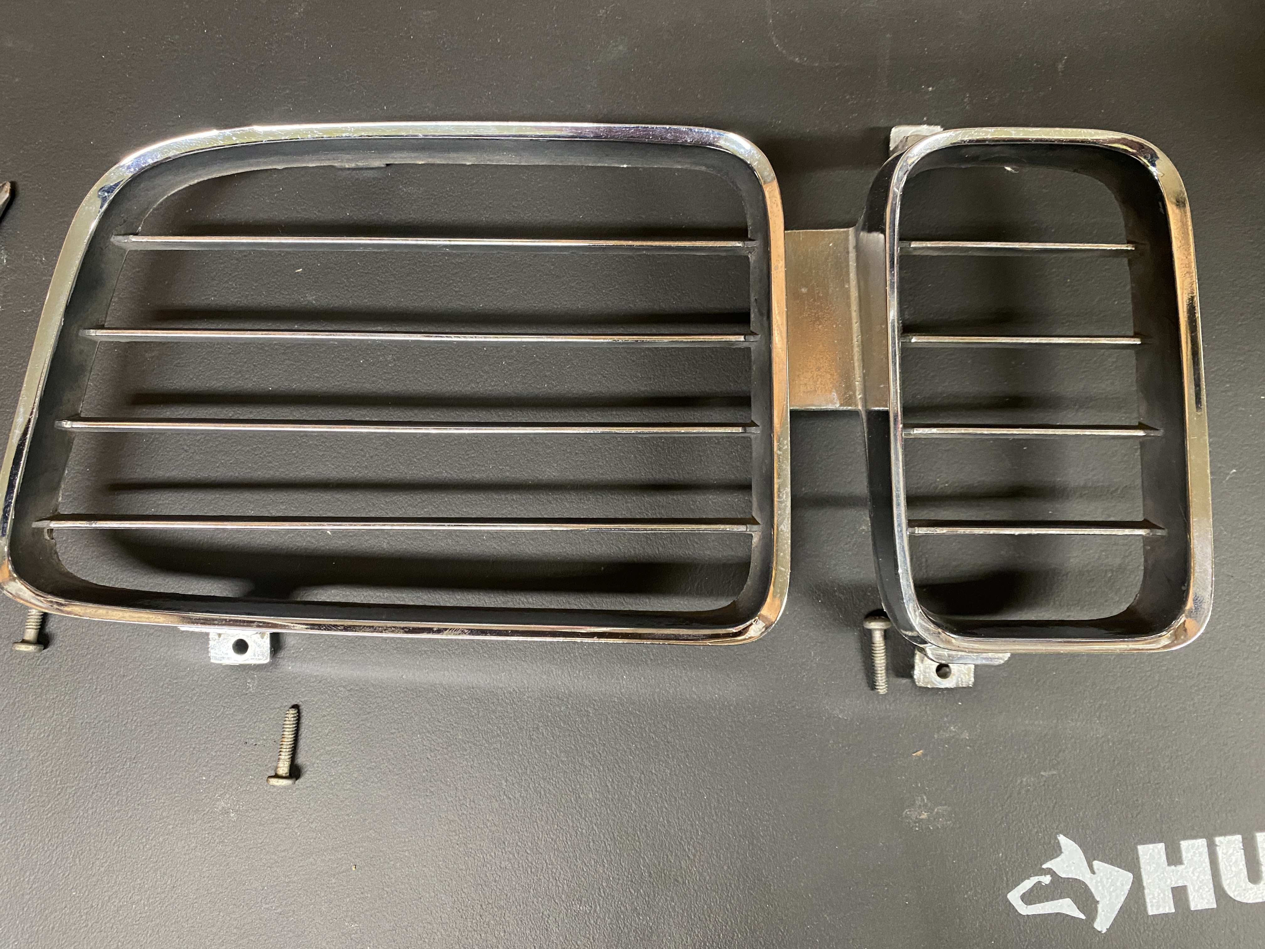

Gotcha, the 1971 Barracuda tail lamp chrome bezel has portions painted black, just as you're observing. As you can see, this piece has some very specific detailing. I'm unsure if this was originally Gloss Black, that has faded with time and sun exposure, or was it a matte or flat black? If it looks flat black, my guess is the paint was originally gloss black and faded, instead of someone repainting at some point using a flat black.
If the chrome is still in good shape, repainting is simple. Clean up and degrease the part, mask all but the inner fin areas, spray 3-4 coats of new black, then before the paint is completely dry, remove the tape and use a razor blade to clean off the outside edges to expose the chrome on those painted fins.

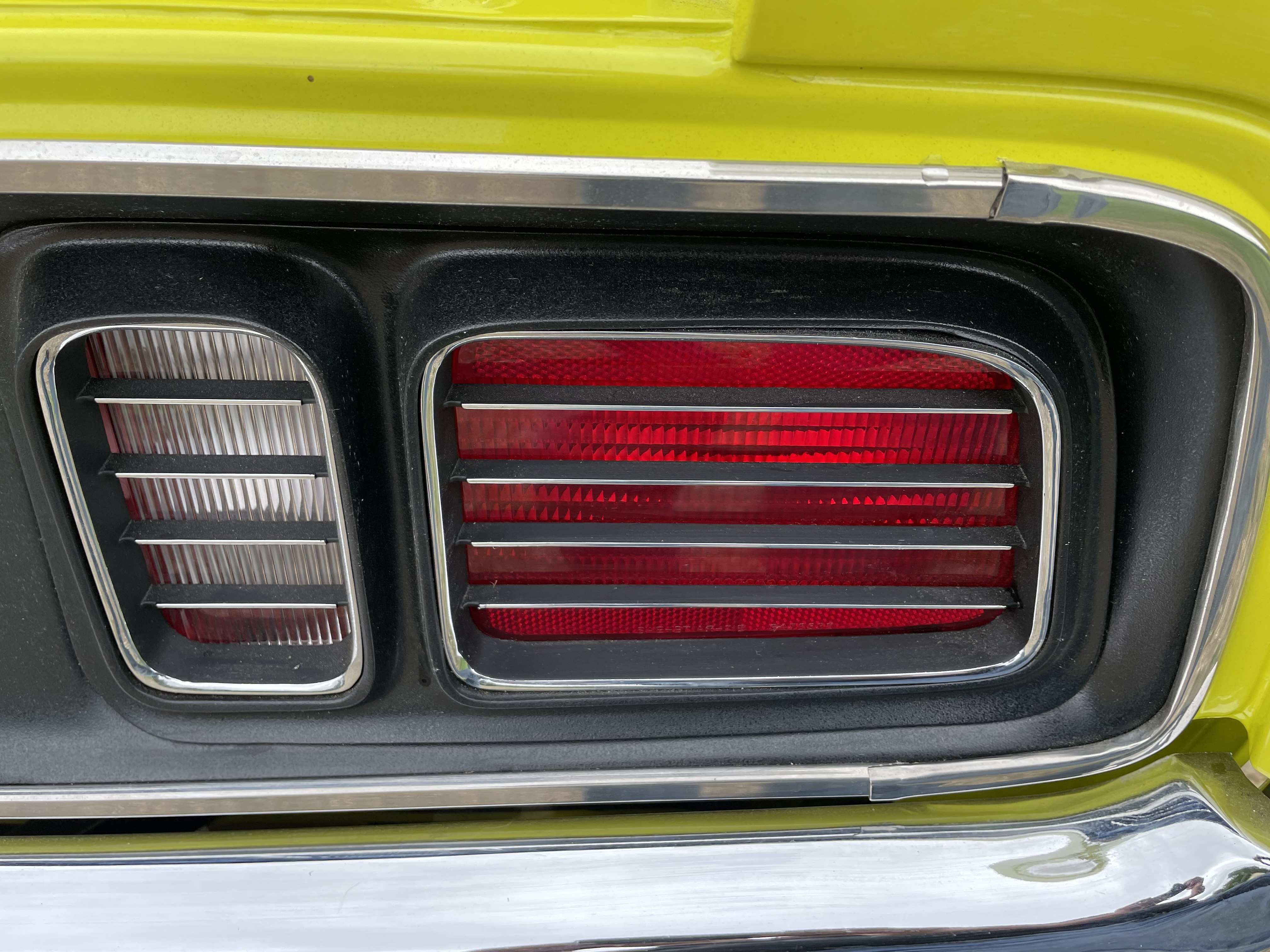

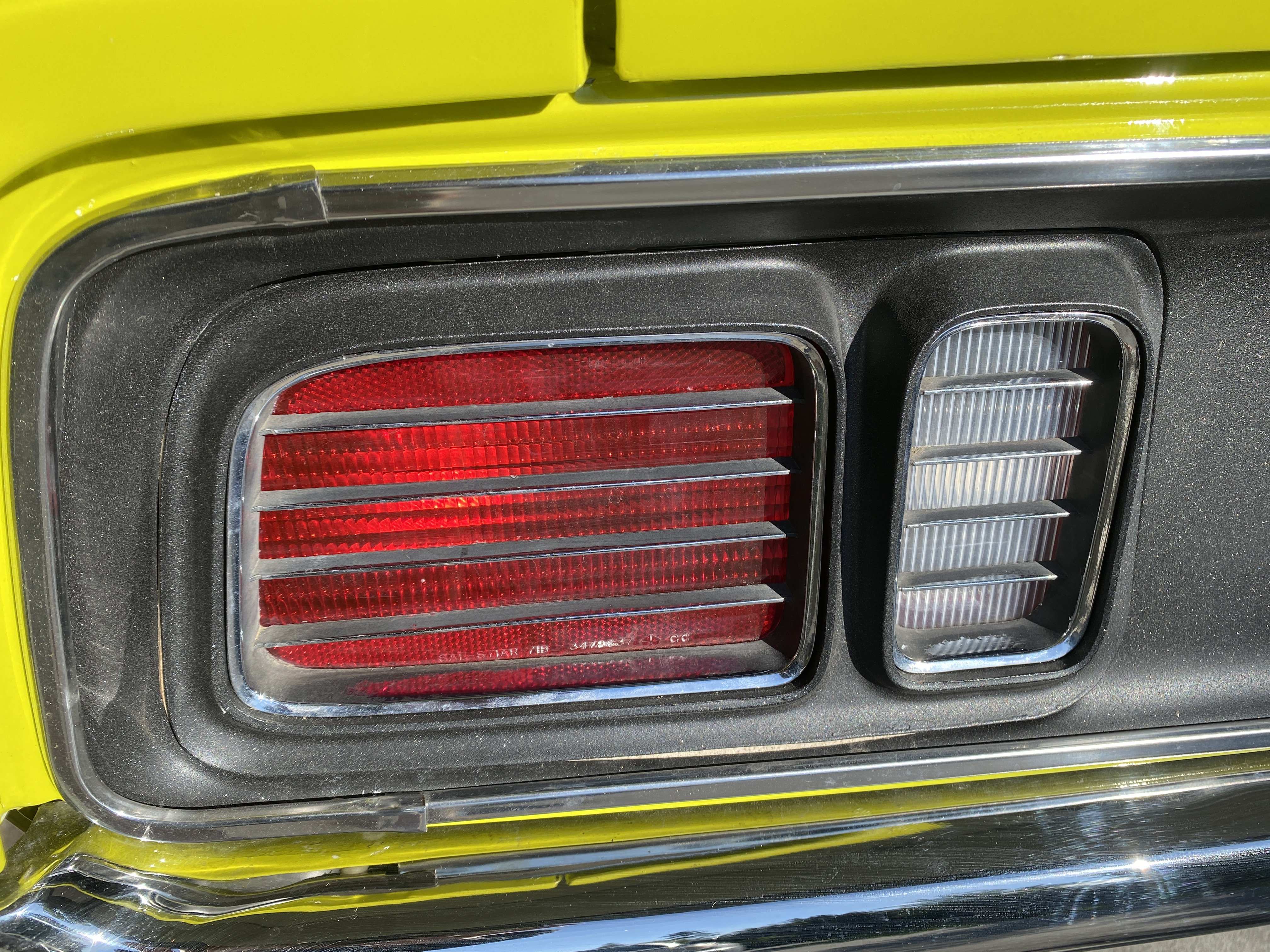

And if fully restored, then they won't match the tail panel?
If you're looking to blacken some worn paint, and the chrome beneath is glaring at you, I might be tempted to do a partial restore, by simply painting the worn chrome areas a black to match the faded black in the other parts.
Knowing at some time later, you may repaint the bezels with the correct ardent silver paint, when repainting the entire tail panel so everything matches.
