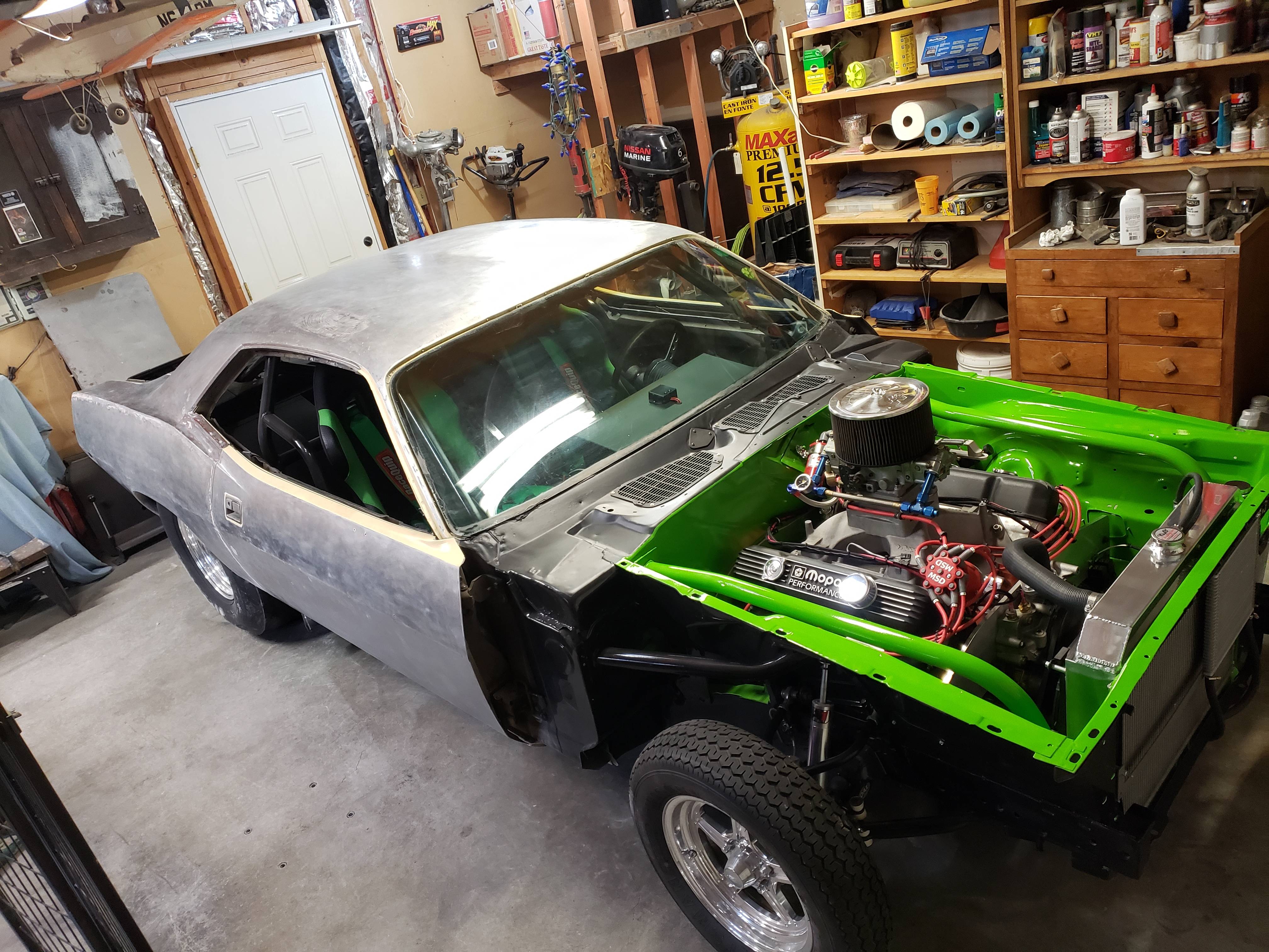

Its been a while. Thought I'd update the progress. Played with the car this summer with some local 1/8th mile drags and only one local car show to attend, but we got our first trophy with only half a car there. Shows the power of a MOPAR!! Back to work through the cold months.😁

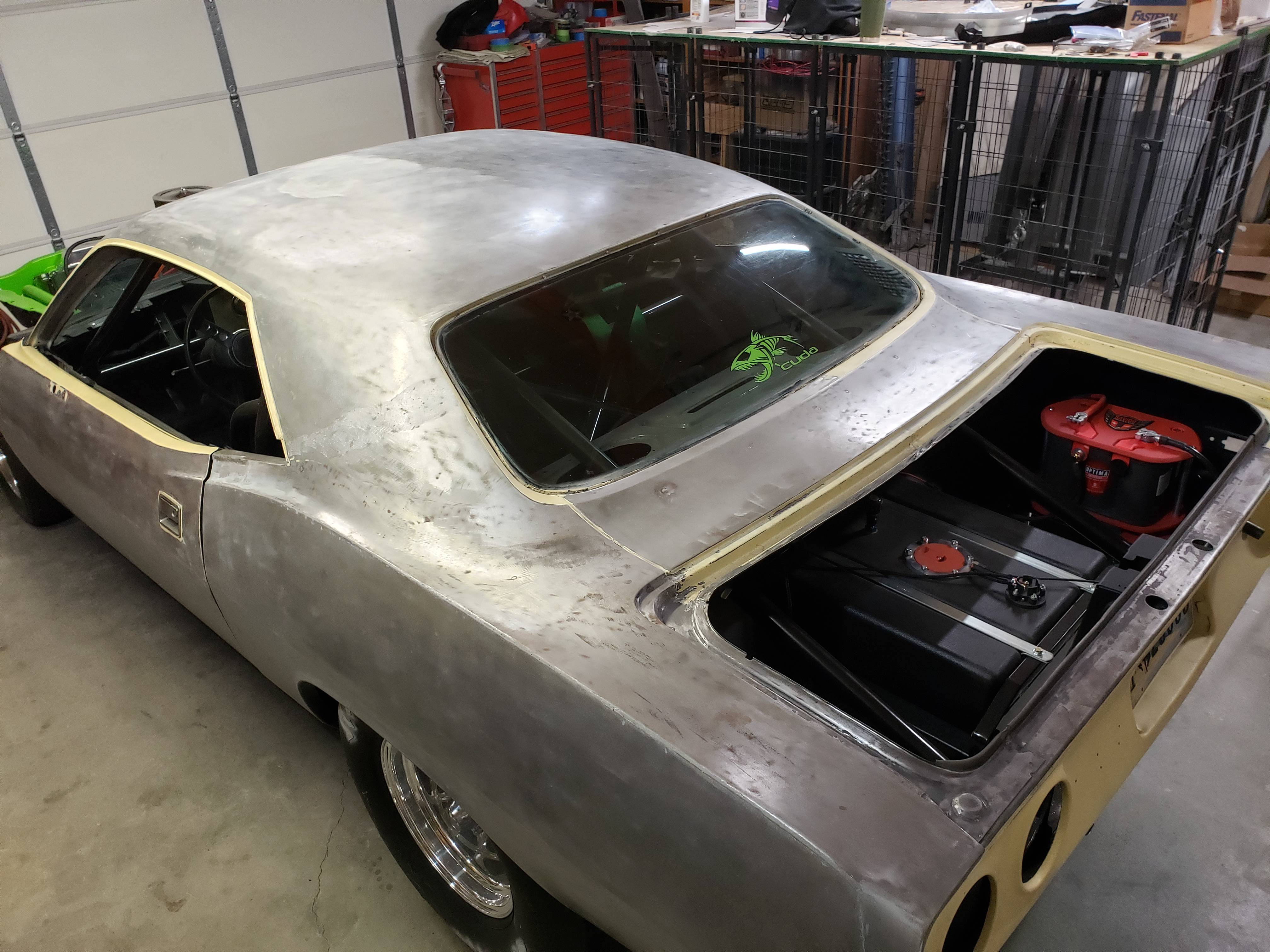

What gauge wire did you run from the battery to the front?
We ran #1 gauge to a bulkhead pass through in the firewall and reduced it to 2 gauge from there to the mini starter. The car starts great.

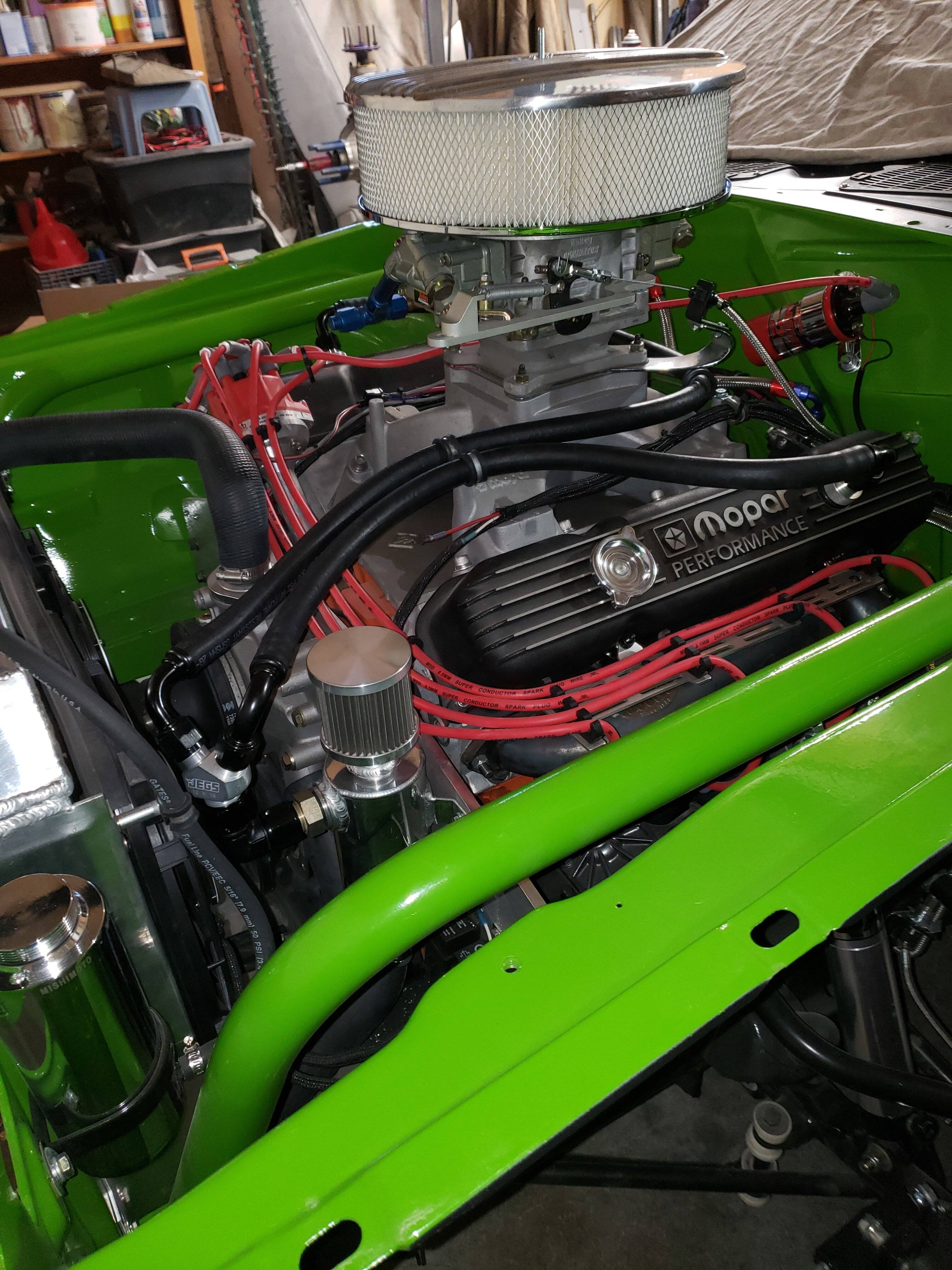

Got a new crankcase vent system installed today.
