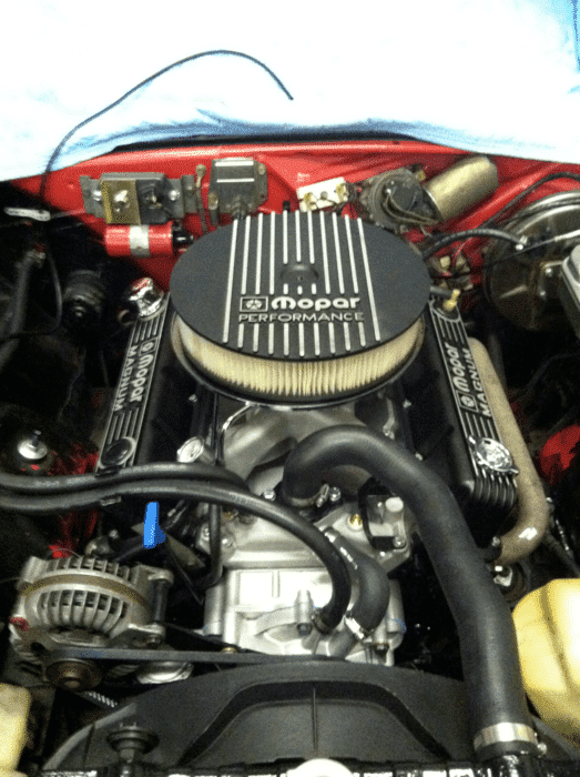

Can anyone help me understand why there is a ballast resister on my 73 Cuda which has factory electronic ignition? I've always been under the assumption that a ballast resister was used to reduce the current to the points which helped to keep them from burning.

I have read that it is there to protect the coil and ECM even when running the electronic ignition. I believe the newer coils have the resistor inside in order to eliminate the firewall resistor. I'm still running mine regardless of the newer coil/ECM. Maybe someone could elaborate further.

The resistor is to reduce the voltage to the coil. The coil runs at roughly 8-9 volts. If you run it at battery voltage it will burn out and leave you stranded. The resistor allows battery voltage to the coil for starting only that's what the extra wires are for.
